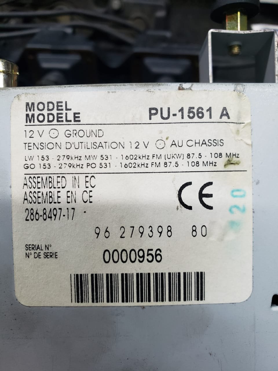

Hello my friends
I´m having a little problem here. Heres the pictures
Here´s the locked radio.
Press the "BND" buttom to unlock it
New line appears instead the "CODE IN" expected.
What´s going on? Anyone?
here´s my equipment info
Thank you

Have a look at this post in this thread:
memberlist.php?mode=viewprofile&u=2763
The more you enter the wrong code, the longer the delay is before the CODE IN appears. Leave it connected to a separate car battery for up to 30 hours or so until the CODE IN appears.

The issue is that either too many attempts have been made Chris and this has extended the wait time again and again before code re-entry will show, - so double dash lines are showing - so no further code input is possible until the allotted time has elapsed. Every time the system is powered off it starts counting down from next power up - hence why others have kept the radio 'live' to allow the hours needed to lapse before the 'CODE IN' is displayed again.

GiveMeABreak wrote: 22 Jun 2021, 18:17 The issue is that either too many attempts have been made Chris and this has extended the wait time again and again before code re-entry will show, - so double dash lines are showing - so no further code input is possible until the allotted time has elapsed. Every time the system is powered off it starts counting down from next power up - hence why others have kept the radio 'live' to allow the hours needed to lapse before the 'CODE IN' is displayed again.
Exactly... i cannot input any code because i receive the double dash line when i press BND for 5seconds
So i have to wait i-dont-know-how-much-time to be able to input the correct code again
22 hours and counting... no result yet
