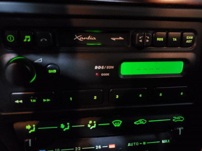

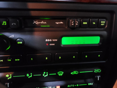

Hello my friends

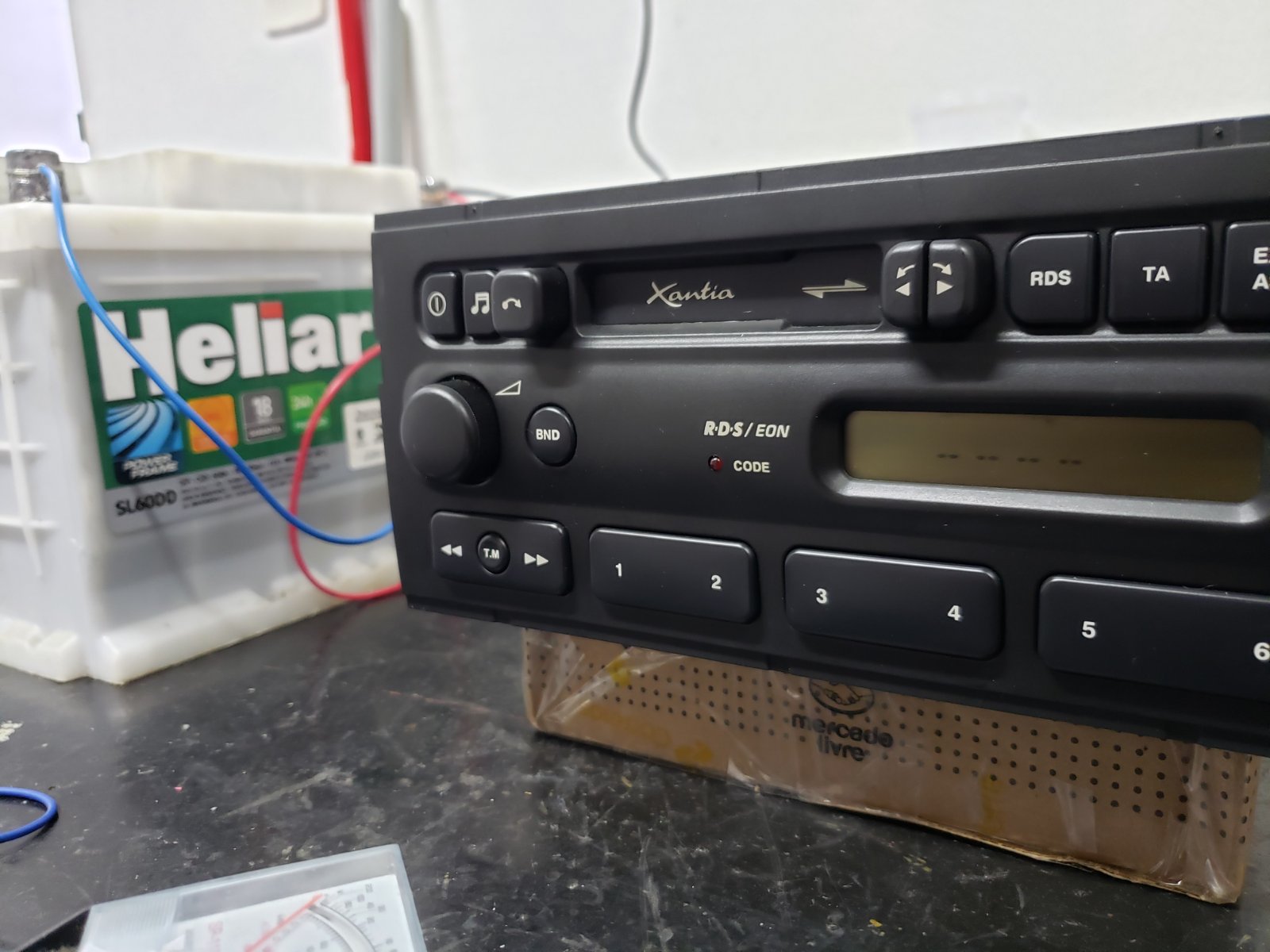

I´m having a little problem here. Heres the pictures
Here´s the locked radio.
Press the "BND" buttom to unlock it
New line appears instead the "CODE IN" expected.
What´s going on? Anyone?
here´s my equipment info
Thank you
Thank you

Re: Xantia Locked Radio (PU-1561A)?? Need help
Have a look at this post in this thread:
memberlist.php?mode=viewprofile&u=2763
The more you enter the wrong code, the longer the delay is before the CODE IN appears. Leave it connected to a separate car battery for up to 30 hours or so until the CODE IN appears.

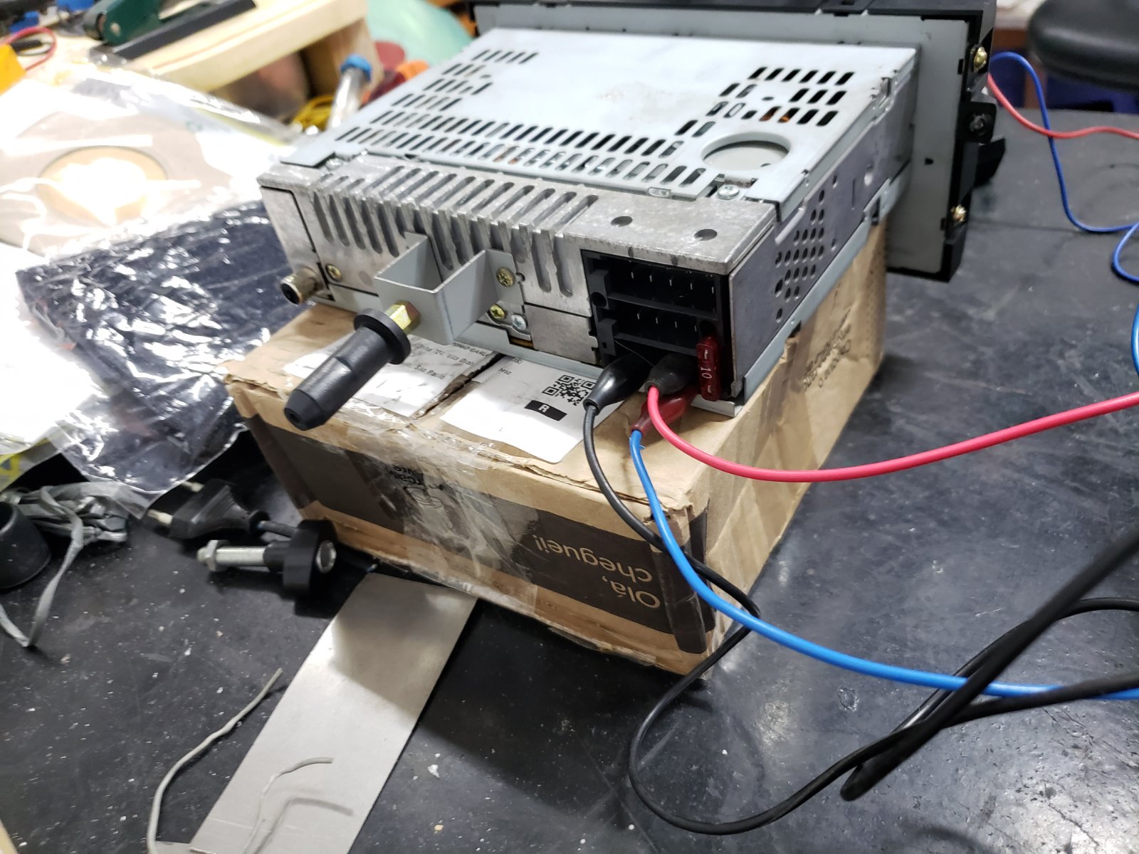

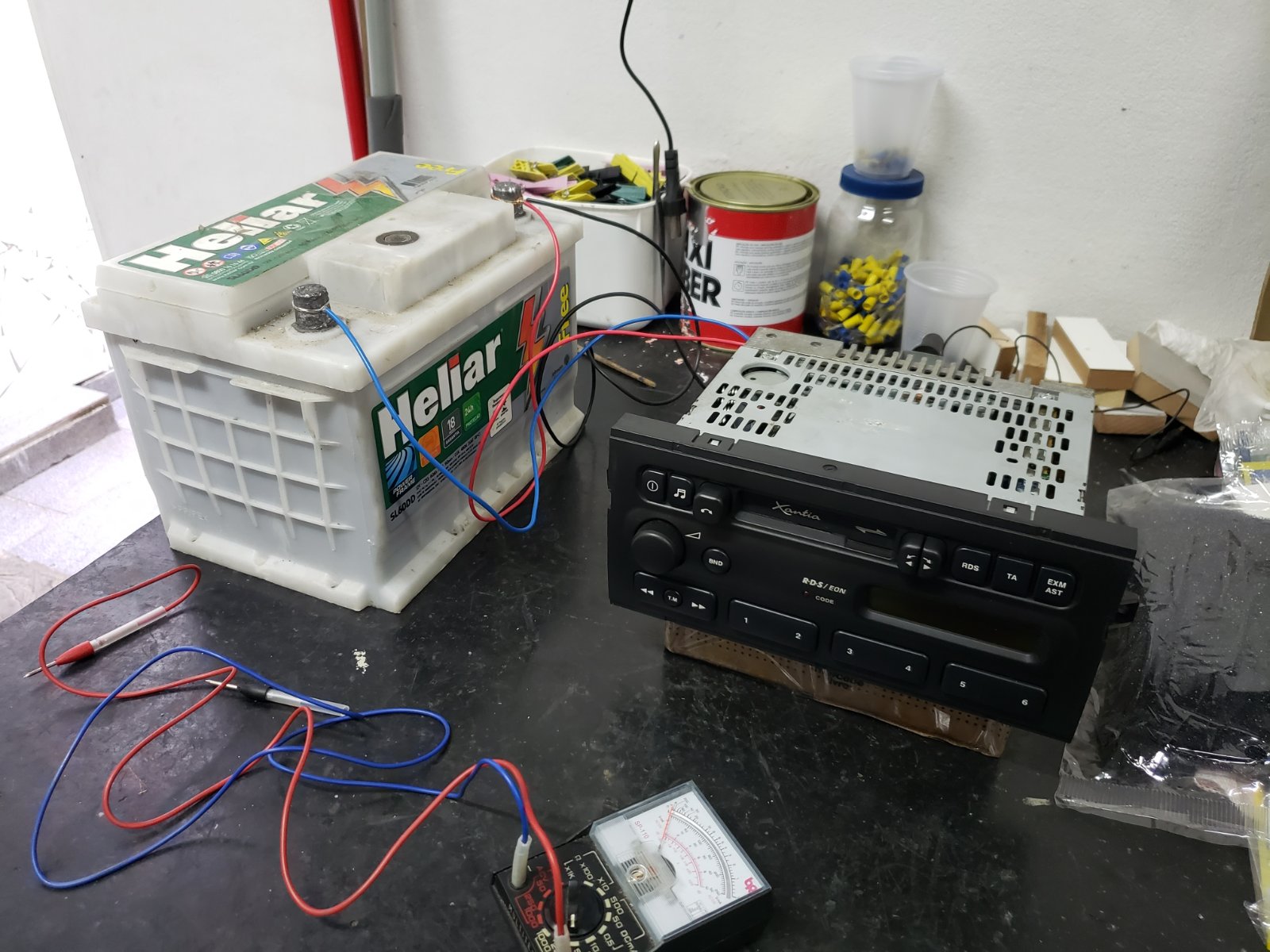

Hi! Thanks! So i will have to use a battery to keep it ON on my work benchGiveMeABreak wrote: 21 Jun 2021, 10:04 Have a look at this post in this thread:

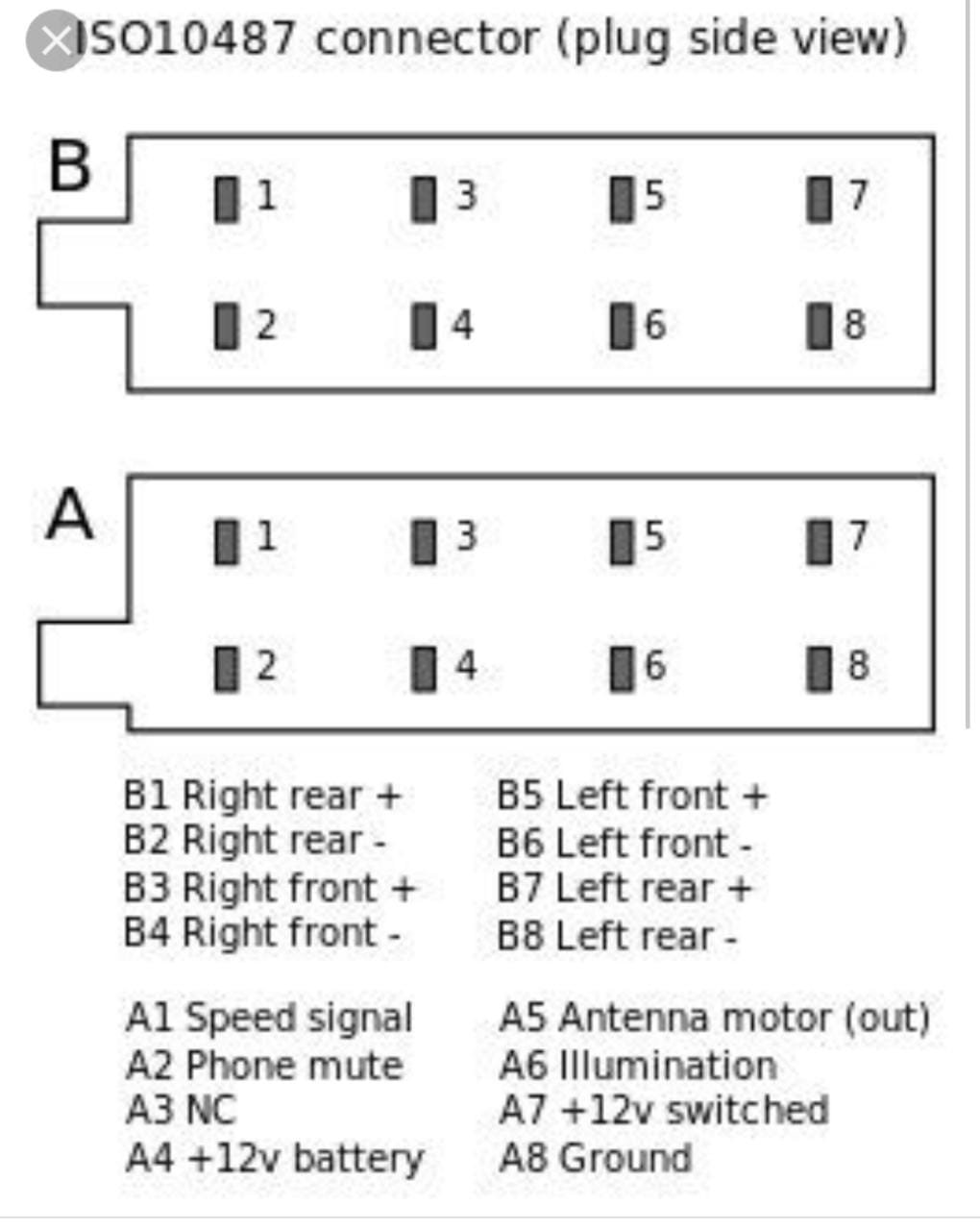

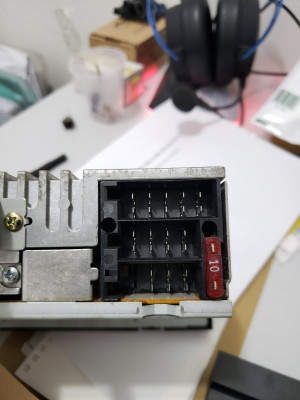

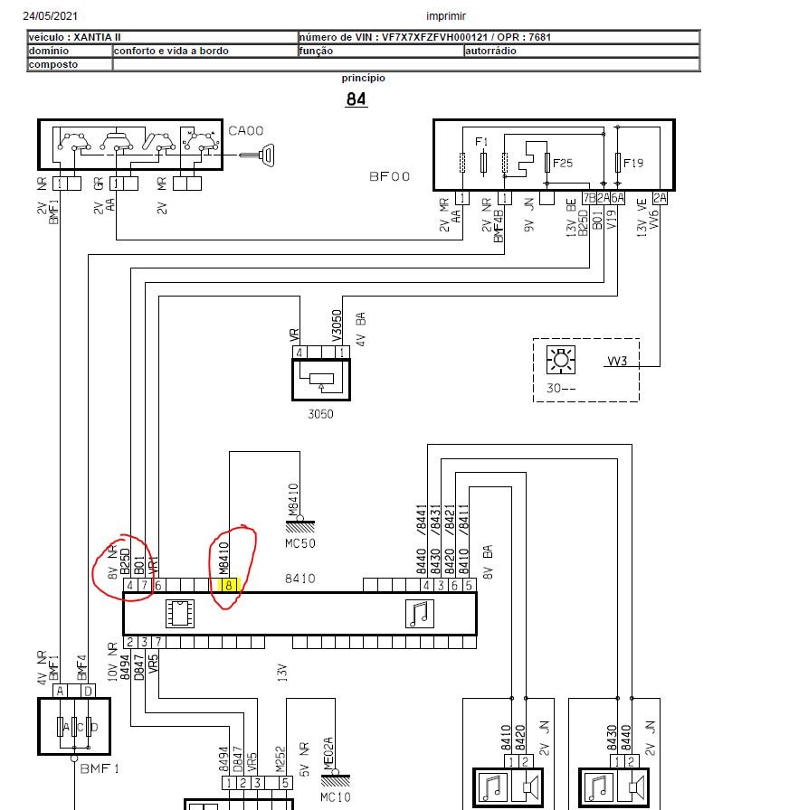

Can you please help with the rear radio pinout?
What pins should i connect to battery? earth, memory and ign terminals? Can you help with that too?
Thank you veri much!
Regards
Xantia Ph 2 Activa V6 - 7681CJ / VH000121
- x 6956
I think Pin 4 and 7 are live and 8 is the earth on the 8 pin black connector socket.

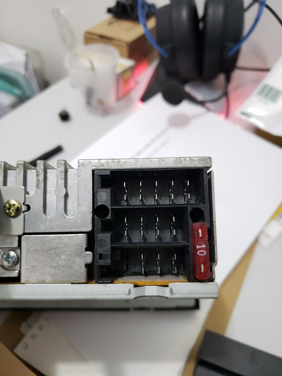

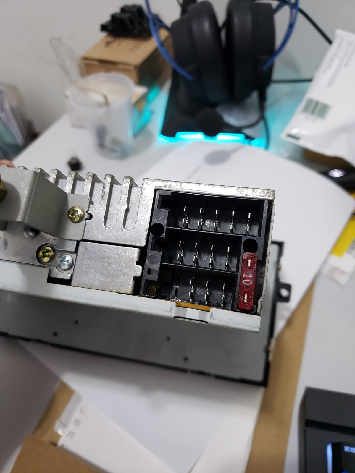

Can you help me to find? The pins have no number to help.GiveMeABreak wrote: 21 Jun 2021, 14:24 I think Pin 4 and 7 are live and 8 is the earth on the 8 pin black connector socket.
Pinout solved!
AKA Iso Connector btw
I left the radio on on the bench. Let's see how long it takes to unlock itself.

- x 6956
The issue is that either too many attempts have been made Chris and this has extended the wait time again and again before code re-entry will show, - so double dash lines are showing - so no further code input is possible until the allotted time has elapsed. Every time the system is powered off it starts counting down from next power up - hence why others have kept the radio 'live' to allow the hours needed to lapse before the 'CODE IN' is displayed again.
Exactly... i cannot input any code because i receive the double dash line when i press BND for 5secondsGiveMeABreak wrote: 22 Jun 2021, 18:17 The issue is that either too many attempts have been made Chris and this has extended the wait time again and again before code re-entry will show, - so double dash lines are showing - so no further code input is possible until the allotted time has elapsed. Every time the system is powered off it starts counting down from next power up - hence why others have kept the radio 'live' to allow the hours needed to lapse before the 'CODE IN' is displayed again.
So i have to wait i-dont-know-how-much-time to be able to input the correct code again
22 hours and counting... no result yet
