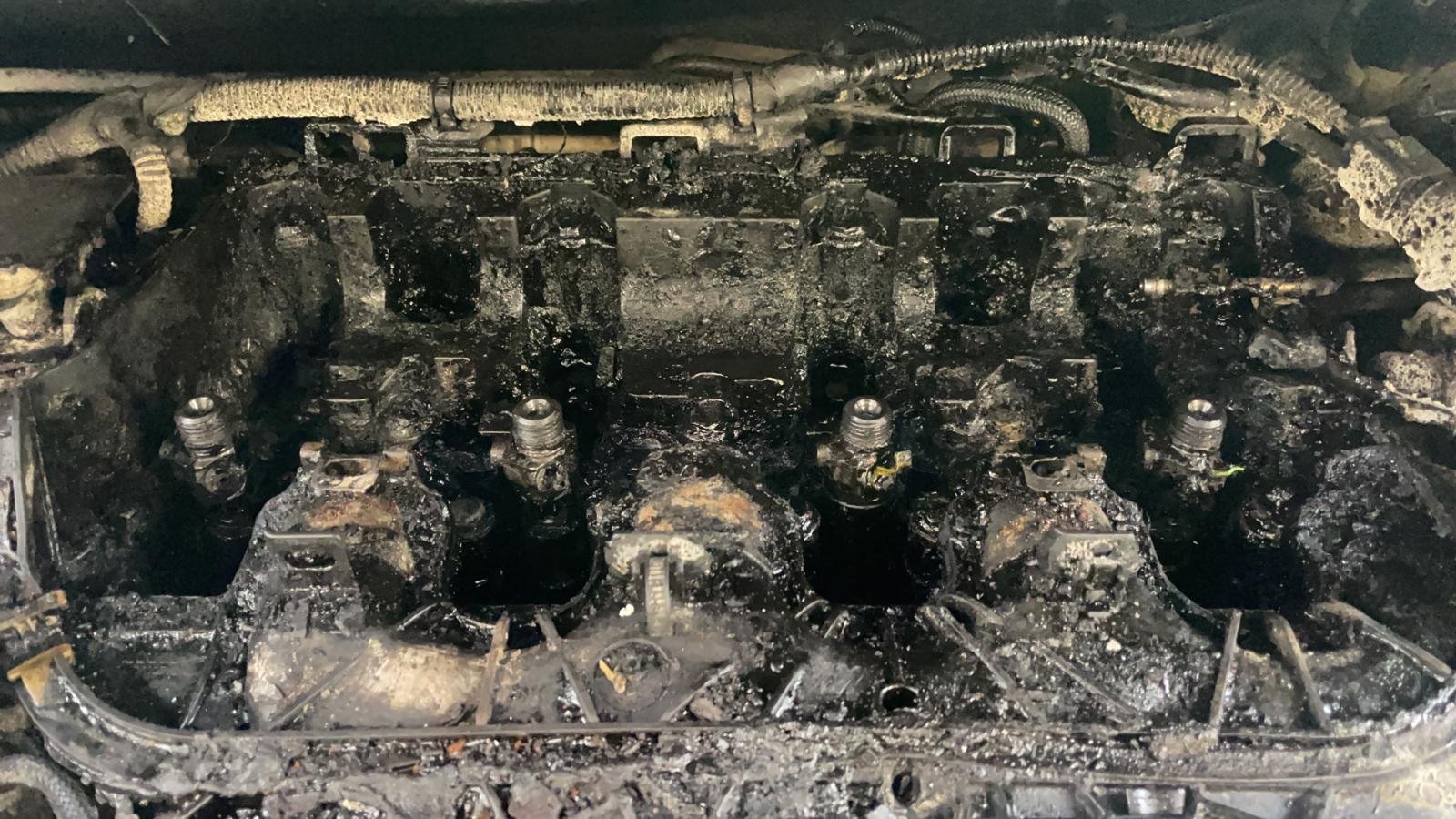

After a few days I get a call from him saying it is a right mess under the cover but it looks like x3 Injector clams have failed and there is a 5 to 7 day delivery time on them he is also ordering wiring looms as they are brittle from the tar (Carbon) etc
Monday or Tuesday the following week (I had to borrow the work car to get home) he advised me the injectors was being a pain to get out so he was removing the rocker cover to help remove without damaging them

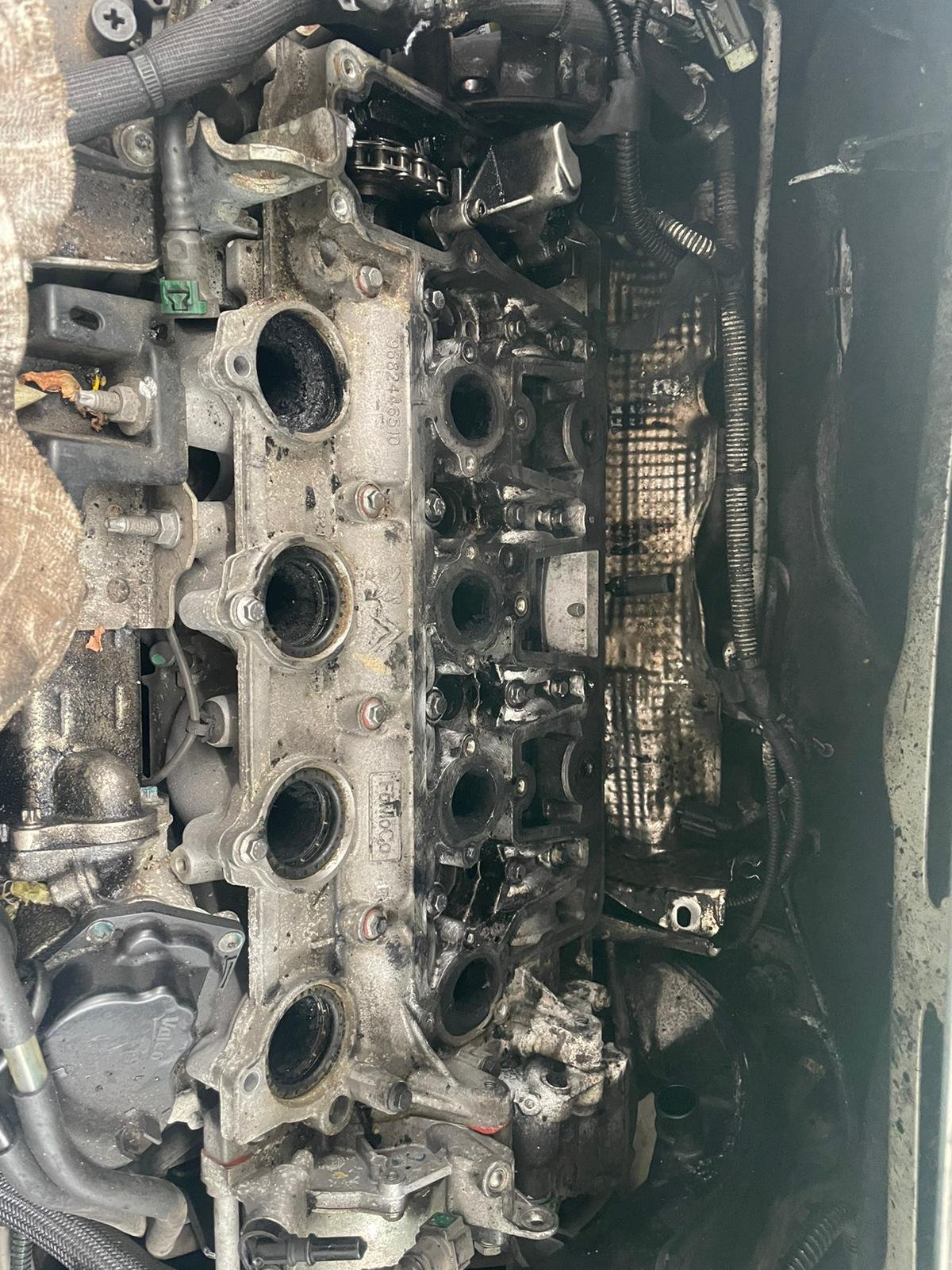

I am hoping you guys can help me with this I have already send the car back to him he just keeps saying the car now needs a carbon clean (trying to get more money out of me more like) and also says when he picks it up it runs fine how ever when I run it EML on (Unless i clear it) and it is gutless after 4th gear
I have attached a few pics he sent me during the work maybe your trained eyes can stop something that is out of place

Crikey - what's he done? That last picture looks like the aftermath of a torch job!
- Posts: 2
- Joined: 19 Jun 2021, 19:25
- Location: Derbyshire
- My Cars: Current Car :- Peugeot 5008 2010
Re: Peugeot 5008 code problems
3 injector clamps wiring loom seals etcGiveMeABreak wrote: ↑19 Jun 2021, 23:53 Crikey - what's he done? That last picture looks like the aftermath of a torch job!
That pic you are on about was the before shot
