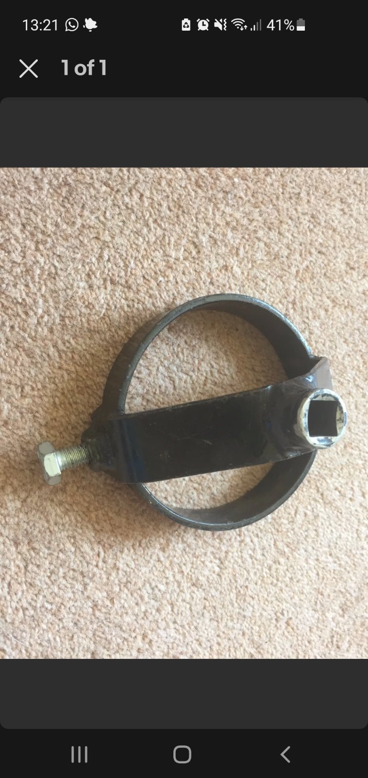

someone selling this. does it look like it would be good enough

That tool looks a good one; might be worth getting it anyway.

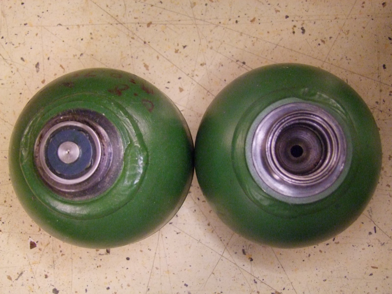

A few QQ:
- is the replacement Acc sphere the correct one (no damper, just a 6mm hole) and gassed up ok (62bar)?
- after fitting it, did you leave the 12mm depressurising bolt slackened for a while, while the pump returned fluid to the reservoir?
- did you bleed the hydraulic system at the 4 brake calipers (RR, RL, FR, FL) ?
- is the fluid level ok (and the level indicator not stuck)?
Reason for asking is that the jangling could be air in the system.

. Left: sphere with damper insert (corners/wheels)
Right: without insert, eg Accumulator or Hydractive centre sphere
