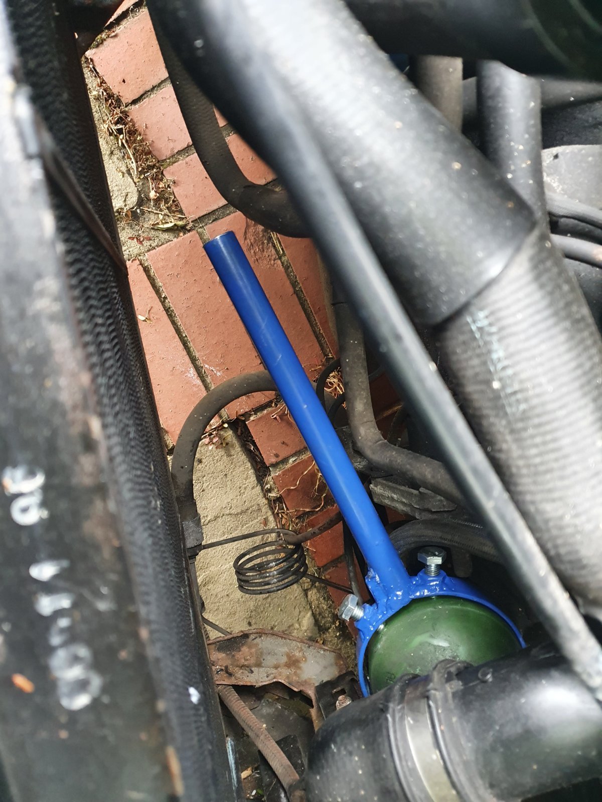

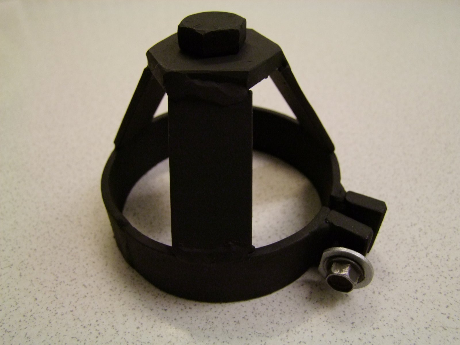

Access to that sphere is cramped, and instead of the long-handle tool, I put together one of these, nicknamed The Iron Maiden... It allows a socket to be used from the top, where there's not much space round the sides.
If you can't do something like this, you might have success with a chain wrench (or strap wrench) with a longish extension going upwards - similar to using strap/chain to get an oil filter off.
A couple of clonks with a hammer can help loosen a stubborn sphere, or digging in with a cold chisel + hammer can do it.

Hi Chris. that looks good. Sadly beyond my fabrication skills though. I will see if I can get hold of a suitable oil filter chain wrench see if that works. thanks

someone selling this. does it look like it would be good enough

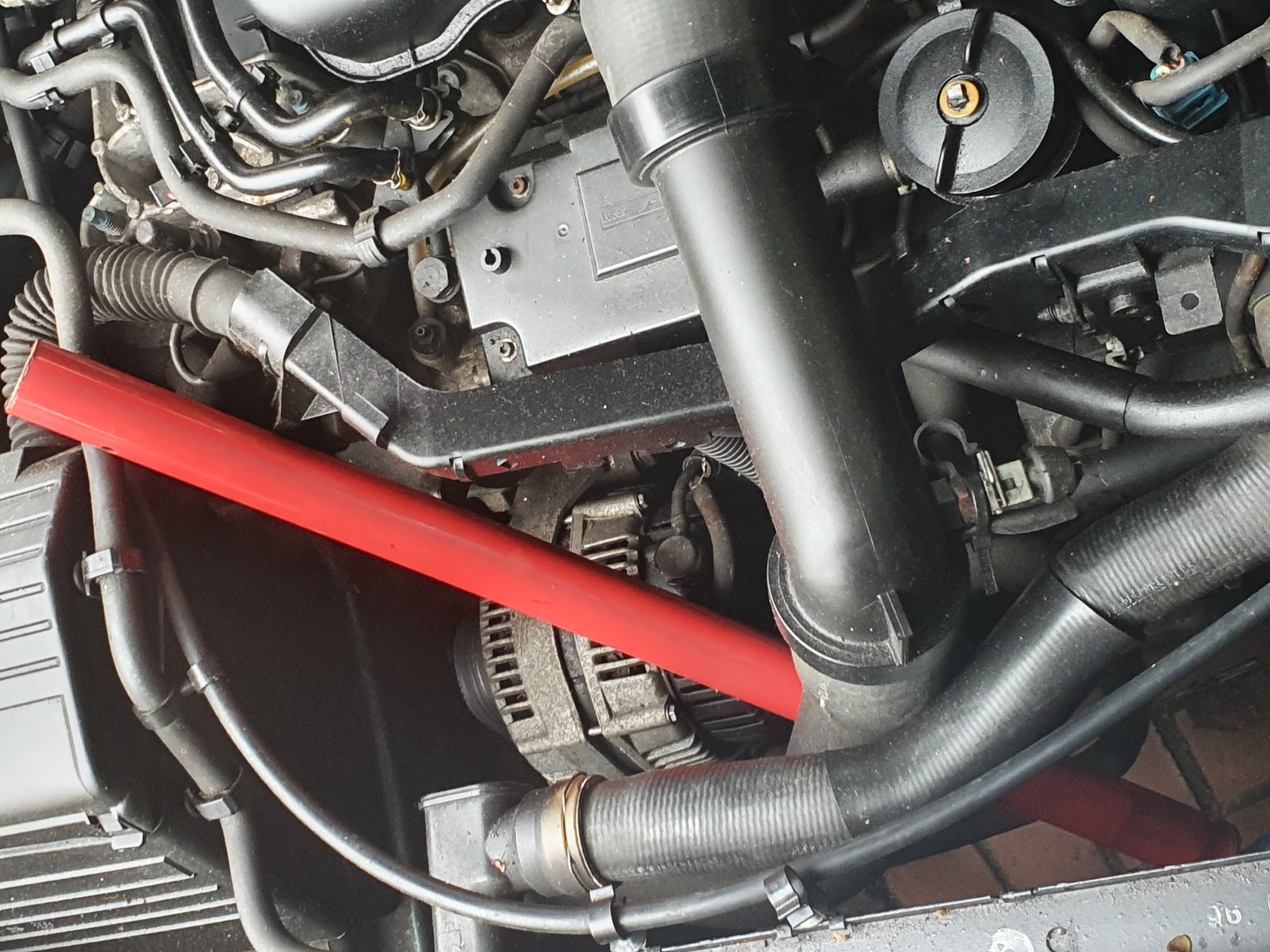

managed to get it loose. Got a jack handle down through all the pipes and hoses at the right angle to hit it with hammer onto the sphere wrenche, got it shocked loose mm from impaling the handle into the radiator

Well done, you.
One of the few cases where a hefty clonk is actually recommended!
That tool looks a good one; might be worth getting it anyway.
