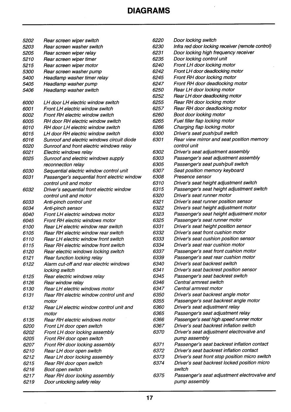

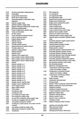

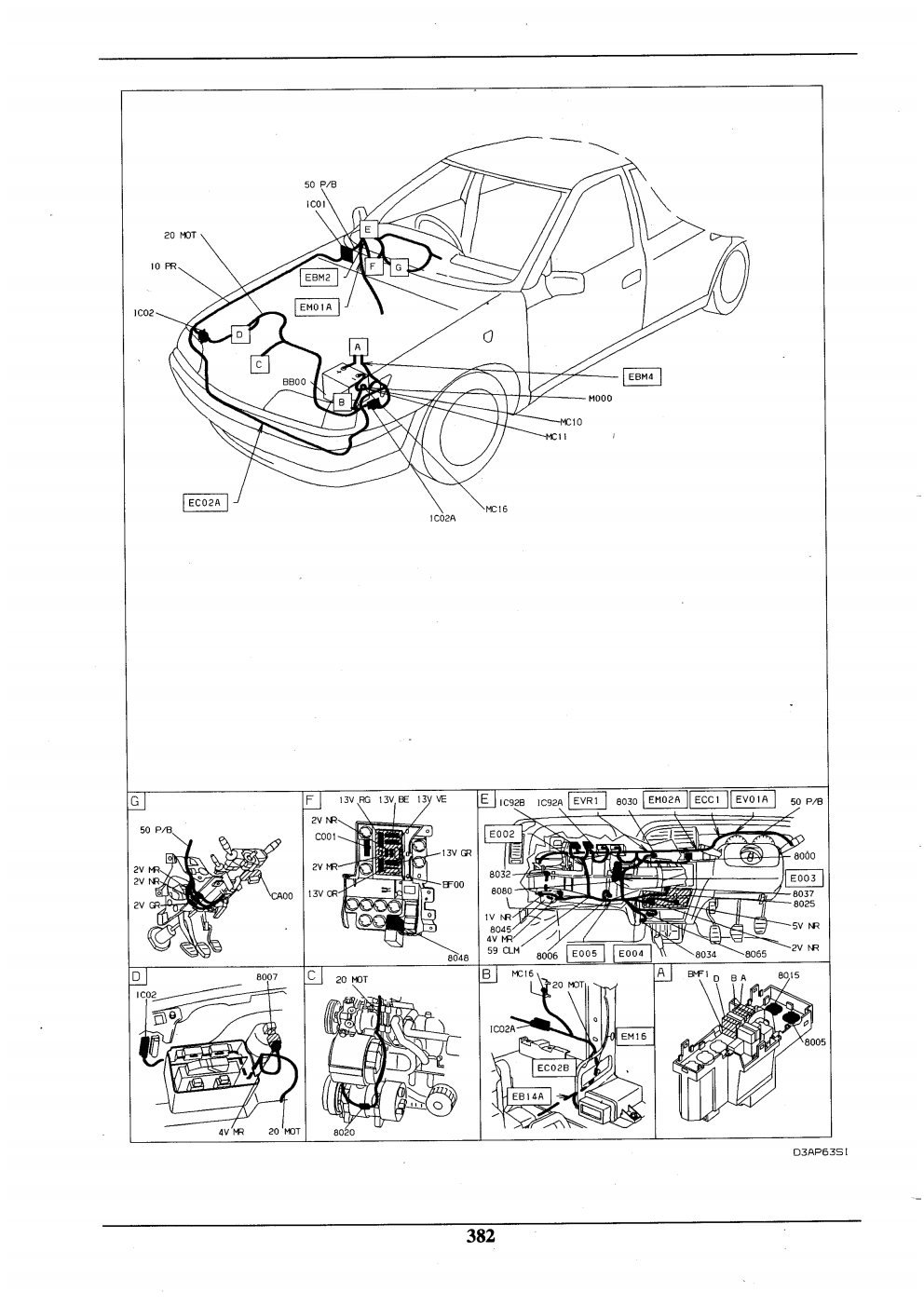

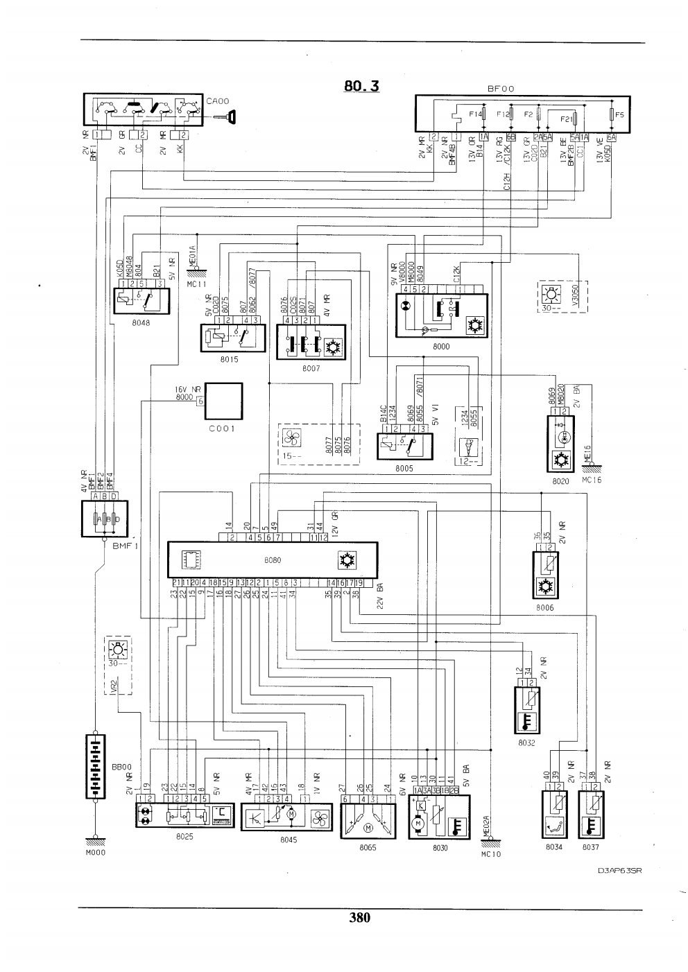

I think that these may be the applicable diagrams, they are certainly S2 Xantia with the factory-fitted blower relay. The relay is located with the relays near the fuse box under the dash board (8048 in these diagrams).

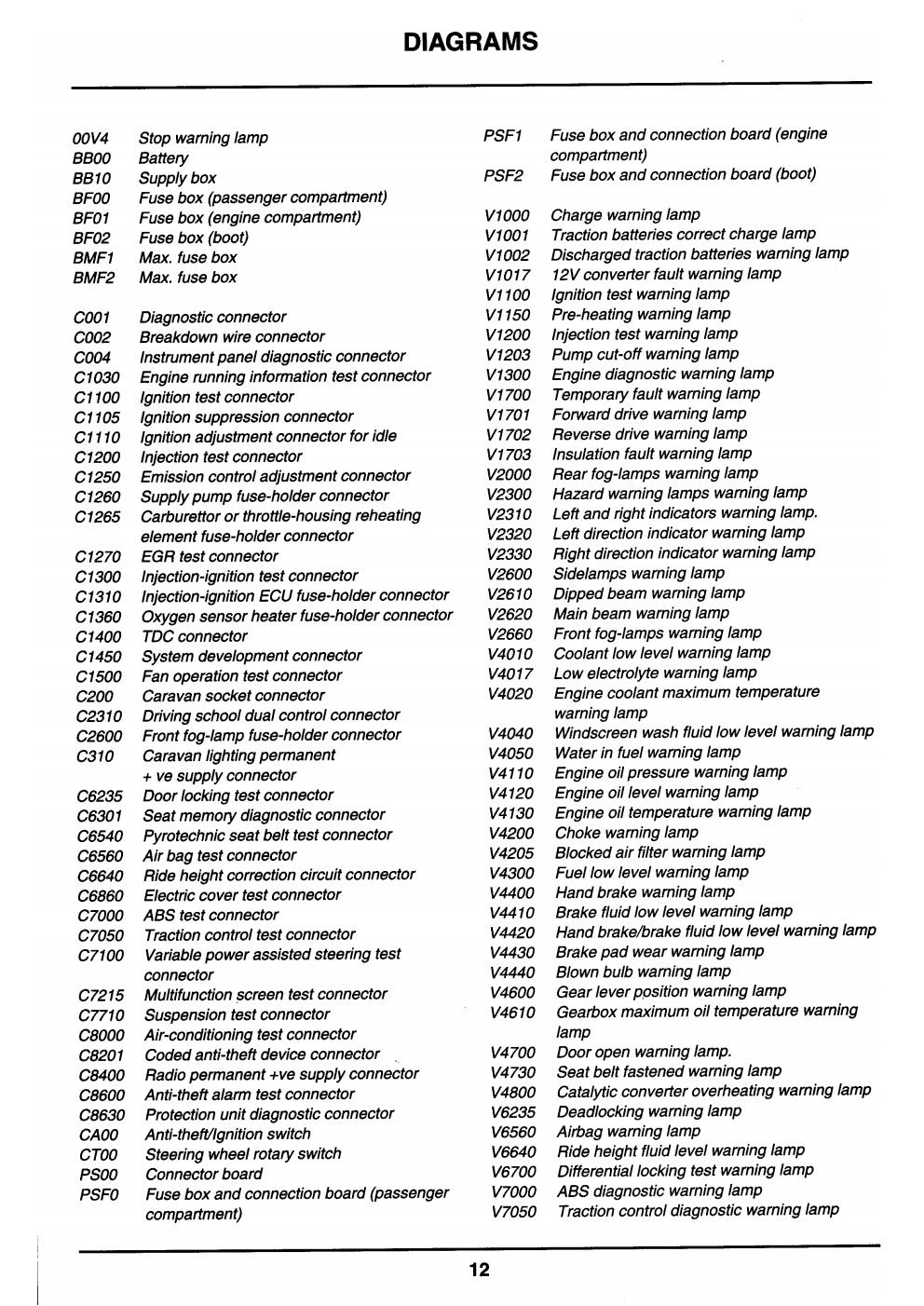

Component Codes (full list):

Chris, can you confirm that you have no later diagram? There were dashboard wiring changes very late in production.
Mike, these are the latest I have here (RP7438 onwards, = 21.3.97) . . .
? click to enlarge
? click to enlarge

Check the motor is ok (direct wire to 12v)
Relay on the control board comes in for Full Speed only.
Bench test the module (see below).
