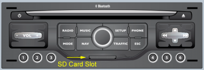

Ok so are you 100% sure you have the MyWay and not the RT6 eMyWay?
They look the same except that the MyWay has an SD Card slot on the front bottom middle of the unit see below.
The reason I ask is that the condition you describe is generally associated with the eMyWay after a major firmware update, that requires a dealer visit to reconfigure the unit. Until this has been done, the unit will be missing that menu I described. This will be the first time ever I have heard of this happening on a MyWay RNEG though.

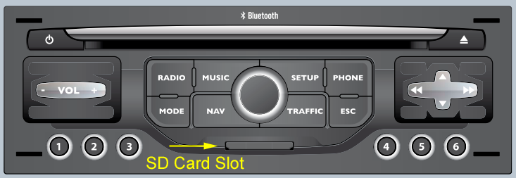

I really need help. My Rneg, like this on picture, have problem with reseting. Every time when reset it lose clock and date. That happend in drive every time, my battery is new. I want if anyone have firmware update link, i will be very thankful.
- GiveMeABreak
- Posts: 37014
- Location: West Wales
C5 MK I 2.0 HDi SX Wicked Red
C15 Romahome White
XM 2.0 SX Polar White
CX 20 Polar White
GS 1220 Geranium Red
GS 1000 Cedreat Yellow - x 5648
Re: Rneg firnware
What is your existing version?
If the unit is resetting, be aware that the flash memory may be failing.
