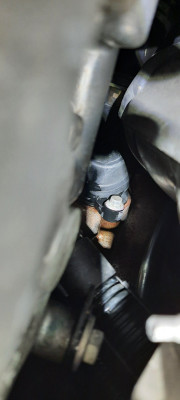

I have found the leak and it is in a very hard to access position . I will try and attach photos and the rough sketch I did .
It appears to be leaking from a black plastic housing position under the front injection manifold and directly behind the yellow handle of dip stick .
The cooling fluid was dripping from the lower mounting screw head , there are two hoses connected , the smaller one leads forward to an aluminium pipe . I think this housing may be located into the cast iron block with a spigot !!!?? this may be where it is leaking . The housing is above the air con compressor ! I don't know what to remove to get at this black housing . It would be unlikely that the screw needs tightening , which would be extremely hard without removing something . Hope you have some ideas please !!

Thanks for this info and help Marc but I think it is really tucked in behind the EGR exchanger . It is black plastic sort of oval shape and I can only see one mounting screw looking up from the ground as shown in the photo . It must have a name which would show in a proper manual !

It sounds like the leak is from the front EGR cooler.

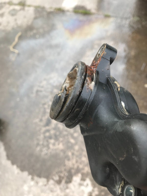

Not sure if the same applies to the 3.0 but I guess it will...
On a 2.7 in the area below the EGR and above the alternator (where you have drawn) is the water inlet manifold.
A common fault on the 2.7 at around 8-10 years old along with the thermostat housing on the top of the engine.
2.7 coolant inlet
2.7 coolant inlet
If you haven't renewed either I would recommend doing both at the same time.
