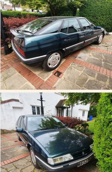

Picked up a 1997 XM 2.1TD last week. Been off the road for 5 or 6 years prior to a bit of light recommissioning last year, but still a few jobs to do before I get to drive it
I have always fancied a Hydropneumatic Citroen but don't have any experience of working on them so I am sure I will have a few questions along the way

Issues so far seem to be a leaking doseur valve seal ,have a new seal but the locator ring is a bit bent out of shape and tore the new seal trying to get it back in!
ABS light on, not investigated yet
Drivers electric window dead
Passenger window makes a noise but doesn't go down
Unknown when cambelt was last changed
chirp from alternator area, suspect belt as its almost worn its Vees off in places
possible LHM leak near the regulator (no puddles but was a tiny bit damp underneath it)
That said I haven't driven it yet so might find something else
Looking like parts supplies might be trickier on this compared to cars I am used to working on
One question I did have on the next job on list (LHM change). What type of clamp do I need for the pipe which goes from tank to pump, as I understand it needs to come off to prime pump but not sure what replacement to buy or if they can be reused
