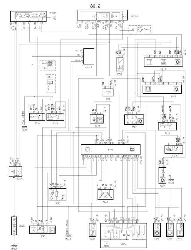

Hi.
Can anyone provide me with, or let me know where I can source correct wiring diagrams for this model?
The Haynes manual and other online diagrams are different to the wiring in my car.

Which particular circuits are you after?
What is your RP number? This should be stencilled onto one of the strut tops on a 97 model.

Hi, on the OS strut there is 7659-FV, I believe the paint code is on the NS strut. I am looking for the blower / aircon diagrams.
many thanks.

Here you go.
Component codes can be found here > https://www.frenchcarforum.co.uk/wiki/E ... ring_Codes

Thankyou very much. This diagram correlates perfectly with my vehicle.
