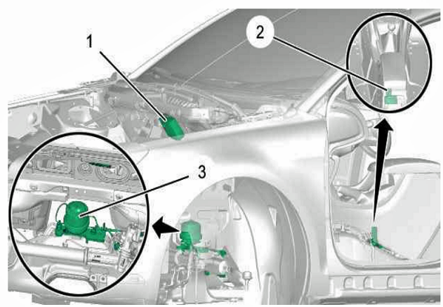

      Ok, so these faults are related to the active engine damping system on this engine. It's function is to minimise the awareness of engine vibration in the passenger compartment by means of an electromagnetic actuator. It is connected to the Auto Gearbox ECU, the ESP system and the BSI via the CAN network to obtain information on vehicle speed and conditions.
      The force generated by the actuator is controlled in relation to the frequency, amplitude and phase
      The active damper status as to whether it is active or not can be determined using Diagbox by checking on the ECU and confirming it's status.
      (1) Active damper electronic unit.
      (2) Vehicle vibration accelerometer.
      (3) Active damper.
      First thing I would do is check the connections between the damper itself and the damper ECU. It is a single wiring plug and may have become damaged / split causing a short.

      ozzdownunder wrote: 30 Apr 2021, 06:27 ... What is the function of the AD sensor?
      There is a brief summary below, but he AD sensor is the Vehicle Vibration Accelerometer which detects the vehicle vibrations
      There are 3 main parts to the Active Damper as fitted to the DW12C engine specifically.
      (3) Active damper.
      It's overall function is to reduce the engine vibration felt in the passenger compartment.
      It uses an electromagnetic actuator, The force generated is controlled in relation to the frequency, amplitude and phase.
      The active damper function is provided by an ECU referred to as the active damper electronic unit which processes the information supplied by the vehicle vibration sensor and the engine management, built-in systems interface, automatic gearbox and ESP ECUs and directly controls the power of the active damper.
