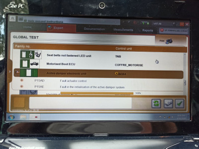

I am looking for someone who could help me to understand two faults I have on my C5 (X7), 2011, 2.2 HDi, 200 Hp.
Active damper electronic unit:
    P15AD
      P15AE
      Thank you!

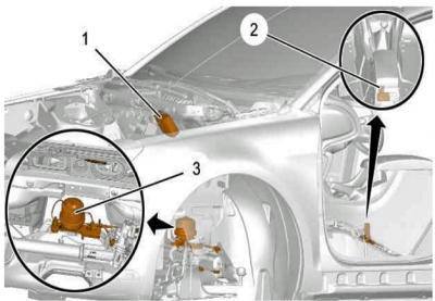

      The force generated by the actuator is controlled in relation to the frequency, amplitude and phase
      The active damper status as to whether it is active or not can be determined using Diagbox by checking on the ECU and confirming it's status.

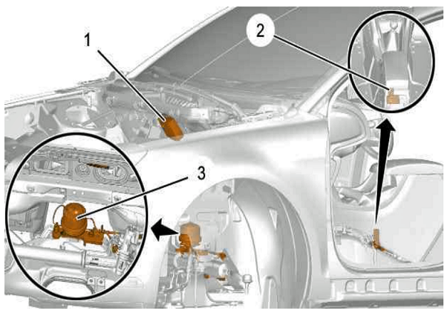

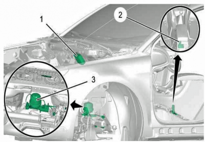

      (1) Active damper electronic unit.
      (2) Vehicle vibration accelerometer.
      (3) Active damper.
      First thing I would do is check the connections between the damper itself and the damper ECU. It is a single wiring plug and may have become damaged / split causing a short.
      Fault code: P15ADActuator control fault: Open circuit, meaning the actuator control is in open circuit.
      Conditions for fault: At least one of the following conditions must be fulfilled:
      - During an initialising of the active damper ECU
      - During an actuator test on the active damper ECU
      Conditions of disappearance of the fault: The following conditions have to be met:
      - No faults for 150 ms
      - The actuator control is correct
      Down-grade modes when the fault is present: Operation of the active damper deactivated.
      Symptoms: Noise, Vibration
      Suspect areas: Connectors, Electrical harness, Active damper ECU
      Fault code P15AE Fault in the initialisation of the active damper system: Not characterised. There are several possibilities for this fault:
      Possibility 1: The automatic initialisation has failed
      Possibility 2: The manual initialisation has failed
      Possibility 3: Initialisation could not be performed
      Conditions of Fault: Engine running
      Conditions of disappearance of the fault: At least one of the following conditions must be fulfilled
      - The manual initialisation has been done successfully
      - The first initialisation has been done successfully
      Down-grade modes if fault present:
      Possibility 1: The operating is active using the default values if the first initialisation (at the factory) has not been done.
      Possibility 2: The operating is still active with the last valid value if the automatic initialisation has failed.
      Possibility 3: The operating of the damper is deactivated.
      Symptoms: Noise, Vibration.
      Suspect areas: Active damper ECU, Mass damper.

      There is a brief summary below, but he AD sensor is the Vehicle Vibration Accelerometer which detects the vehicle vibrations

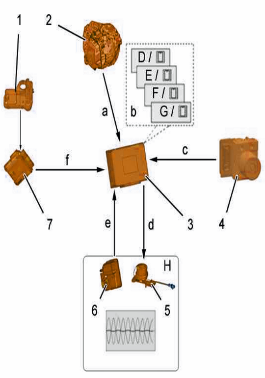

      There are 3 main parts to the Active Damper as fitted to the DW12C engine specifically.
      (3) Active damper.

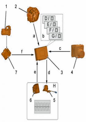

      It's overall function is to reduce the engine vibration felt in the passenger compartment.
      It uses an electromagnetic actuator, The force generated is controlled in relation to the frequency, amplitude and phase.
      The active damper function is provided by an ECU referred to as the active damper electronic unit which processes the information supplied by the vehicle vibration sensor and the engine management, built-in systems interface, automatic gearbox and ESP ECUs and directly controls the power of the active damper.
      Here are the components used:
      ElementDesignation
      1Engine speed sensor
      2Automatic gear box
      3Active damper electronic unit
      4ABS/ESP ECU
      5Mass damper
      6Vehicle vibration accelerometer
      7Engine ECU
      aGear engaged position information for selection of the active damper electronic unit maps
      bActive damper electronic unit maps according to the gear engaged
      cVehicle speed information
      dActive damper activation command
      eVehicle vibration information
      fEngine speed and engine coolant temperature information

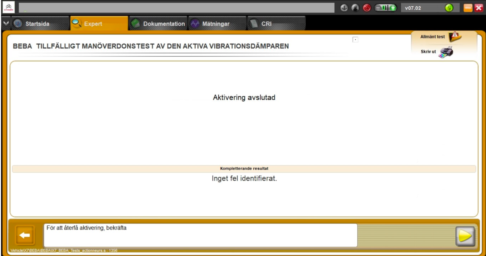

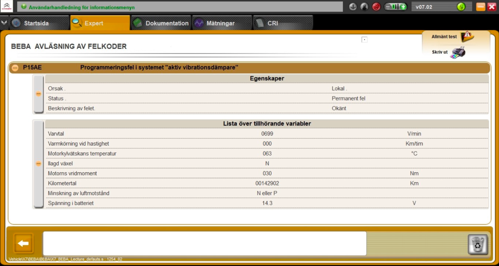

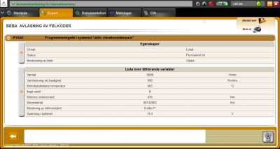

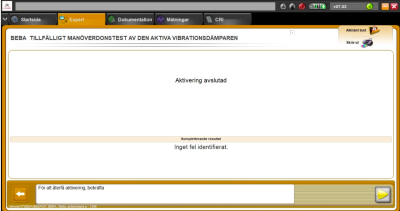

      I have a P15AE fault code.
      Last year I have noticed some vibrations at idle and in recent months I have noticed a "flapping" sound when accelerating.
      I cannot clear the P15AE fault code.
      When I do a function test in Diagbox, I hear the Active damper working for 5 seconds and get the message that there is no fault identified.
      How can I proceed?
