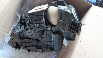

I located a 2nd-hand heater box (complete and with new flaps) from The Netherlands at a very fair price and with 6 months guarantee (they checked the VIN and it matches) ... arrived yesterday.
Can you tell me the part numbers for the 4 stepper motors (I'm guessing they're all the same) and also, when installing them, how do I synch the position of the flaps with the setting of the temperature (for the lower mixer motors) and the positioning (for the upper air direction motors) when installing them ???

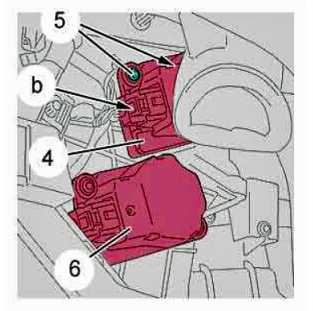

Reduction motors for distribution and mixing flaps ( right hand side)
Disconnect the connector at " b ".
Remove:
  • The bolts (5)
  • The reduction motor for distribution flaps (4)
Carry out the same operation to remove the reduction motor for mixing flaps (6).

N.B.: Position the locating tab correctly at " e" when refitting the reduction motor for mixing flaps.

Final update (I hope).
In the end I didn't feel up to doing it all on my own so got the Citroën specialist "Paul Clifford Motor Services" in Wingham (bit east of Canterbury) to replace it. Excellent, professional job; very, very reasonable price; looks and feels like new. Showed me the old box ... really trashed by someone trying to install new flaps by cutting but holes were far too small and they simply gave up.
