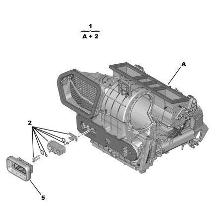

Re: C5 2007 heater
Hi Sam, thanks for the donation - your member status has 'hulked out' and gone green.
So item (1) which includes the housing (A) and the Refrigeration Pressure Release Valve (2) is as per part numbers below and costs £1020.86 inc. VAT from Citroen as of today.
6450RH: Evaporator Housing
6461J7: Refrigeration Pressure Release Valve
So you can at least search on this to see if you can get a second hand part.

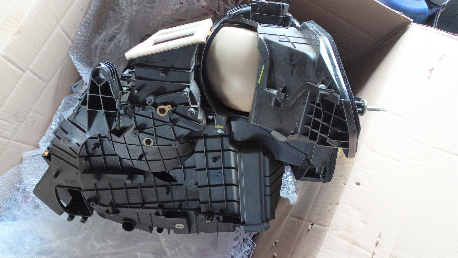

Re: C5 2007 heater
Thank you, Marc and Colin
What I hope is a final couple of simple (for you) questions ...
I located a 2nd-hand heater box (complete and with new flaps) from The Netherlands at a very fair price and with 6 months guarantee (they checked the VIN and it matches) ... arrived yesterday.
Can you tell me the part numbers for the 4 stepper motors (I'm guessing they're all the same) and also, when installing them, how do I synch the position of the flaps with the setting of the temperature (for the lower mixer motors) and the positioning (for the upper air direction motors) when installing them ???
Million thanks in advance ...

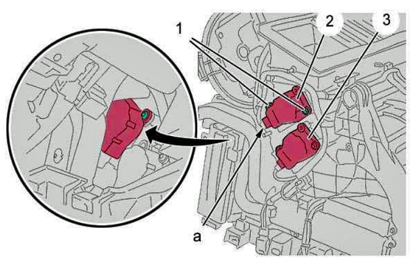

Re: C5 2007 heater
Hi Sam
Nicely done.
As for the Motor Reducers, they are 2 types fitted as you can see below.
Item (1) is part: 6447RF
Item (2) is part: 6447RJ
Here's a guide on removing and refitting them including the Air Quality Sensor:
Removing
Reduction motors for distribution and mixing flaps (left side)
Reduction motors for distribution and mixing flaps ( right hand side)
Air Quality Sensor
Refitting
Nicely done.
Removing
Disconnect the connector at " a ". Remove:
Disconnect the connector at " b ". Remove:
Refitting
N.B.: Position the locating tab correctly at " e" when refitting the reduction motor for mixing flaps. |

That's brilliant as usual, Marc ... very many sincere thanks. Synching the motors was worrying me a bit as I had no reference points to work from (incidentally, you've shown the mixer motor so is it the same for the distribution motor or is that more simple/complex as there appear to be stops to prevent the flaps going to far in either direction ... or is it, like the mixer, having the flat on the spline set centrally with the flaps and electrical switches also centralised ??).
- GiveMeABreak
- Posts: 37005
- Location: West Wales
C5 MK I 2.0 HDi SX Wicked Red
C15 Romahome White
XM 2.0 SX Polar White
CX 20 Polar White
GS 1220 Geranium Red
GS 1000 Cedreat Yellow - x 5646
Re: C5 2007 heater
This is the only method so should apply to both Air Mixing and Air Distribution Motors Sam, so they should only go on one way.

Re: C5 2007 heater
Great ... I'll practice before bolting it all together
Incidentally, the Dutch company is Bart Ebben near Nijmegen and they're Peugeot/Citroën dealers plus being 2nd-hand parts specialists. As usual, everything's in English on their website and they speak it, too. Prices include shipping.

Re: C5 2007 heater
Final update (I hope).
In the end I didn't feel up to doing it all on my own so got the Citroën specialist "Paul Clifford Motor Services" in Wingham (bit east of Canterbury) to replace it. Excellent, professional job; very, very reasonable price; looks and feels like new. Showed me the old box ... really trashed by someone trying to install new flaps by cutting but holes were far too small and they simply gave up.
Thanks for all your help and advice and I'd really recommend Paul Clifford ... they certainly know Citroëns inside out
