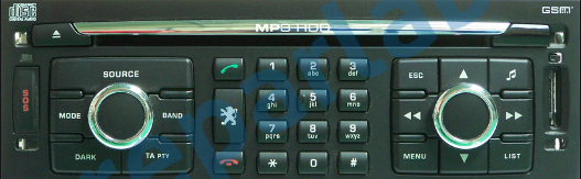

Ok, so what is the part number of the RT5 (RT4 ECO). There should be a part number that begins with '96xxxxxxx' or '98xxxxxxx' for example.
1) Can you put a picture up here of the unit.
2) How are you updating the Unit? CD or USB? If CD, did you burn it at low speed (max 4X speed) or is it an original 8.31 CD?
3) What is the exact message on the screen (a screenshot would be good)

the reference is 96656199XN. The update was done by CD but rather it was a reinstallation because it was already in 8.31. I have downloaded a backup of an RT4. Could it damage the unit in any way?

There are 2 possibilities I can think of:
1) That part number would indicate the older RT4 system:
The later RT4 / RT5 units that were fitted to your C4 in 2008 were these:
So I can't tell you if there are additional differences / compatibility issues between the older and newer units.
2) If you have copied a backup of an RT4 from somewhere else, and then installed it on a different RT4/5 then you may find that it won't work. When the firmware upgrades are undertaken I'm pretty sure it writes files to the Hard Drive as well as the chips on the motherboard of the Head Unit. So if you have just copied an older image back to the hard disk, then you may have a software mismatch between the Head Unit motherboard and what is on the Hard Disk I suspect. If it was just part of the operating system missing or corrupt, you could just apply the firmware again from the CD and it would re-write the firmware again. But if what I am saying is the case, then it may not be accepting the firmware because of a system mis-match.

Thank you very much Marc, for what I had investigated with the reference, this unit belonged to a c5 phase II or a Peugeot 407. What they did was change the front cover and that is where I think the problem may be, in the non-coherence between face and central unit. Anyway, what I said, thank you very much for the inconvenience and almost that I am not going to try to change the hard disk or I am going to damage the unit. All the best
