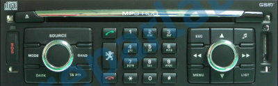

Ok, so what is the part number of the RT5 (RT4 ECO). There should be a part number that begins with '96xxxxxxx' or '98xxxxxxx' for example.
1) Can you put a picture up here of the unit.
2) How are you updating the Unit? CD or USB? If CD, did you burn it at low speed (max 4X speed) or is it an original 8.31 CD?
3) What is the exact message on the screen (a screenshot would be good)

the reference is 96656199XN. The update was done by CD but rather it was a reinstallation because it was already in 8.31. I have downloaded a backup of an RT4. Could it damage the unit in any way?

Thank you very much Marc, for what I had investigated with the reference, this unit belonged to a c5 phase II or a Peugeot 407. What they did was change the front cover and that is where I think the problem may be, in the non-coherence between face and central unit. Anyway, what I said, thank you very much for the inconvenience and almost that I am not going to try to change the hard disk or I am going to damage the unit. All the best
