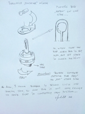

* New experience said that only rod, inside the capsule can be rotated. So there is no need to rotate entire capsule (this can create problems with vac tube distance and position)... only rod, connected to the rubber membrane, probably above some internal spring, can be rotated for 180 degrees).

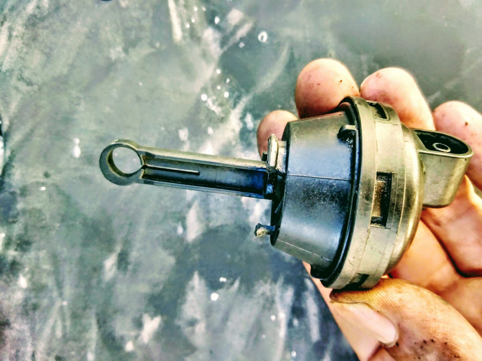

This is the capsule that with vacuum moves flap inside doseur. There's no springs inside...rubber on this capsule, holds flap open, and vacuum close it when Ecu wants... no need for double doseur, because single one done good job last 3 years since I own the car. Someone mentioned motor - that's above flap, black box should be position sensor. By my conclusion, flap movement is done only by this capsule. Wery simple method... Only maybe I will change rod with some DIY peace of plastic...
Another problem is, that I today, during check , moved one vac tube on the vac pump, and cracked connector... in lack of other tubes, reconnected it with peace of heat shrink tube, and duck electrical tape... all working, but I need to find some good peace of tube. Does someone knows for what is used first vac tube, toward You, when looking to engine, at asume vacuum pump, on right side of engine?

I remove it for photo... and set it back... here it is... You can see how top of the rod is damaged on one side. So now it is turned arround for 180° and works fine... I will keep You informed of progress..

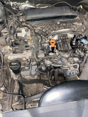

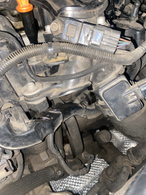

Hello, I have a similar problem, the car is Citroen C5 2011, 163hp, have two faults P0488 and P1498, when the check engine appears, my car lasts some power at this moment and later everything working fine. What I need to check for these faults, do I need to replace the Double air mixer or I can fix it?
Mimi
- (Donor 2021)
- Posts: 8
- Joined: 04 Apr 2021, 10:36
Re: Citroen C5 X7 Throttle exhaust problems
Also what i see now, somebody do the same to me like Doxat, they put single air mixer to my car, not double air mixer, one pipe(number 3) on erlier picture is disconected. Should I resolve problem if put double air mixer?
