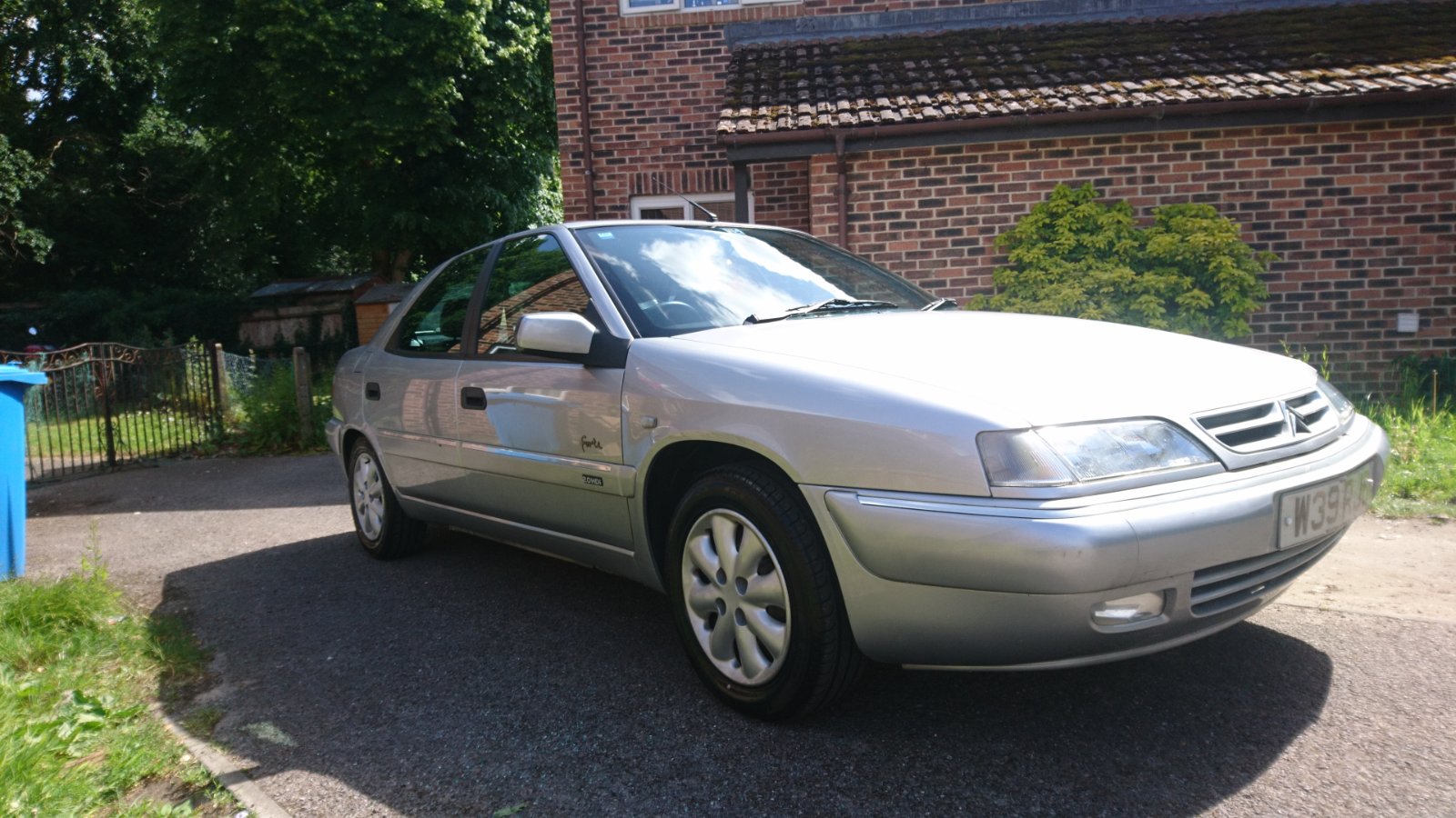

Hi all
The trims on my Xantia are getting a little bit tatty and as they are original i would like to keep them.
My idea is to soak them in a bucket of sugar soap solution to get them back to base level and then see where i go from there.
I assume i will then need to use a plastic use paint primer and then similar type paint for the top coat.
Should i also put a lacquer coat on as well, trying to keep the colour the same as original so all ideas and thoughts really appreciated.
Colin
Colin

Thanks for the replies.
I want them to look like nearly new, i don't want them to look like a cheap set bought of the bay just as they are shiny and take away from the car itself as it has been touched up here and there but still looks good. May need to do some digging to find out the original colour they came in and tone it down a little bit.
Guess if i do the sugar soap solution i should get some decent size flakes of paint to go and match ?
Colin
Colin

Re: Wheel trim painting opinions
I have tried to see where i have posted other pictures but can't find them.
The pictures I think are about 2 years old but if you look/zoom in on the n/s rear wheel trim you can see the paint peel.
Oddly enough now looking back at the pictures maybe the colour is a pretty good match to that on the car.
Yes she still has the same shine when washed, no extra dings just a bit of paint flecks missing on the front bumper. Colin

I would think that body colour will be fine Colin, as long as you get a good finish they will blend in with the body in a few weeks.
Thanks Mick.
I will need to check the paint code for the car, and yes looking back at those pics they do look right with a similar colour to the body.
Just checked and those pictures were taken 03/06/2019 and the tyres had not long been put on, they are still on there and have done around the 22k mark give or take.
I reckon 1 plastic primer rattle can, 1 main paint rattle can and 1 clear coat rattle can will do the job then
And i will take pics of the process
Colin
Colin

Yep that should do it but if you use wet and dry to rub them down make certain they are properly dry and degreased with prepaint or a tac cloth, preferably with a heat gun/hairdryer before you put on the primer. If you have the slightest moisture in the form of microscopic droplets when you spray they will emerge through the paint in a few days and give you goose pimples. not good!! I'll look forward to seeing the pics.
