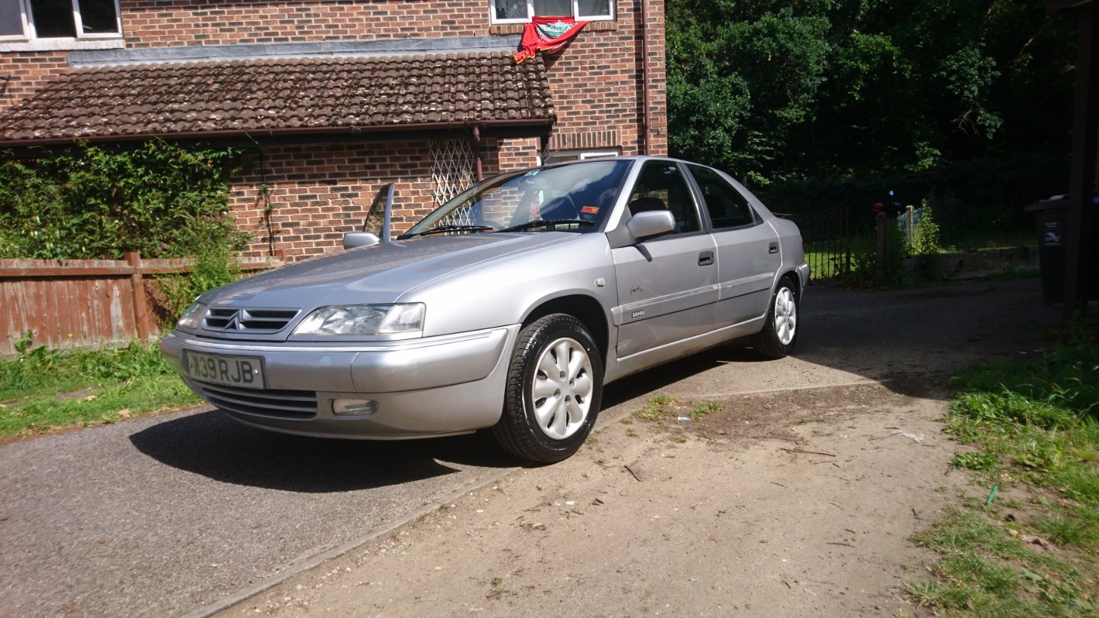

I have tried to see where i have posted other pictures but can't find them.
The pictures I think are about 2 years old but if you look/zoom in on the n/s rear wheel trim you can see the paint peel.
Oddly enough now looking back at the pictures maybe the colour is a pretty good match to that on the car.
Yes she still has the same shine when washed, no extra dings just a bit of paint flecks missing on the front bumper.
Colin

Re: Wheel trim painting opinions
I would think that body colour will be fine Colin, as long as you get a good finish they will blend in with the body in a few weeks. :)

I will need to check the paint code for the car, and yes looking back at those pics they do look right with a similar colour to the body.
Just checked and those pictures were taken 03/06/2019 and the tyres had not long been put on, they are still on there and have done around the 22k mark give or take.
