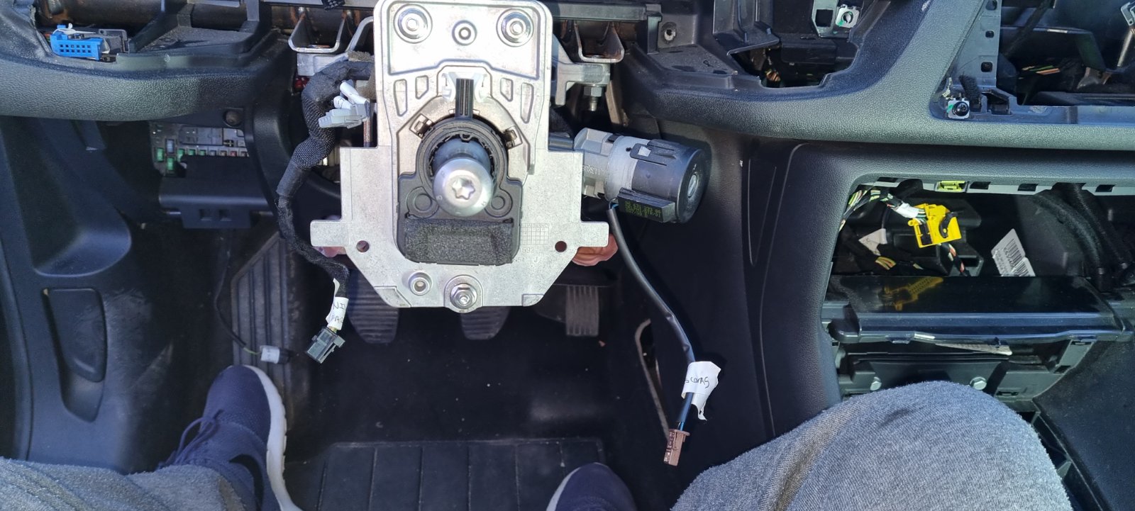

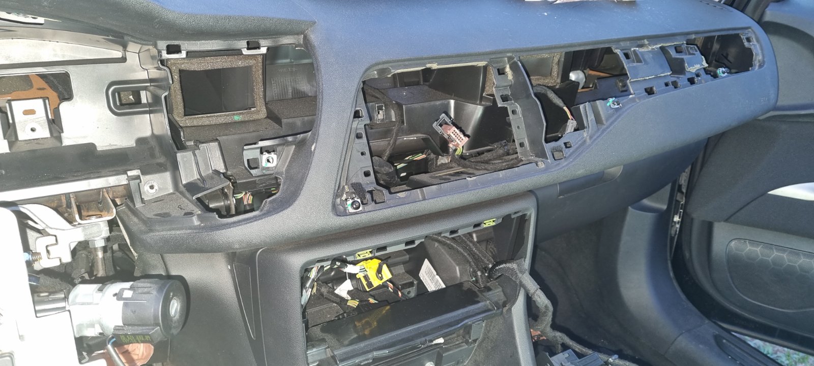

good morning my citroen c5 1.6 of 2008 the 3 airbags (dashboard steering wheel and knee) burst, CEI to disassemble to make the replacement ... but now i have a dilemma, i can't find all the screws to remove the dashboard and replace .. does anyone have any maps to provide? thank you good sunday

ah ok thank you .... now i need to remove the dashboard but i don't see any more screws in the meantime i found this diagram but i don't understand

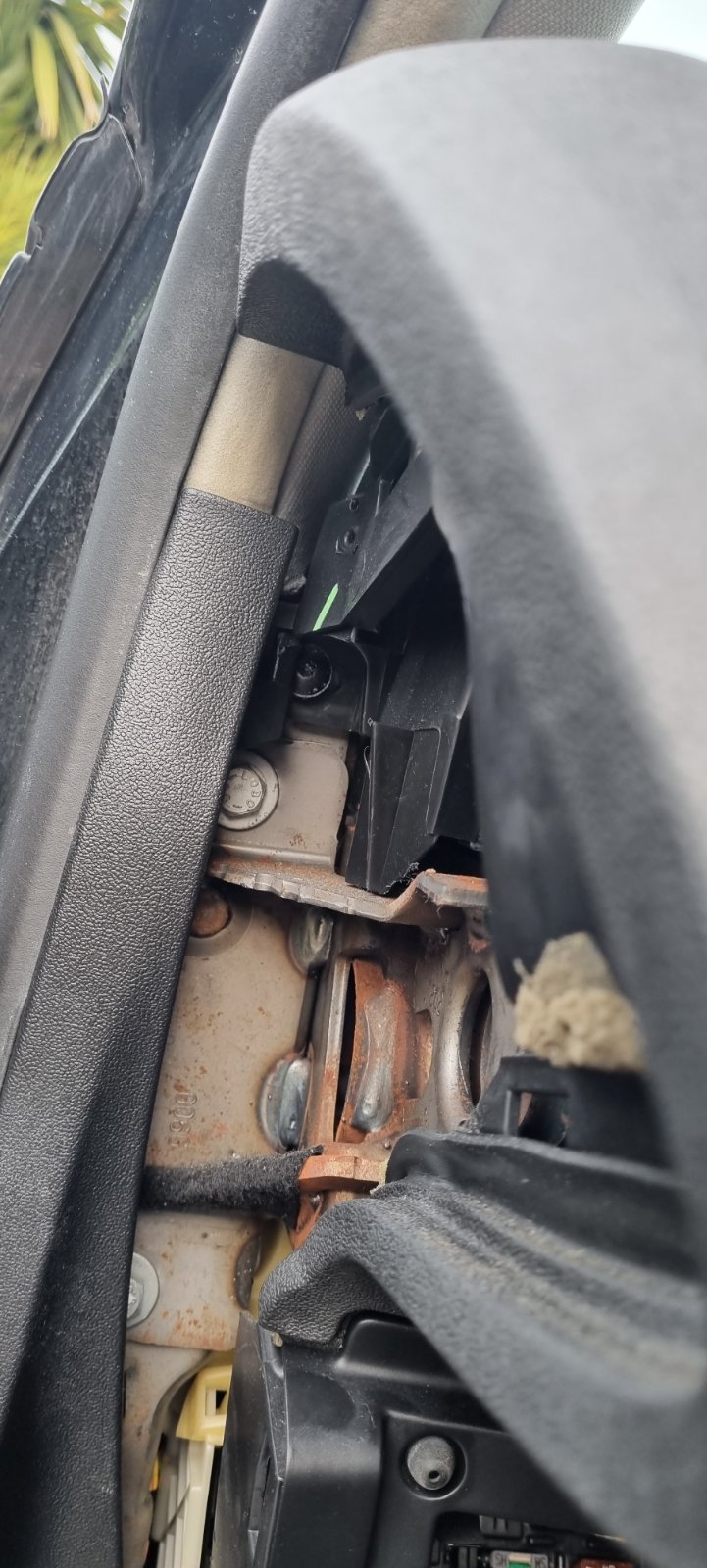

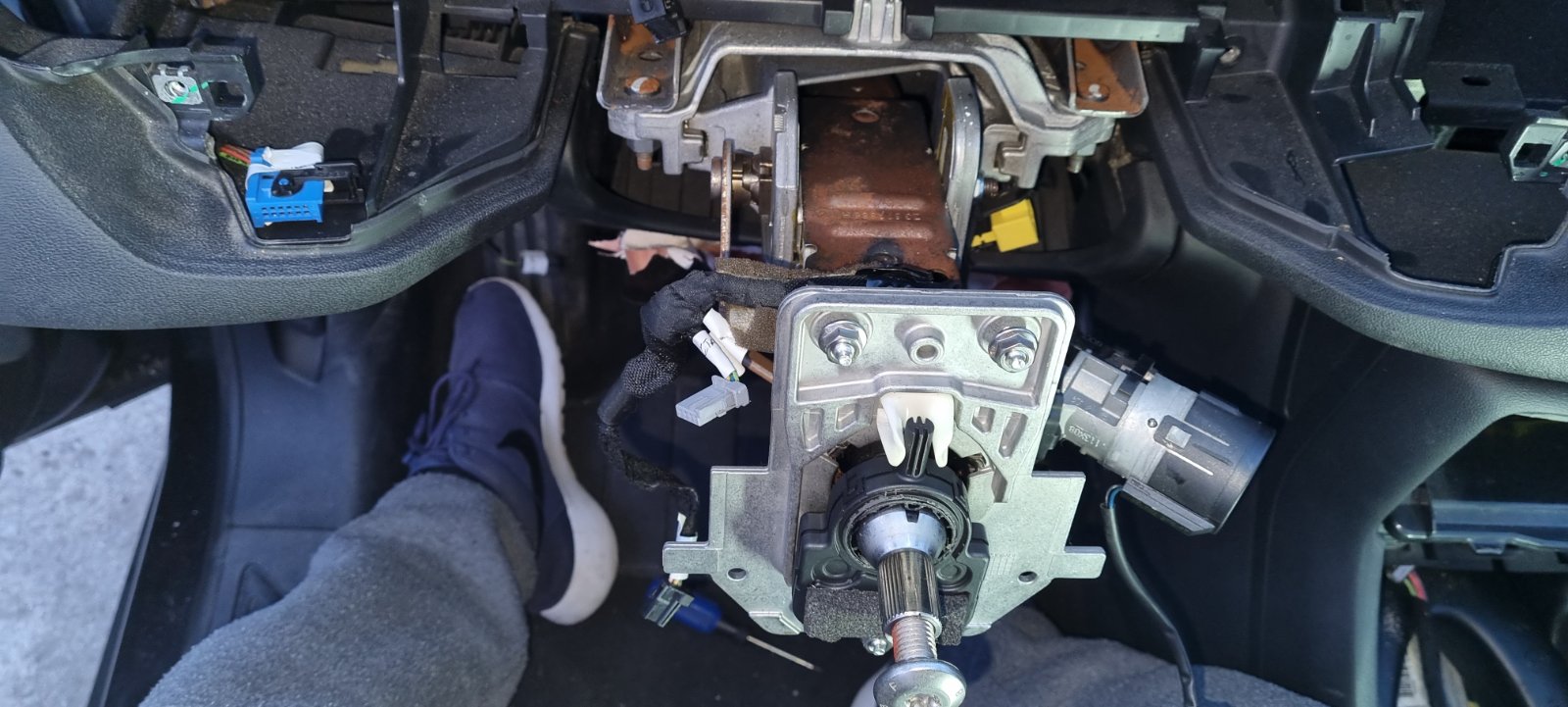

do I have to loosen any screws on the engine?
x 6954
Re: airbags acionados- não consigo tirar tablier
Removal of the dashboard is a big job and one I won't go into here as it involves removing multiple parts. In some cases the front door may need to be removed to gain access to the bolts too. You will have engine bulkhead bolts to remove too. Don't forget you will have to replace the seat belt units too, as in an impact the pre-tensioners are triggered - so they need replacing.

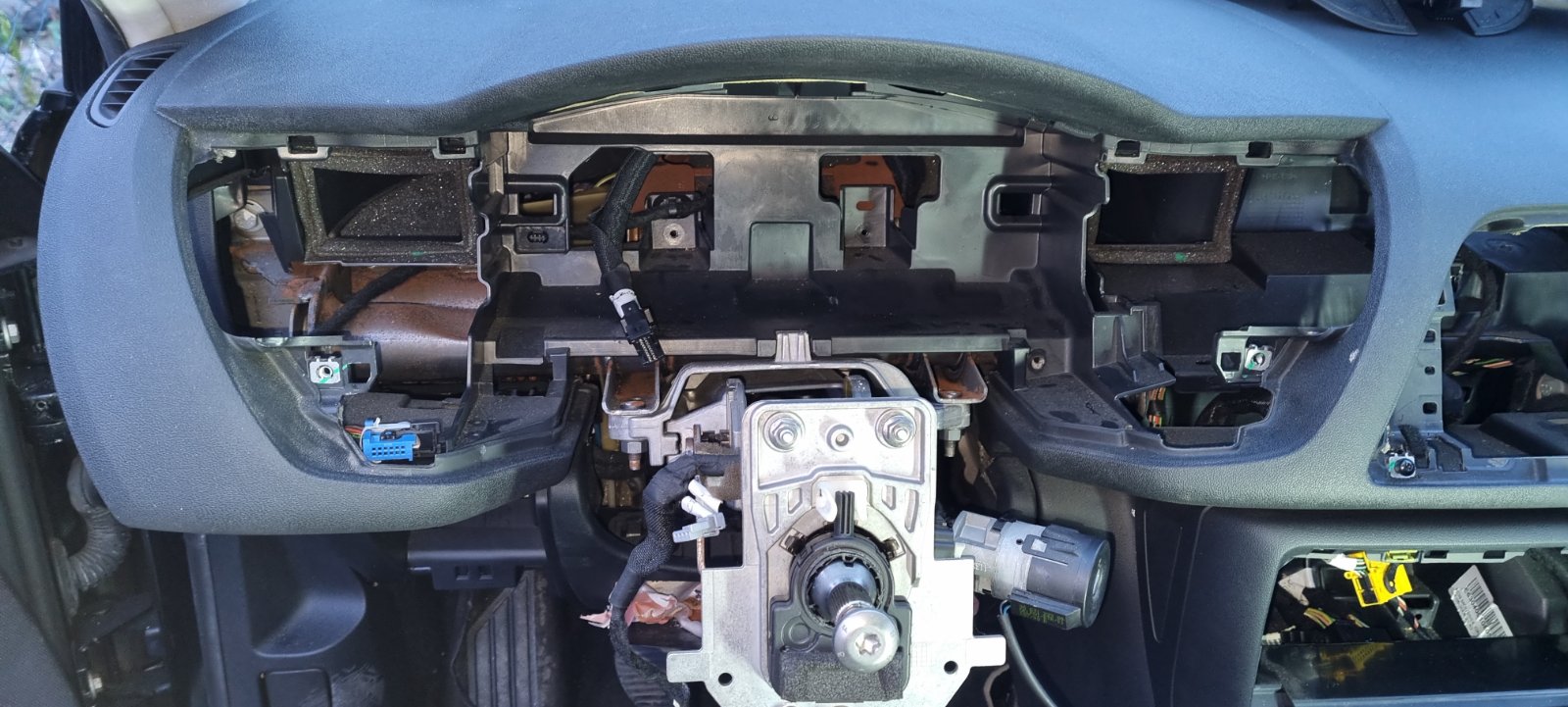

Im doing

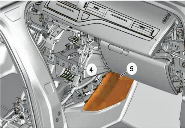

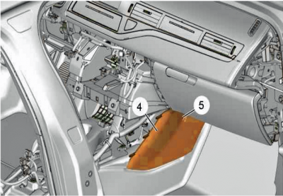

Remove:
  • The (5) bolt
  • The right-hand trim of the centre console (4)

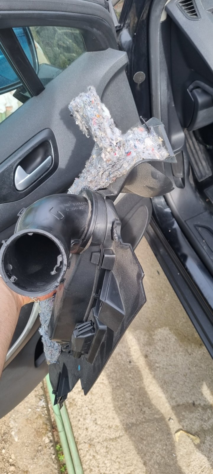

Remove the air conduit.

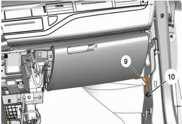

Remove the nut (10).
Detach: The harness (9).

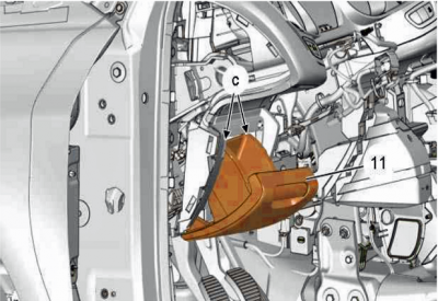

Open the glovebox (11).
Unclip: The glove box (11) (at "c") using trim removal tools.
Unclip: The glove box (11) (at "d") using trim removal tools.
Remove the glove box (11).

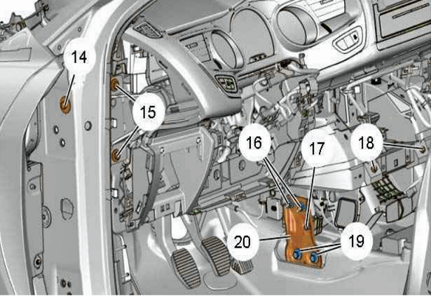

CAUTION: Do not close the driver’s door when bolt (14) is unscrewed (Risk of damaging the door).
Unscrew the bolt (14).
N.B. : Remove the drivers door to replace bolt (14) (if necessary).
Remove:
  • The bolts (15), (17), (18), (19)
  • The nuts (16)
  • The strengthening strut (20)
Remove the bolts (21).

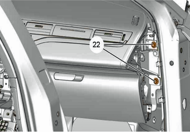

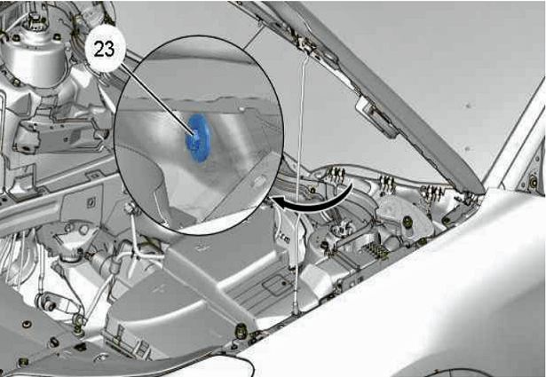

Remove the bolts (22).Remove bolts (23) (Engine compartment).

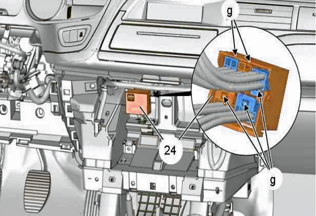

Unplug the connectors from the audio system connector (24) (at "g") (according to equipment).
Liberate the wiring harness.

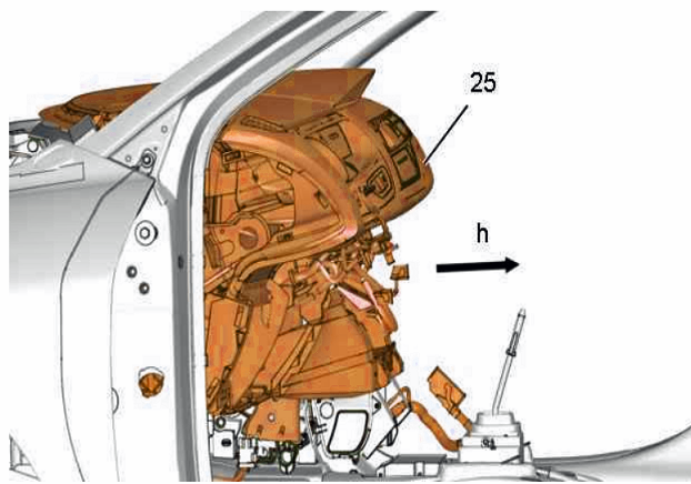

N.B. : For the following operation, 2 operators are necessary.
Detach the dashboard (25) (following "h") (Carefully).
CAUTION: Store the dashboard panel, placing it on a table and protecting it with bubblewrap.
Remove the fascia (25) through the driver’s door (Carefully).
