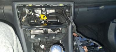

ah ok thank you .... now i need to remove the dashboard but i don't see any more screws in the meantime i found this diagram but i don't understand

Cant paste photo

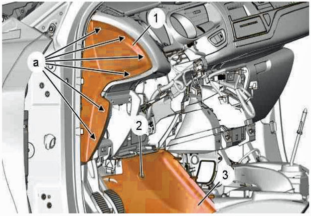

Unclip : The dashboard side trim (1) (at "a") using trim removal tools.
Remove:
  • The dashboard side trim (1)
  • The (2) bolt
  • The left-hand trim of the centre console (3)

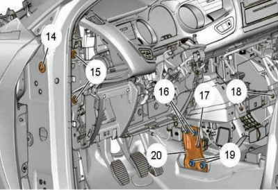

CAUTION: Do not close the driver’s door when bolt (14) is unscrewed (Risk of damaging the door).
Unscrew the bolt (14).
N.B. : Remove the drivers door to replace bolt (14) (if necessary).
Remove:
  • The bolts (15), (17), (18), (19)
  • The nuts (16)
  • The strengthening strut (20)

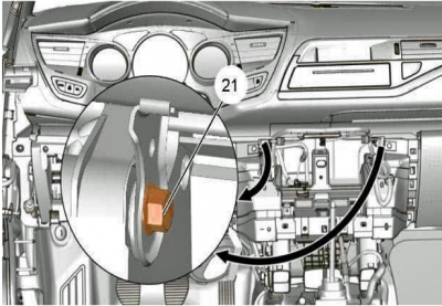

Remove the bolts (21).
