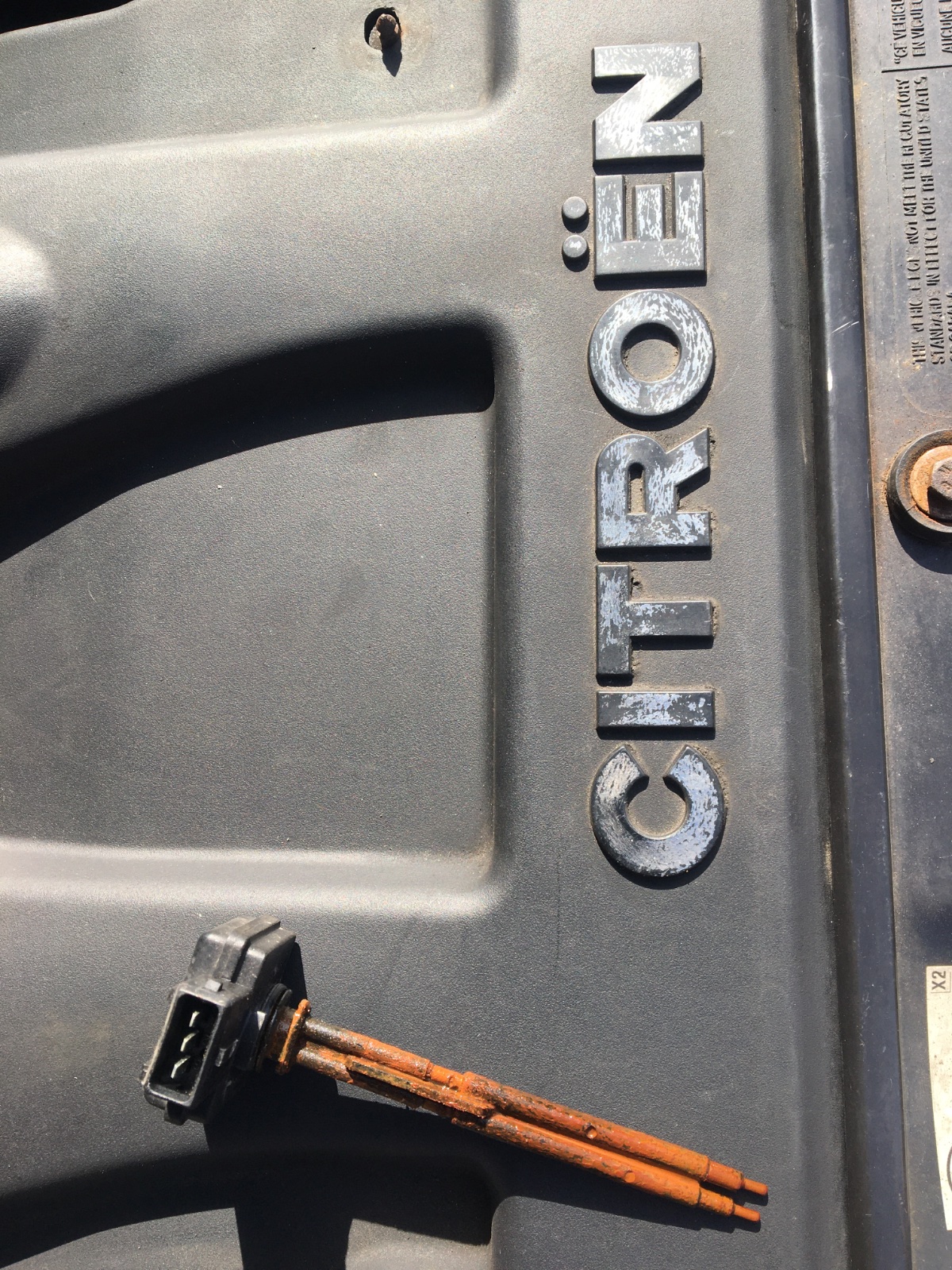

Well I have topped up the coolant level because it was low but the light intermittently reappears.
Dommo mentioned the fans. Well I did drop the fuse for the fans under the battery I think so I need to locate that. But then surely the light would stay on?
The external temperature sensor in the dash appears to be working again. I am beginning to think it is down to high resistance in the wiring because of the route of the wiring and the fact that the footwell (certainly rear footwell did have standing water in it at some point).
It started at 47 degrees the other day then dropped to 14 degrees (which probably was the outside temp) and gradually rose up to 50 odd degrees.
Another thing for the investigation list.

Coolant level sensors often rely on a pair of metal probes that sense the conductive liquid in the tank.
The surfaces of the flat or round probes can oxidise, and acquire a coating, which makes them less conductive. Scrape the probe ends clean, back to bare metal. Any oil in the coolant can aggravate this, as it will cling to the probes.
To check the level sensor, short the probe ends (NOT the electrical connection to the sensor, which is likely to be powered), just as a test, and see if the low level warning disappears.

You could very well be right in this. The coolant was filthy.white exec wrote: 20 Mar 2021, 16:35 Coolant level sensors often rely on a pair of metal probes that sense the conductive liquid in the tank.
I found the 30A fuse for the cooling fans and plumbed that back in. No change.
Is it easy to get access to the sensors?

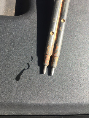

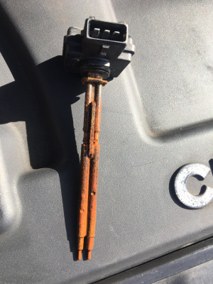

And the award goes to Chris (whiteexec) with additional awards to everyone else for their insight and ideas. I am sure I will find the information useful again in future.
Must start bookmarking things. First saw that facility yesterday after how long?
The conductor probes of the Cartier coolant level sensor in the water header tank were indeed encrusted. There are two probes with what appears to be upper and lower levels.
I am sure I am going to see the STOP light on every week as it does appear to lose water at a regular rate. I can’t recall the STOP light ever being on when the car was being regularly used previously so that’s something to keep an eye on.

Oh it worked just fine Chris.
I should have perhaps made that clearer.
Need to get around to stripping EGR, cleaning that, fitting new turbo if I feel like spending that kind of money, new MAF and flushing coolant system and fitting O/S window regulator.

Good. Those probes do look as of there has been a lot of rust sculling around in the coolant, so whatever was in there hadn't been doing a good job on the anti-corrosion front.
Can recommend LiquiMoly Radiator Cleaner (1 x 300ml can is enough), and Citroen's own 'PRO' coolant (standard blue glycol type). You'll get a hundred other coolant recommendations (like tyres, oil, fuel, screenwash...), but that would be mine. The cleaner is superb stuff - just follow the destructions on the can/website.
