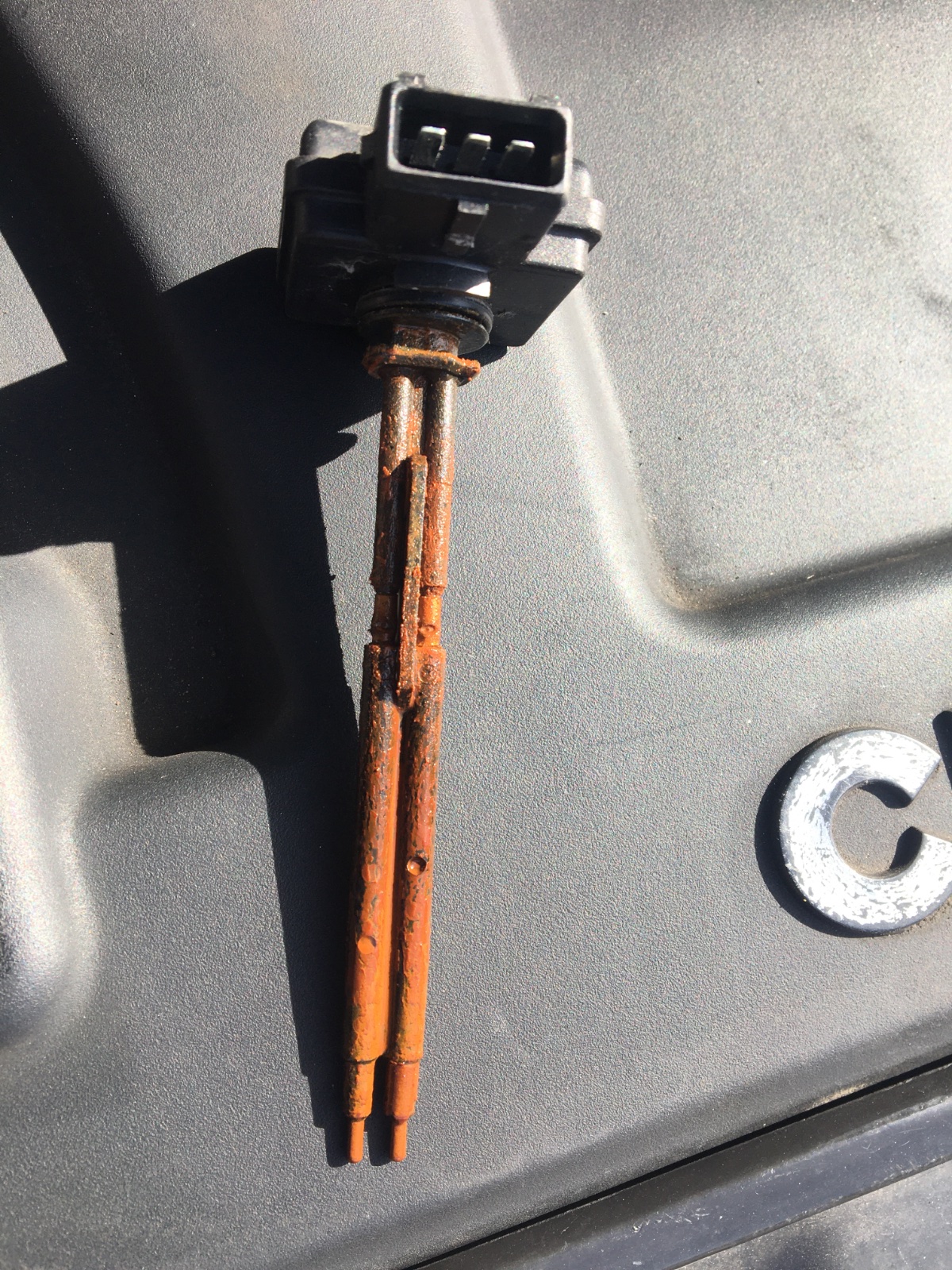

And the award goes to Chris (whiteexec) with additional awards to everyone else for their insight and ideas. I am sure I will find the information useful again in future.
Must start bookmarking things. First saw that facility yesterday after how long?
The conductor probes of the Cartier coolant level sensor in the water header tank were indeed encrusted. There are two probes with what appears to be upper and lower levels.
I am sure I am going to see the STOP light on every week as it does appear to lose water at a regular rate. I can’t recall the STOP light ever being on when the car was being regularly used previously so that’s something to keep an eye on.

Good. Those probes do look as of there has been a lot of rust sculling around in the coolant, so whatever was in there hadn't been doing a good job on the anti-corrosion front.
Can recommend LiquiMoly Radiator Cleaner (1 x 300ml can is enough), and Citroen's own 'PRO' coolant (standard blue glycol type). You'll get a hundred other coolant recommendations (like tyres, oil, fuel, screenwash...), but that would be mine. The cleaner is superb stuff - just follow the destructions on the can/website.
