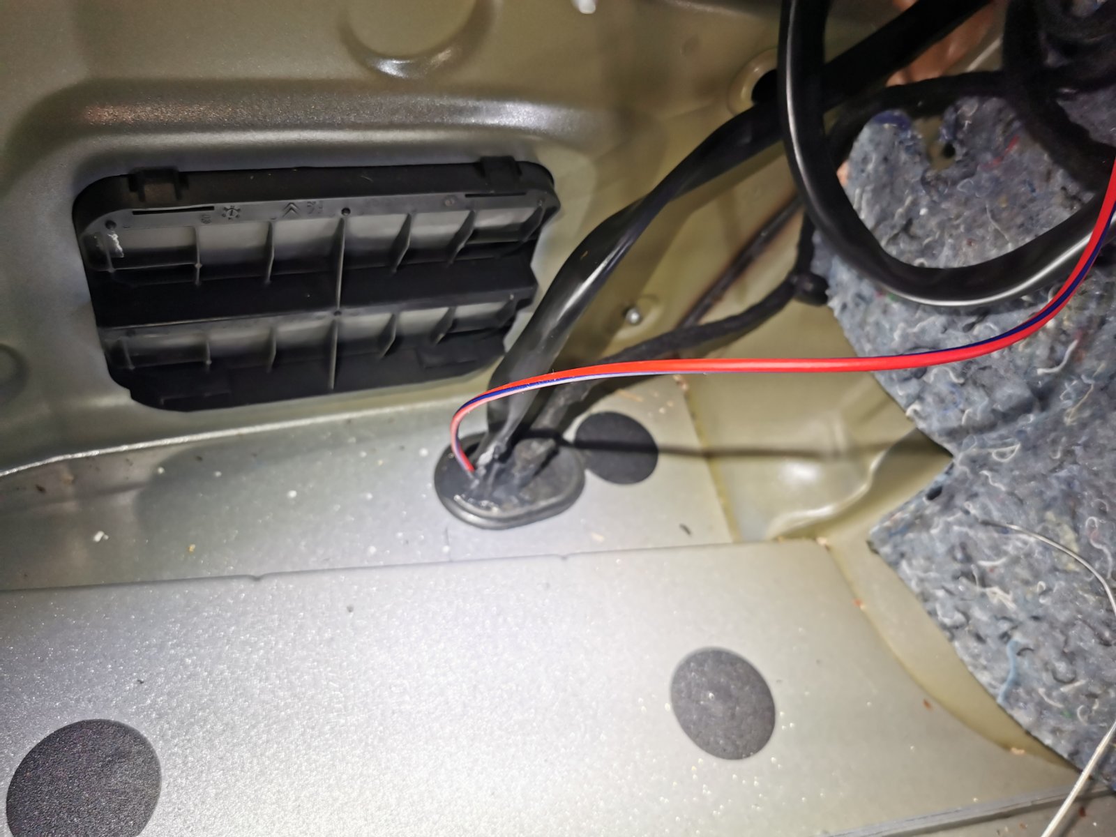

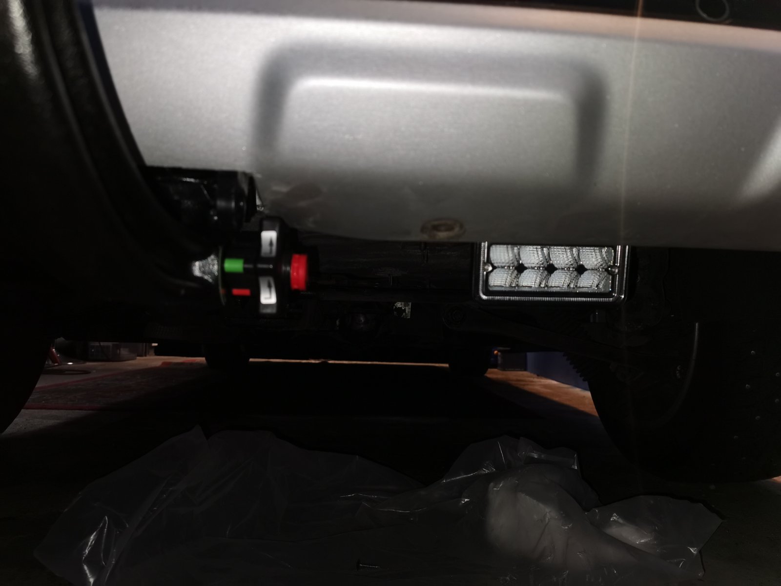

About the reverse light it was a thinkering this one. As I wanted to mount it legal (minimum distance from ground to bottom of light 10"/25cm, amongst other rules). I found a steel "lip"/ joint, vertical, see pictures. It just fit a 8,5mm holes for the M8 bolt. The light itself is physically low and wide, and with less than 26cm distance it was a close call.

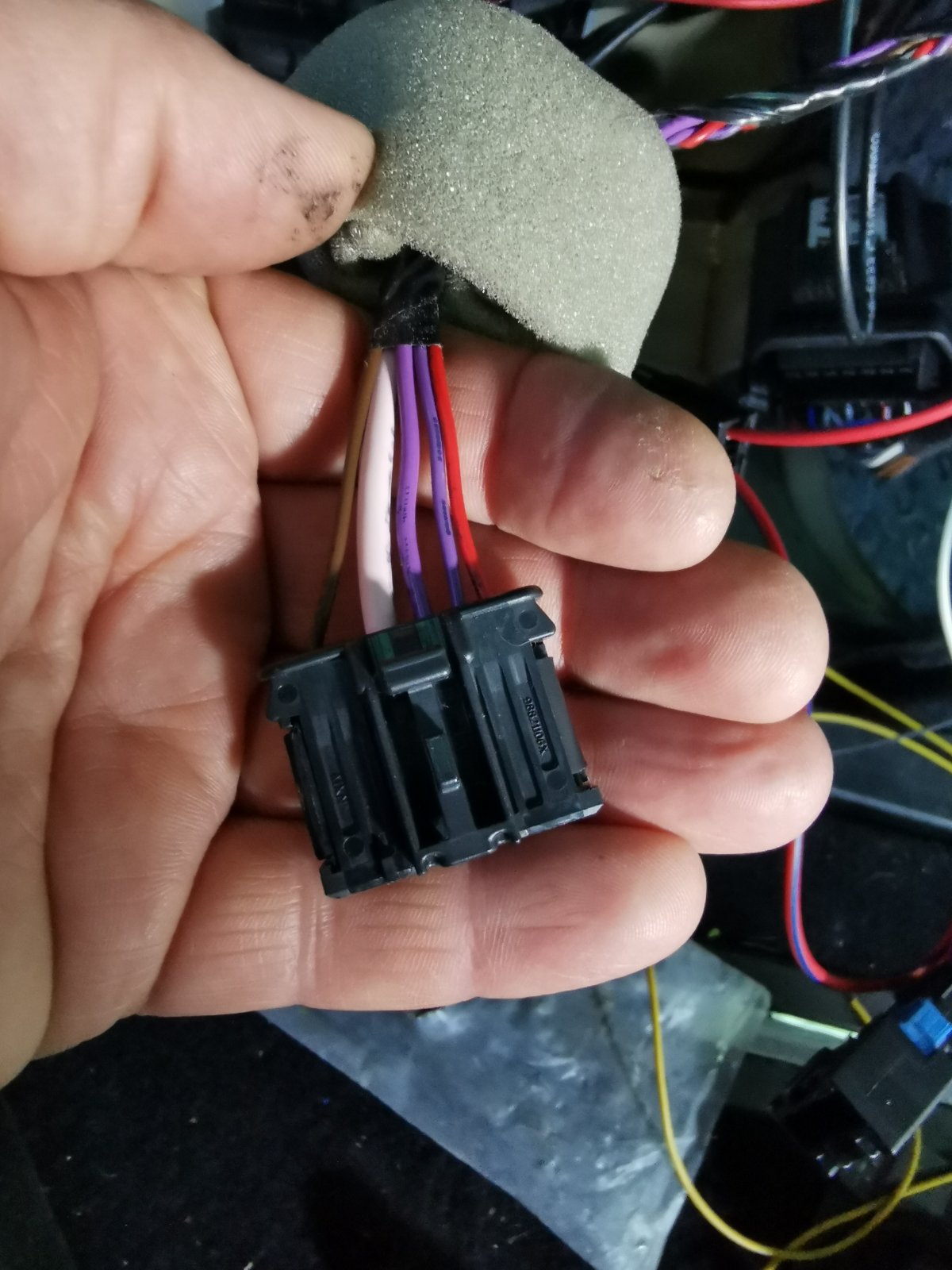

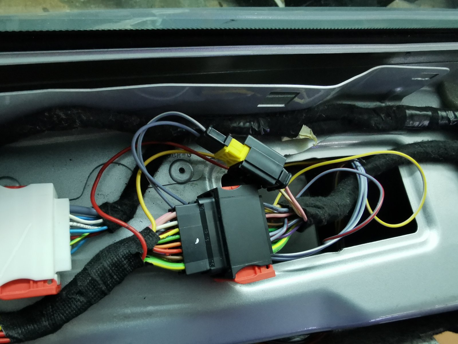

One connector at the left rear side, who was unused until I connected the trailer control unit, seemed to have one thick wire, that seems to be alive permanent. Since the light is LED and consumes less than 1A, I took the chance to use this as power source. Signal for reverse i found at the big connector at the rear side window, a red thin wire there goes to the left reverse light.

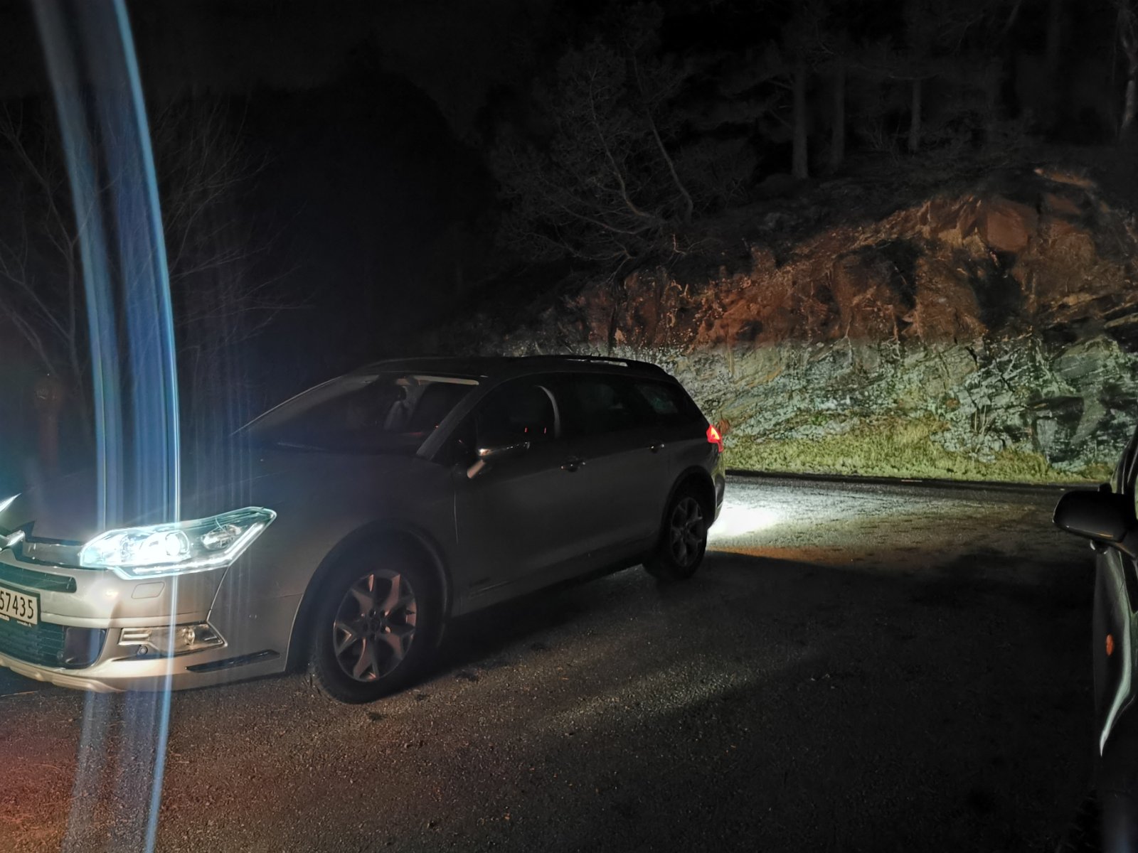

That light vastly improves reversing and from what I can see, does not appear to blind rear traffic being that it is mounted quite low. I think that you were right in that this is a better solution than trying to get aby decent reversing light LEDs - which runs the risk of electrical faults and may be too bright for following traffic being that they are mounted a lot higher.

Thank you Marc. Yes, I wanted a rather powerful light as I live and drive often in areas with no or very little lightning. Haven't used alot time recently to find supergood LED-bulbs for replacing the originals, as I have tried this with other cars and other bulbs previously, with limited effect. Still the local rules (more or less same as EU) limits the reversing lights as they state no more than 1 lux at 25meters. This light is 12W, 1130Lumen and 1 lux at 30 meter. So its not completely legal, but the best I could find within a reasonable price range and availability, and also fitting physically. It was a pain to find a light that is fitting and legal.. I will be surprised if the local MOT will look more into this.
