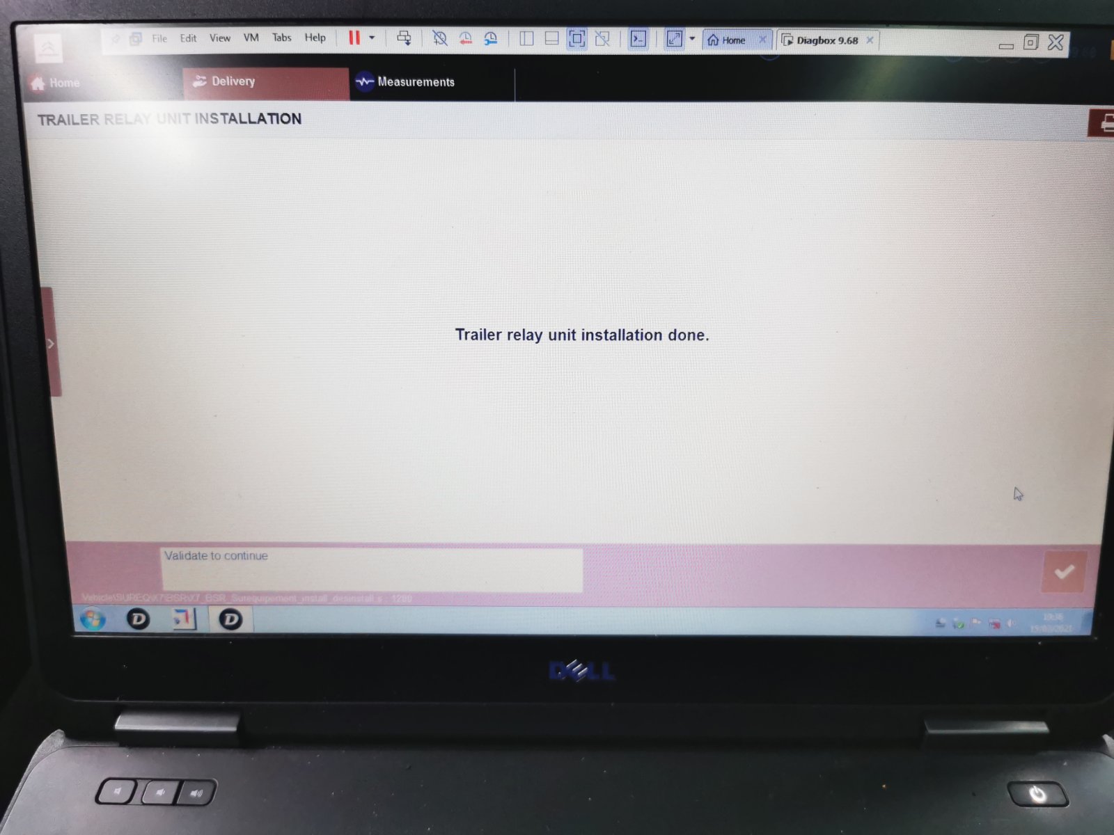

In the Diagbox (9.68) I was a bit unsure what to change, so I did only the routine for "preparing a new car", selected trailer connector there and enabled it.

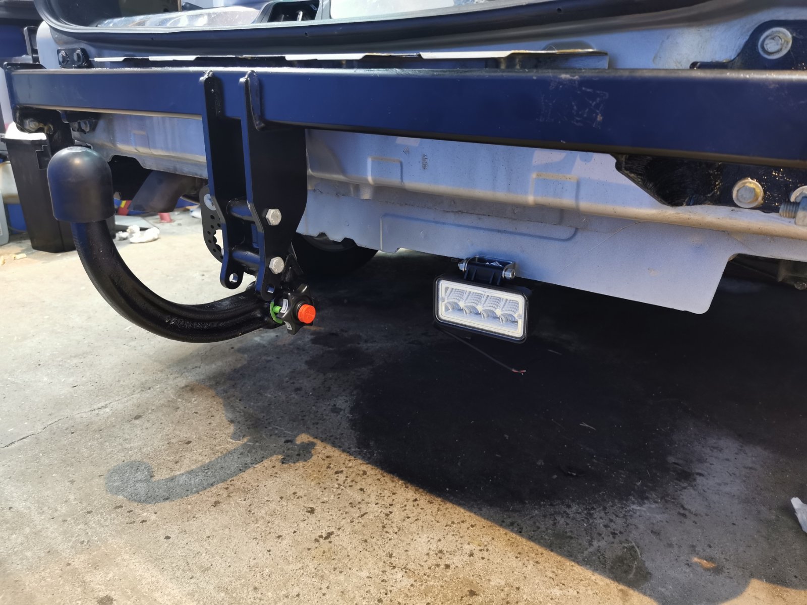

About the reverse light it was a thinkering this one. As I wanted to mount it legal (minimum distance from ground to bottom of light 10"/25cm, amongst other rules). I found a steel "lip"/ joint, vertical, see pictures. It just fit a 8,5mm holes for the M8 bolt. The light itself is physically low and wide, and with less than 26cm distance it was a close call.

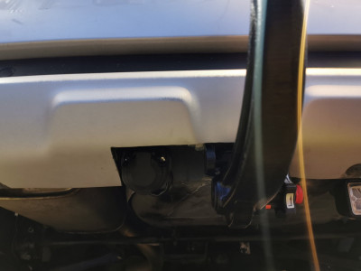

Cutout measures according to instructions was not correct, after some adjustments it fit nicely.

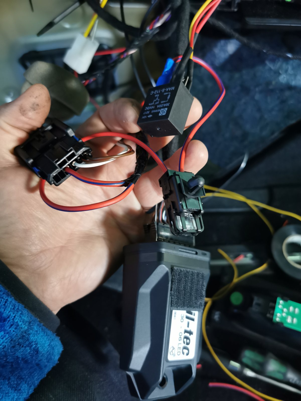

This plug was unused until trailer unit was to be mounted. I used power from here to feed the relay to the reverse light.
Messy, but it works.

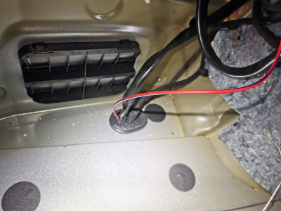

This rubber hose at the left rear was fine to use for all cables.

Here you can see the mounting of the light.

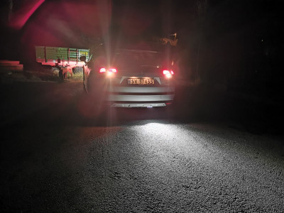

Reverse light works surprisingly well. I thought I would loose some lights by mounting it this low and long under the car, but this works just fine for my use.

Registration in DiagBox went smooth.

That light vastly improves reversing and from what I can see, does not appear to blind rear traffic being that it is mounted quite low. I think that you were right in that this is a better solution than trying to get aby decent reversing light LEDs - which runs the risk of electrical faults and may be too bright for following traffic being that they are mounted a lot higher.
You can see more in the rear view mirror than with the Camera, but this was a known failing with the early reversing cameras and low light levels / resolution. But as long as you can see enough close up you should be fine.

Thank you Marc. Yes, I wanted a rather powerful light as I live and drive often in areas with no or very little lightning. Haven't used alot time recently to find supergood LED-bulbs for replacing the originals, as I have tried this with other cars and other bulbs previously, with limited effect. Still the local rules (more or less same as EU) limits the reversing lights as they state no more than 1 lux at 25meters. This light is 12W, 1130Lumen and 1 lux at 30 meter. So its not completely legal, but the best I could find within a reasonable price range and availability, and also fitting physically. It was a pain to find a light that is fitting and legal.. I will be surprised if the local MOT will look more into this.
The camera (or is it the screen?) is surprisingly bad in low light levels. I have used Pioneer ND-BC8 camera in Pioneer headunits in several cars, this works fine, and even tiny reverse lights helps to illuminate what you see via the screen. So I have been thinkering if I could try to replace the OE camera with the Pioneer, as I have one of these cameras laying here... But if its the screen who is troublesome, it wount help.. If I could just replace the headunit to a 2-Din without destroying the interiour.... :-D
Naah. Probably never doing anyting with it, as it works pretty fine now by looking into mirrors instead.
