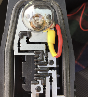

However, PSA are notorious for bad wiring and we had a similar issue with the C3 - there is a common earth shared between all the rear lights and ours also had intermittent lighting issues at the rear. As you an see when I checked out the rear left connection on the plug, the Earth pin socket had melted away. So I bypassed the plug completely and connected the earth from the loom directly onto the lamp cluster after drilling a small hole and used some thicker wire:

The issue with mine at present isn't an earth issue. Although I may end up by-passing the earth through the 6 pin plug as you have done. My problem at the moment is that I have no power to the L/H indicator or sidelight wiring (before the 6 pin plug even) when these things are switched on!
