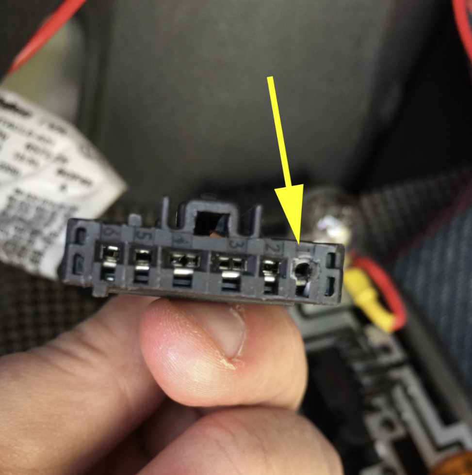

Started out as sidelight not working properly when the indicator or brake light is on, L/H rear light unit. Took the bulb unit out and as suspected the earth pin terminal is a bit burnt, but still serviceable, and after cleaning the contacts I have good continuity between the earth 'path' on the bulb side and earth when connected.

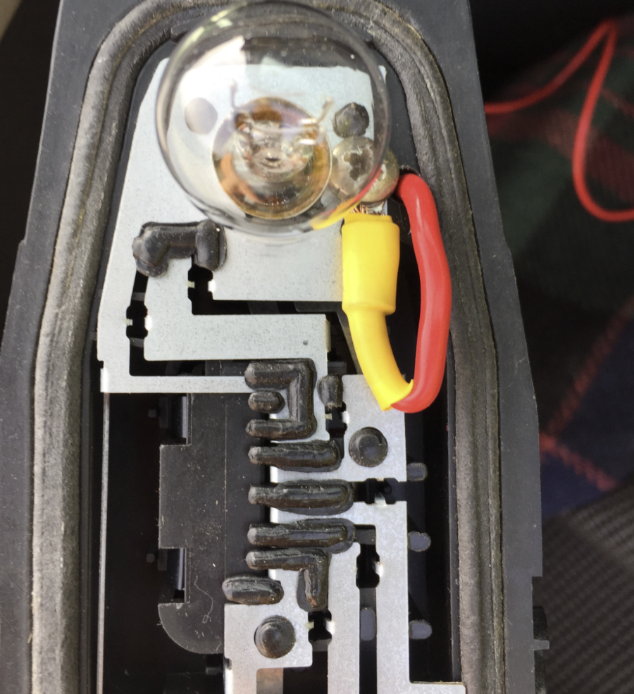

However, PSA are notorious for bad wiring and we had a similar issue with the C3 - there is a common earth shared between all the rear lights and ours also had intermittent lighting issues at the rear. As you an see when I checked out the rear left connection on the plug, the Earth pin socket had melted away. So I bypassed the plug completely and connected the earth from the loom directly onto the lamp cluster after drilling a small hole and used some thicker wire:

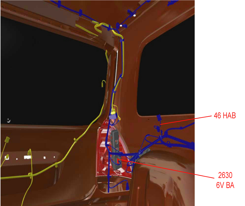

Ok, so just to confirm that on your car:
Pin 3 seems to be the Common Earth for the Rear Left Hand Lamp Unit on the body.
Pin 4 is the Common Earth for the Rear Right Hand Lamp Unit on the Body.
2630: rear LH lamp unit on the body
2635: right-hand tail lamp
289 and 290 are the rear cluster indicator wires
Pin 6 (Rear Left) and Pin 3 (Rear Right) is for the rear indicators and these are controlled by the BSI directly, whereas the Side and Front Indicators go to the Engine Fusebox.
From what I can tell, the rear lamp cluster connects to harness 46 HAB - and this goes to the BSI via this harness to a 16 pin Black connector on the BSI (Pins 14 & 13)

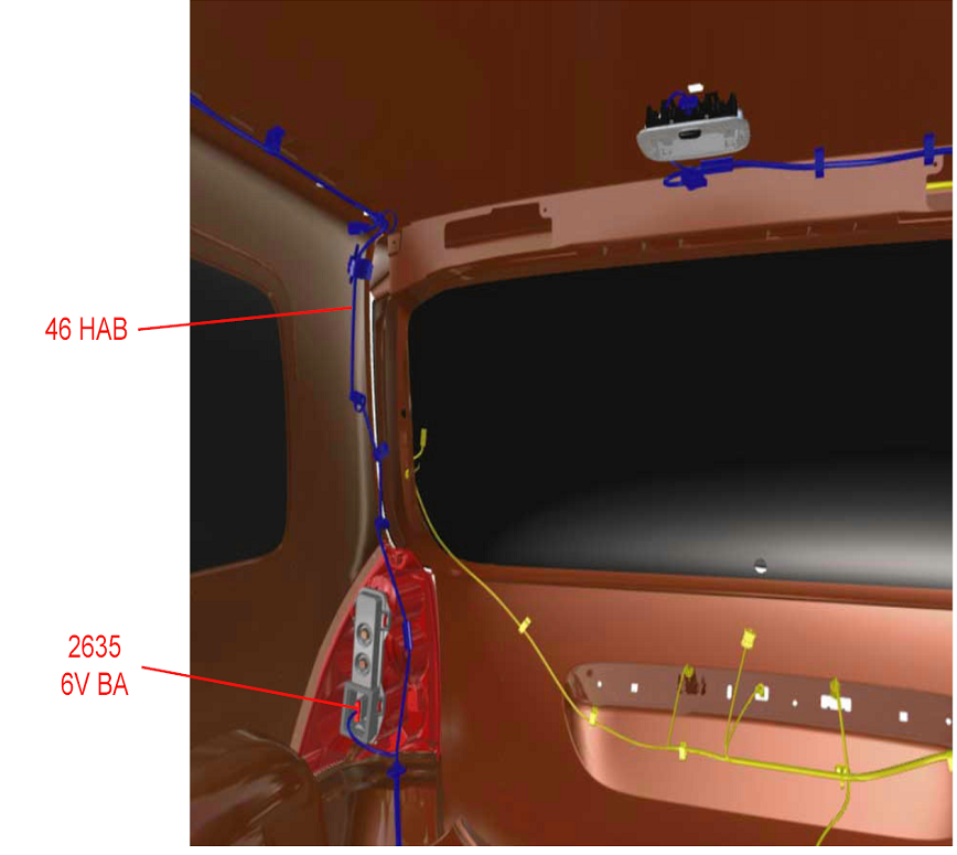

Here's the harness for the rear right hand side:
Here's the BSI showing that Connection, so might be worth checking whether you are getting any output from those pins on the BSI first of all
