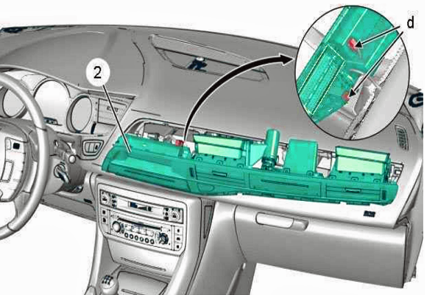

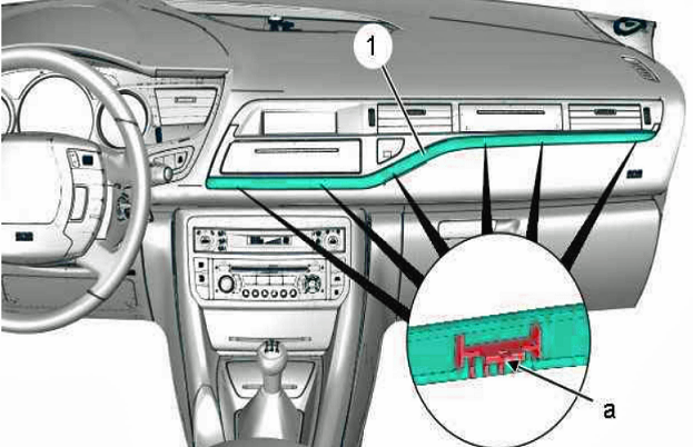

Re: Myway Sat Nav
Here you go:
Unclip the fascia panel front panel trim (1) ( as "a") using trim tools. Remove the fascia panel front panel trim (1). These just lift off carefully with a flat plastic trim tool. | That will expose the 3 bolts shown at (3) that you need to remove. |
Unclip the fascia panel front panel (2) (as "b", "c"). Detach the fascia panel front panel (2). | Hold the fascia panel front panel (2). Disconnect the connectors (as "d"). Remove the dashboard fascia (2). |
If necessary, detach the air vent (4) (as "e", "f"). Remove the air vent (4). | If necessary, detach the air vent (5) (as "g", "h") - but you may not need to do this. |
Remove the bolts (2). Detach the colour multifunction screen (1). | Disconnect the connectors (as "a"). Remove the colour multifunction screen (1). |
