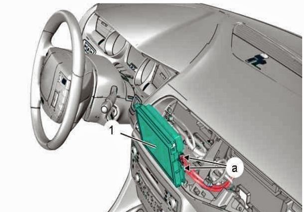

So I would check the lead connections at the back of the screen.
To do that you will have to use some trim removal tools to take of the fascia. It's quite easy - check back in 2 minutes and I'll have put up some pics for you

Here you go:
Unclip the fascia panel front panel trim (1) ( as "a") using trim tools.
Remove the fascia panel front panel trim (1). These just lift off
carefully with a flat plastic trim tool.
That will expose the 3 bolts shown at (3) that you need to remove.
Unclip the fascia panel front panel (2) (as "b", "c").
Detach the fascia panel front panel (2).
Hold the fascia panel front panel (2).
Disconnect the connectors (as "d").
Remove the dashboard fascia (2).
If necessary, detach the air vent (4) (as "e", "f").
Remove the air vent (4).
If necessary, detach the air vent (5) (as "g", "h") - but
you may not need to do this.
Remove the bolts (2).
Detach the colour multifunction screen (1).
Disconnect the connectors (as "a").
Remove the colour multifunction screen (1).

No problems - on the top connector pin 1 is the supply and pins 3 and / or 6 are the earths.
Then try and remove both connectors and re-attach to rule out any poor connections.
