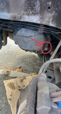

Hello, sorry to bring back an old thread. i was replacing my lower ball joint on my ds3 when i partially pulled the driveshaft out the gearbox spilling probably 300ml of oil. I was hoping you’d be able to help me with the grade of oil and then the best approach to either top it off or do a complete change. Thanks in advance

The oil grade is 75w-80.jamesp_03 wrote: 09 May 2022, 23:01 Hello, sorry to bring back an old thread. i was replacing my lower ball joint on my ds3 when i partially pulled the driveshaft out the gearbox spilling probably 300ml of oil. I was hoping you’d be able to help me with the grade of oil and then the best approach to either top it off or do a complete change. Thanks in advance
What engine is your DS3? Its either MA-5 as pictured above or BE4/R

Re: Changing transmission oil in Citroen C3 2011 1.4 HDI
Managed to figure it out, i used 75w80 gl4 like everyone seems to suggest. I did find the breather at the top but didn’t need to use it as i had a leveler hole making it far easier. My car is 2014 ds3 1.6hdi 90 5 speed. Attached is a picture of the position of the levelling hole. Just up and to the left from the nearside driveshaft. The drain plug is pretty self explanatory.
