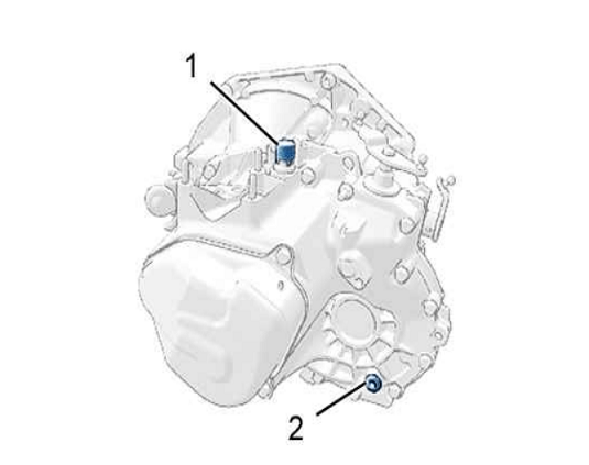

Hello guys, I am trying to change oil in my Citroen C3 2011 1.4 HDi but I am having trouble finding fill plug. If anyone can guide me through. Thanks in advance

One way to fill the gearbox is to go via the reverse switch hole. You will need to check how to make sure not to overfill the gearbox though.

Yes, I was wondering how to check if oil is filled to correct level

Be careful here. There is a specific quantity of oil in the system at factory. If replacing it you need to measure exactly, the amount you take out and replace it with the same quantity as it is a sealed unit. So it should not need topping up!
If you are going to replace the oil, then you need to ensure you drain it and measure the amount taken out. There is no 'topping it up'. If you put the wrong amount in you risk damaging the box.
Post your VIN for me and I can advise as to what the correct volume of oil should be for your specific engine, but it should be 2.1 Litres when empty (New - never filled) and 2 Litres if it has been filled and has then been drained. So 100 Ml of oil will be left in the gearbox after draining.

Hi, thanks for replying, VIN Number is VF7**************[VIN obfuscated, can be read by forum staff]. Do you know where is the fill port?

Ok, so confirmed the correct quantities as per my last post. The oil is filled via the vent plug below:
The air vent plug (1)
The drain cap (2)
Remember you may need to remove the lower torque reaction link (if necessary), the lower torque reaction rod support on the gearbox (if necessary) and the air filter casing to get access.
You MUST replace the oil with the exact quantity removed, unless fully draining, in which case it will be 2 litres. But always check against the amount that comes out and replace the same quantity, as long as there has been no leaks. If it has been leaking, then you'll need to drain and overhaul it anyway, replace the seals and then refill it.

What is the type and size of the socket for the drain plug on this? It looks like it has a square drive in the center of the bolt but I'm not sure what size it is.

It is a 8mm square

Hello, sorry to bring back an old thread. i was replacing my lower ball joint on my ds3 when i partially pulled the driveshaft out the gearbox spilling probably 300ml of oil. I was hoping you’d be able to help me with the grade of oil and then the best approach to either top it off or do a complete change. Thanks in advance

The oil grade is 75w-80.jamesp_03 wrote: ↑09 May 2022, 23:01 Hello, sorry to bring back an old thread. i was replacing my lower ball joint on my ds3 when i partially pulled the driveshaft out the gearbox spilling probably 300ml of oil. I was hoping you’d be able to help me with the grade of oil and then the best approach to either top it off or do a complete change. Thanks in advance
What engine is your DS3? Its either MA-5 as pictured above or BE4/R

Managed to figure it out, i used 75w80 gl4 like everyone seems to suggest. I did find the breather at the top but didn’t need to use it as i had a leveler hole making it far easier. My car is 2014 ds3 1.6hdi 90 5 speed. Attached is a picture of the position of the levelling hole. Just up and to the left from the nearside driveshaft. The drain plug is pretty self explanatory.
