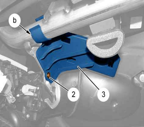

You'll need to remove the glove box and the Audio Head unit. There is a mounting case to protect the unit (it is linked to the airbag control unit so be careful). Remove the bolt (2).
Unclip and detach the independent telematic unit support (3) (at "b"). But also remove the Fascia emergency call and service button unit.

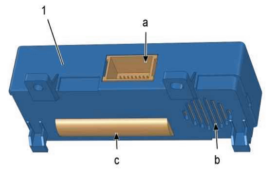

This is what the unit looks like:
This is the 18 way black connector
So the microphone enters this unit first of all via Pins 1 & 10 and exits through pins 2 & 11 to the connector at the back of the Head unit. But - as you didn't have the hands free kit or RD45, you'll need to trace back the wires from there on pins 2 & 11 to see where they exit.
