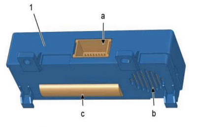

This is what the unit looks like:
This is the 18 way black connector
So the microphone enters this unit first of all via Pins 1 & 10 and exits through pins 2 & 11 to the connector at the back of the Head unit. But - as you didn't have the hands free kit or RD45, you'll need to trace back the wires from there on pins 2 & 11 to see where they exit.

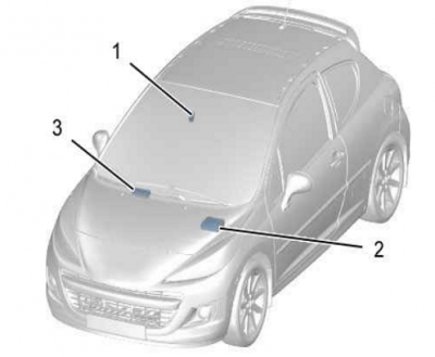

Here is the exploded part for the Hands Free Connections:
Here is the supposed location of the Hands Free Unit:
