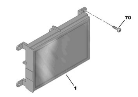

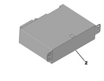

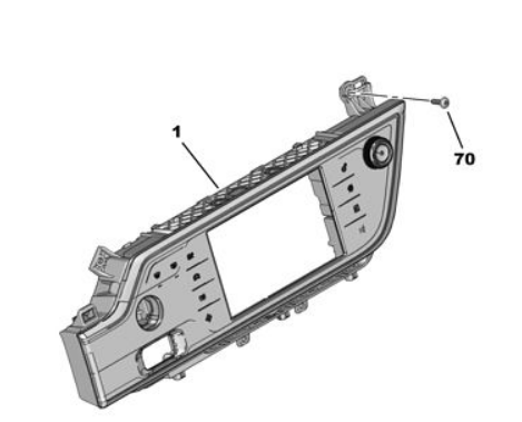

There are 3 parts to this system.
All Expensive! So what really needs to happen is a diagnostic to find out which of the units is potentially faulty. Replacing any one component will need coding to the vehicle and configuring using approprite diagnostic tools, so I highly recommend a diagnostic first.
| The Multifunction control panel (which is the surround of the screen with the buttons). | The actual multifunction screen itself. | This is the main Telematic Unit, which is hidden behind the dash. |
| 98011195XU (Seduction / Intensive Trim) £480.23 98011199VV (Exclusive Trim) £480.23 | 9812720580 £1020.53 | 1613353180 £1079.66 |

Now I can't be 100% certain, but I'm almost sure that these units can't be configured with Diagbox without a PSA server configuration which you won't have with this being a clone. You have the SMEG Digital Receiver and these generally require a connection to PSA servers to be configured as they are locked out, so do factor that in.

Hi all, I thought I would provide an update. Bought the LCD screen (part no 9812720580) on eBay (about £150) and it seems like the issue is sorted.
No coding necessary.
On the old LCD, I can clearly see discolouration on the edges, so I assume it had failed.
