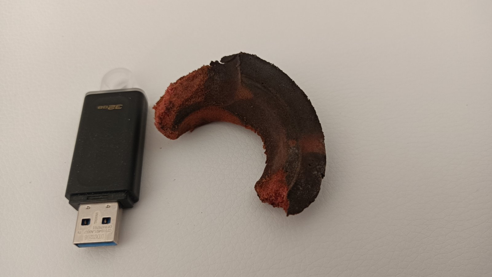

Well, I seem to have neglected this blog again. I did not get to the bottom of the water in the door, but it has been dry here. The car has been behaving itself, other than the tail light, documenter elsewhere.
For the past year or so there has been a clonk or rattle when going over a sharp ridge in the road surface, sounds like it comes from the left rear. I inspected the rear suspension a couple of times, but could not see anything unusual. I thought maybe it is the steel bracing straps which are fitted to the convertibles to prevent scuttle shake, they have several rubber buffers where they pass near ribs on the body shell, and one of those may be misplaced.
Anyway... Today I heard the same noise, but it seemed to come from the right hand rear. Then after returning home, I found the pictured piece of rubber bushing on the ground behind the right rear wheel.
I am confident that no other car has parked in that spot in the past 2 months.
Can anyone identify this (not the USB stick) as part of a 308?

Looks like the top half of the 3 to me Mike :-D

It equally looks like the bottom half of the 3, but it is made of quite soft (and now crumbly) sponge rubber, which was orange, but now has black dirt.
The hole in the middle was probably 25mm diameter before it deformed. Maybe it is half a bump stop? I need to check what they look like.

I would go bump stop. It looks to be the right colour and material.
