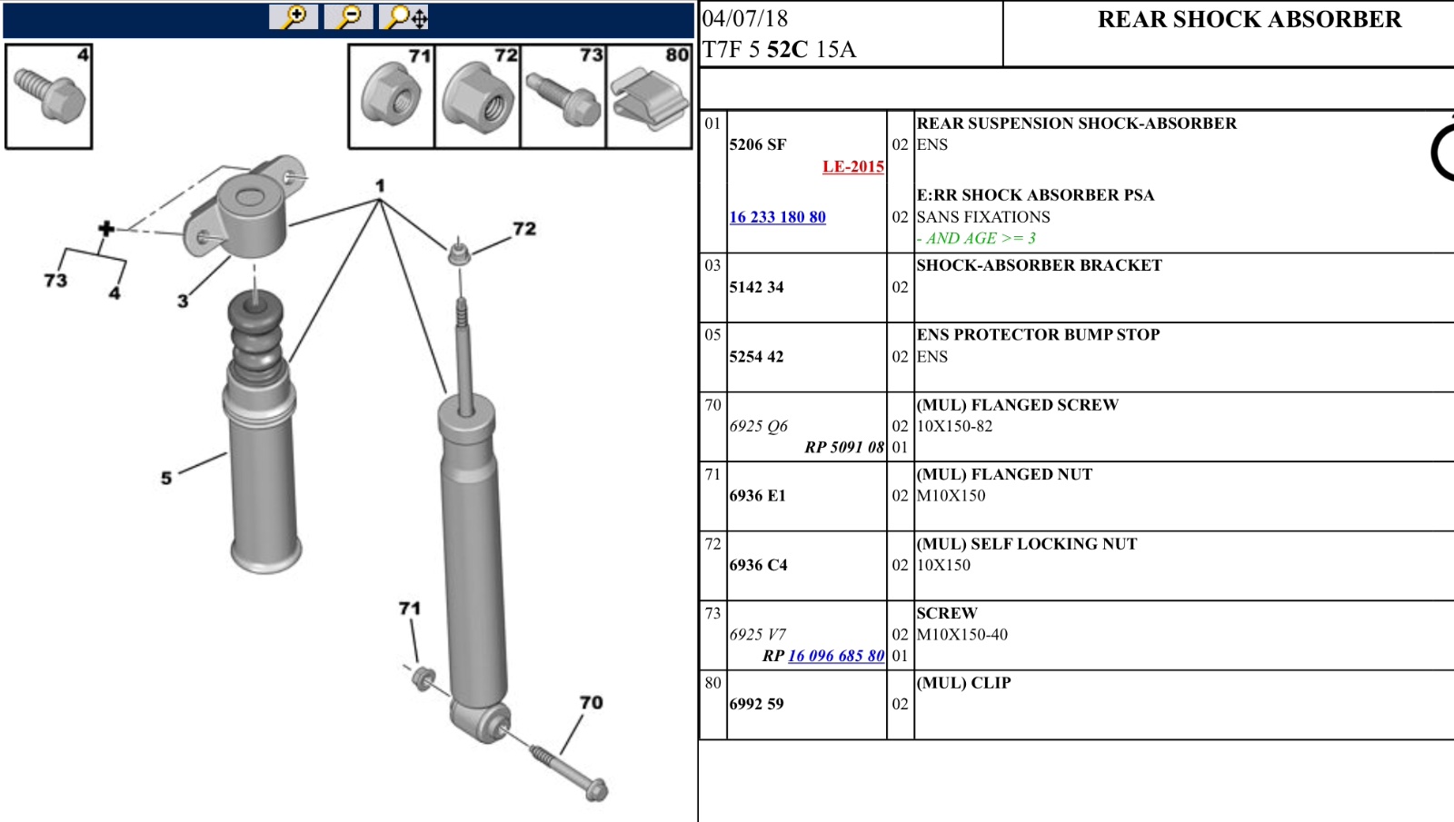

Unread post by RichardW »
I had a long standing knocking from the rear of my 307 which I couldn't find - until one day it gave itself away when the damper top mount fell apart as the alloy had corroded to dust. Subject to confirming the VIN, the 308 looks to use a very similar part, so it could well be that. The only way to confirm is to take the damper off (not hard) and have a look at the top mount.

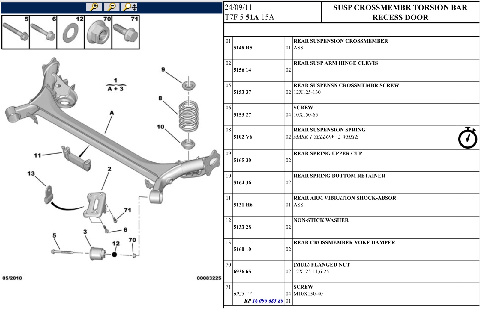

Re: 308 Knocking from nearside rear of car
Ok so you have the 308 COUPE CABRIOLET - 2 DOOR 1.6 THP 16v 150 Manual gearbox 6

Thanks Marc
Very helpful diagrams.
I’ll take a look at the weekend and see if anything is amiss.
GiveMeABreak wrote: 11 Sep 2018, 21:23 Ok so you have the 308 COUPE CABRIOLET - 2 DOOR 1.6 THP 16v 150 Manual gearbox 6
Yep, looks the same. Item 3 - it's got a rubberised bush inside, as the mount gets eaten away the bush starts to move about. One of mine the top of the mount disappeared completely allowing the damper shaft to flop and bang about really loudly! In theory, you can fit a new mount, but the nut on the top of the damper was just a rusty mess on mine, no way it was going to come apart; I just fitted a new damper complete from a breakers; you might not want to do that if you are worried about 10/10ths handling!!
