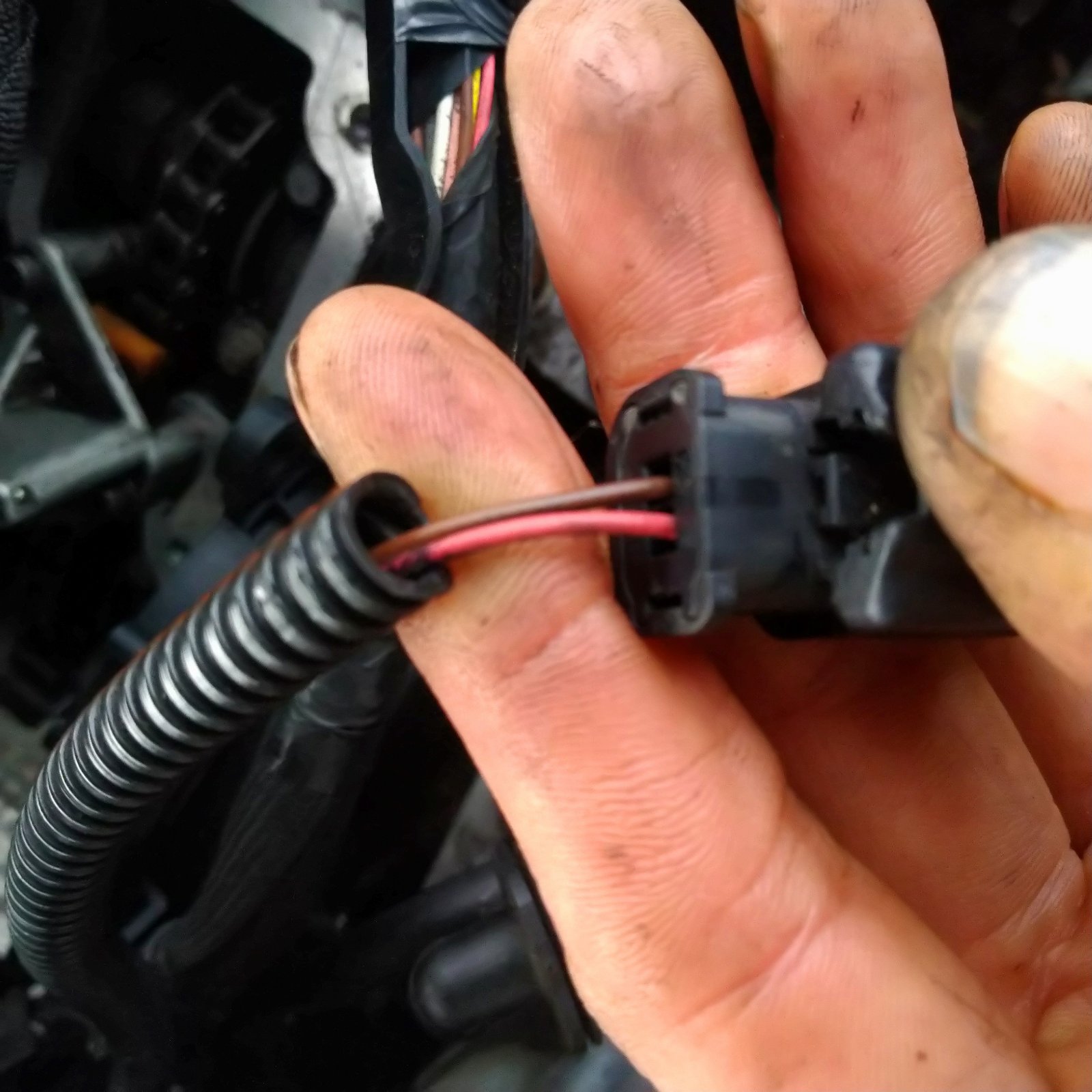

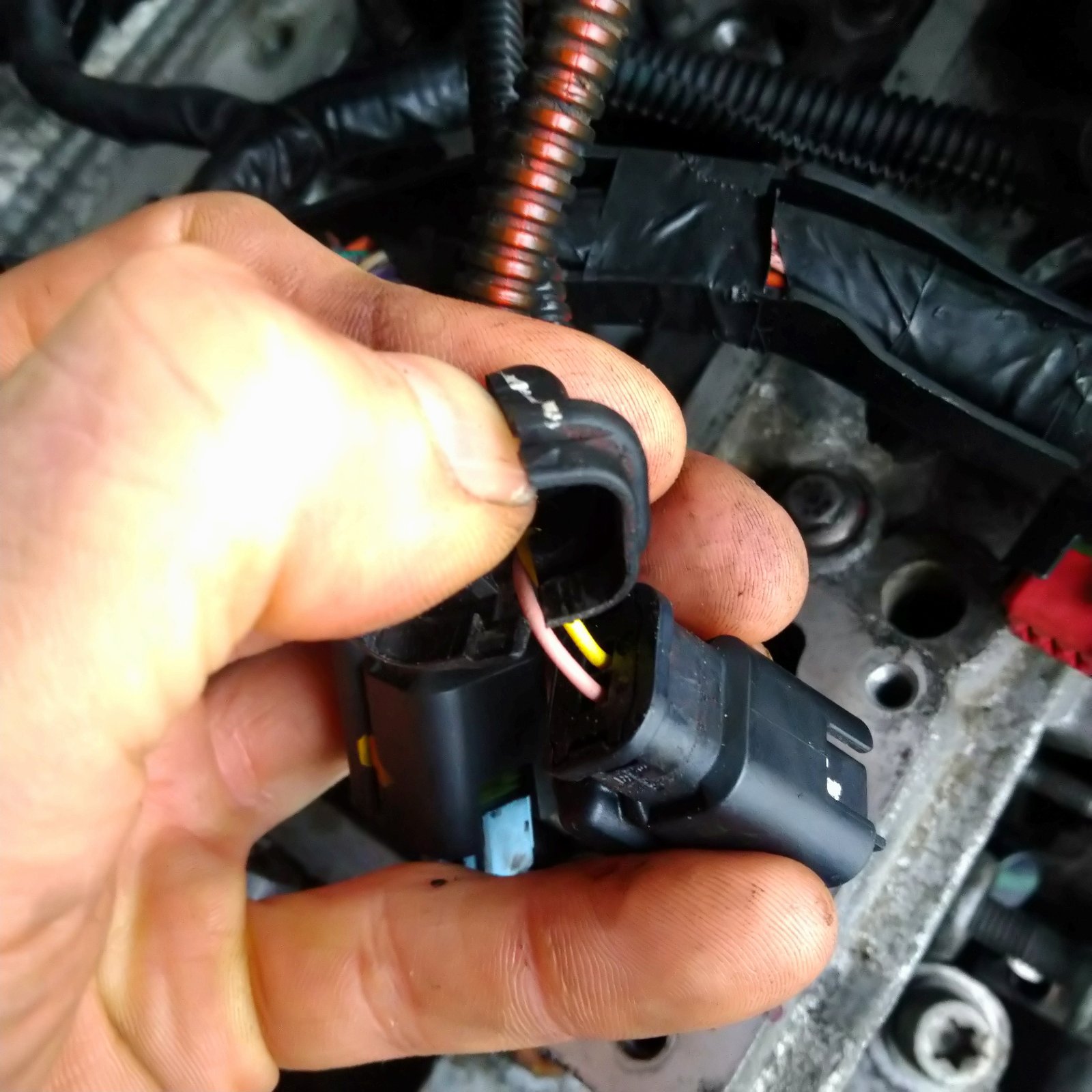

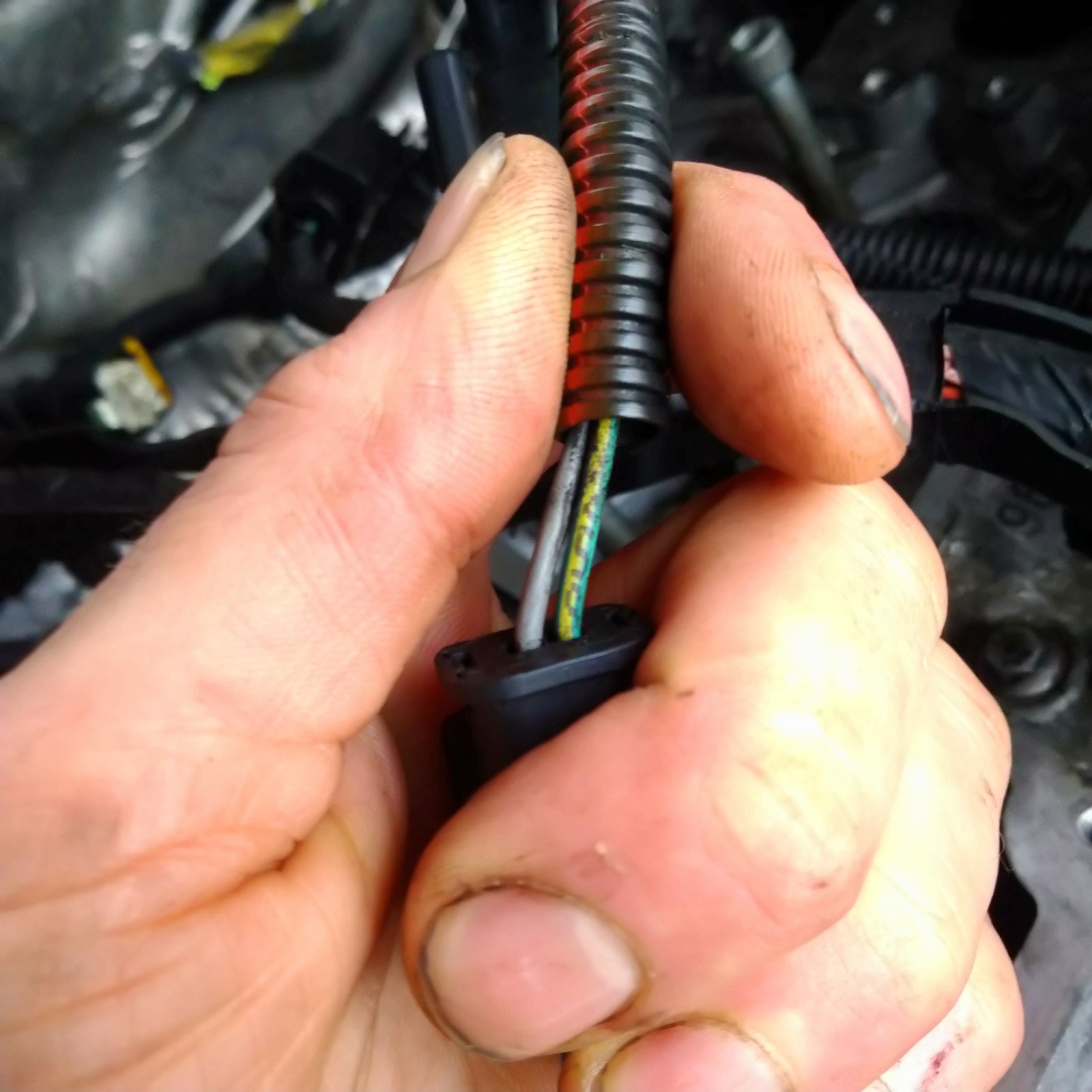

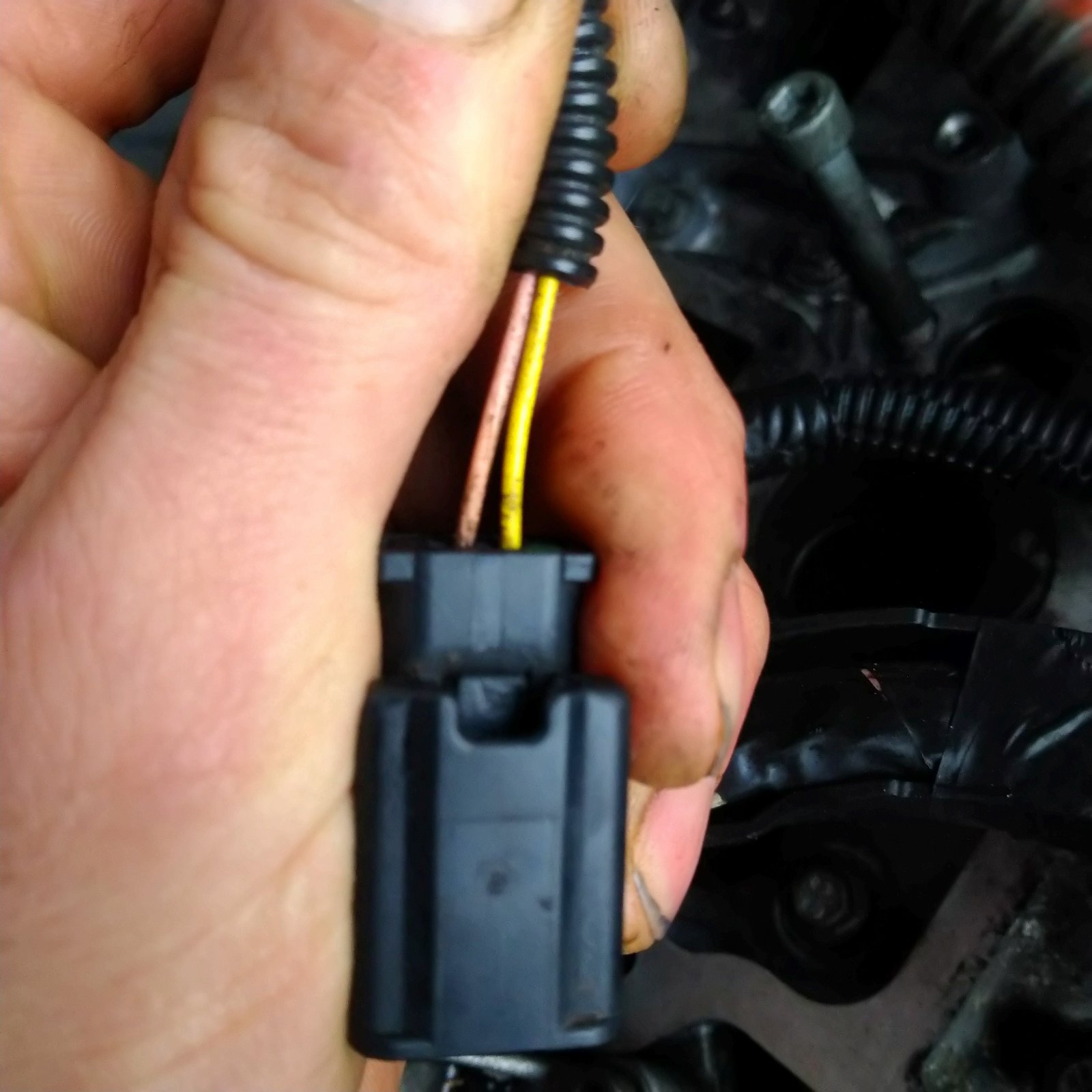

Citroen C5 X7 2012 tourer RHH engine wiring help needed, I had the intake manifold off and in my haste i didnt mark the solenoids that are mounted on the back of it. There are 3 solenoids on the back of the intake manifold but I dont know which order to plug them in as the plugs are all the same... I have four plugs and three solenoids. I dont recall which one was redundant.
Have searched high and low and cant find the info I need and I dont want to do trial and error!!
One is for the turbo, one is for the EGR and one is for the anti-shudder valve.
The plugs have the following wire colours going to them:
Yellow / Pink
Yellow / Pink
Grey / Green(Yellow) - this one has thicker wires than the rest.
Red/Brown - this is on a separate bit of the loom.
If anyone can shed some light on the situation i would be eternally grateful and more than happy to make a donation! And yes I will be clearly marking stuff like this when i take it apart in future!
Thanks, Douglas

Hello and thanks for the prompt and concise response, I did not know about the wiring codes. I have stripped the wires back as much as i can, cant find all the numbers but these are the ones i have:
1. Yellow / Pink............2212 - BCM2E / 2262 - 1472
2. Yellow / Pink............2235 - 1271 / 26C4 - BCM3F
3. Grey / Green(Y)........2526 - BCM1A / 259? - ????
4. Red / Brown.............2262 - 14A7 / ???? - BCM2B
So it looks like that the EGR is no.1. The turbocharged air heater electrovalve 1 is no.4? Is that the solenoid that controls the turbo actuator?? There are only three solenoids on the engine that I can see, all in a row on the back of the intake manifold.
Thanks so much for the help the cars been stranded for nearly six months now because of my error!!
Muchly appreciated
Muchly appreciated
