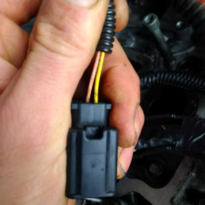

Citroen C5 X7 2012 tourer RHH engine wiring help needed, I had the intake manifold off and in my haste i didnt mark the solenoids that are mounted on the back of it. There are 3 solenoids on the back of the intake manifold but I dont know which order to plug them in as the plugs are all the same... I have four plugs and three solenoids. I dont recall which one was redundant.
Have searched high and low and cant find the info I need and I dont want to do trial and error!!
One is for the turbo, one is for the EGR and one is for the anti-shudder valve.
The plugs have the following wire colours going to them:
Yellow / Pink
Yellow / Pink
Grey / Green(Yellow) - this one has thicker wires than the rest.
Red/Brown - this is on a separate bit of the loom.
If anyone can shed some light on the situation i would be eternally grateful and more than happy to make a donation! And yes I will be clearly marking stuff like this when i take it apart in future!
Thanks, Douglas

Hello and thanks for the prompt and concise response, I did not know about the wiring codes. I have stripped the wires back as much as i can, cant find all the numbers but these are the ones i have:
1. Yellow / Pink............2212 - BCM2E / 2262 - 1472
2. Yellow / Pink............2235 - 1271 / 26C4 - BCM3F
3. Grey / Green(Y)........2526 - BCM1A / 259? - ????
4. Red / Brown.............2262 - 14A7 / ???? - BCM2B
So it looks like that the EGR is no.1. The turbocharged air heater electrovalve 1 is no.4? Is that the solenoid that controls the turbo actuator?? There are only three solenoids on the engine that I can see, all in a row on the back of the intake manifold.
Thanks so much for the help the cars been stranded for nearly six months now because of my error!!
Muchly appreciated
