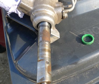

that seems like alot to swallow does the mod citroen made work on the steering rack the little green ring or does it just slow the inevitable. I have to say its the first time i have ever felt like i am being discouraged by such revered enthusiasts as yourselves. I might have to go to the dark side and drive a pug 407 or 508 if that is the case

it was the owners poll which drew my attention to specifically issues with the hydraulics which have always been citroens strong point that worried me. Has no one devised a cunning plan to prolong the steering rack?

I believe some members have also fitted a gaiter packed with CV grease. As I understand it, the problem is that water can puddle in a cavity and then the steel rusts. As I also said in my previous post, some companies who refurbish the racks chrome plate the pinion (at least, that is the part I believe was plated), provided it is not too far gone.

that would be the obvious part to plate really, good idea, I wonder is there a way I can inspect that shaft quickly when I am looking at a possible buy

The little green Fairy Liquid ring is a total joke.
That was the only 'modification' we are able to discern from the Citroen 'modified rack'.
You really need a boot over the pinion after greasing the pinion with some marine grade grease. The whole idea being to keep the water away from the pinion to stop it settling and leading to rusting of the shaft and then seal deformation and contamination of the inside and eventual oil leak. The boot should be open at the bottom to allow any water to run out of course.

The green ring doesn't really achieve anything !
It's one thing to protect a new or near new pinion shaft with grease, a rubber boot, Denso tape, or whatever other defences you can come up with, but if it's already rusted and wearing out the seal, then there's not a great deal you can do to 'un rust' it satisfactorily

I was thinking it didn't look very useful. Judging by some of the pics of the shafts its important to check the rack before buying I think
. Is there any way to get a quick visual on the shaft when buying one. I carry 4 adults regularly and I want to tow a 9' x 4' trailer every once in a while so I think I will need the wet suspension by the sounds of things.
