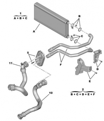

The original matrix part number was 1609730580, but this has been replaced with a new part: 9821299980, so I would use the later part number. The latest part number is currently priced at £182.63 inc. VAT direct from Citroen for a genuine OEM one. This is for item (1) on the diagram, which also includes the fittings 'B' & 'C'.
Thanks for your donation.

Re: C4 Grand Picasso 2015 (B78) Heater matrix part no
Can someone tel me the part numbers for the heater pipes on this model please,new to site
Lutino13
- Posts: 3
- Joined: 17 Jan 2025, 10:22
Looking for part no of the 2 heater pipes,from thermostat to heater matrix,
