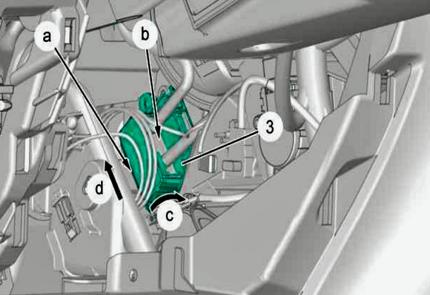

Re: DS4 Heater blowers fault
Ok, so here is the fault descriptor. As it is working intermittently, I would think it unlikely to be the fuse, so I would focus on the Blower Control Module which is the most common issue. These step up or down the current as required, but do become defunct as they age.
Fault Code: B131C 01
Description of Fault: Passenger compartment air blower fault. A part of the line is in open circuit or in short-circuit to the plus.
- Air blower motor
- Control
- Earth
- Copy
- Supply
- Blower control module
The blower control is compared to the motor copy voltage
Confirmation of the fault after 5 or 12 seconds depending on the type of fault
Fault detectable at 100% for a blower setting from the BSI of between 30% and 70%.
Conditions for Fault to clear: Disappearance of the fault
Downgrade Modes whilst Fault is active: Depending on the type of problem, the operation may be either retained or interrupted
Symptoms: Malfunctioning of the production of cold air
Malfunctioning of the production of warm air
Malfunctioning of regulation of the temperature requested
Malfunctioning of the blowers
Malfunction of the windscreen demisting/de-icing
Suspect Areas: Electrical harnesses
Electrical supplies protection and management unit (BPGA) fuse F10
Air blower motor
Earth point MC46
Air conditioning ECU
Supplies protection and management unit (BPGA)
Disconnect the connector ( as "b").
Unlock the blower control module (3) ( as "a").
Slide the blower control module (3) (At "d").
Pivot the blower control module (3) (At "c").
Remove the blower control module (3).

thanks for the info. i will get the part ordered and try and locate it.
