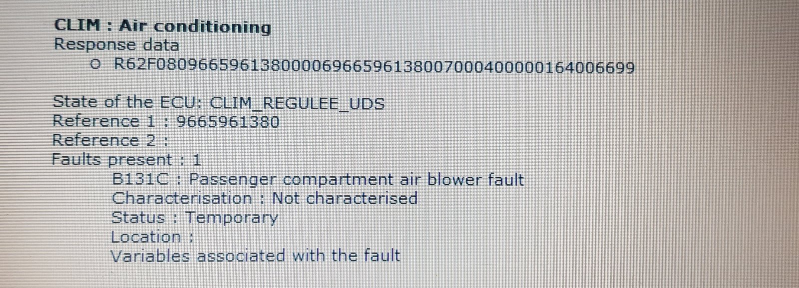

sorry for the slow reply was away with work. the VIN is VF7**************[VIN obfuscated, can be read by forum staff] the pic below is what I'm getting on the laptop. hopefully this will help narrow down the fault.

Ok, so here is the fault descriptor. As it is working intermittently, I would think it unlikely to be the fuse, so I would focus on the Blower Control Module which is the most common issue. These step up or down the current as required, but do become defunct as they age.
Disconnect the connector ( as "b").
Unlock the blower control module (3) ( as "a").
Slide the blower control module (3) (At "d").
Pivot the blower control module (3) (At "c").
Remove the blower control module (3).
Fault Code: B131C 01 Description of Fault: Passenger compartment air blower fault. A part of the line is in open circuit or in short-circuit to the plus. - Air blower motor - Control - Earth - Copy - Supply - Blower control module The blower control is compared to the motor copy voltage Confirmation of the fault after 5 or 12 seconds depending on the type of fault Fault detectable at 100% for a blower setting from the BSI of between 30% and 70%. Conditions for Fault to clear: Disappearance of the fault Downgrade Modes whilst Fault is active: Depending on the type of problem, the operation may be either retained or interrupted Symptoms: Malfunctioning of the production of cold air Malfunctioning of the production of warm air Malfunctioning of regulation of the temperature requested Malfunctioning of the blowers Malfunction of the windscreen demisting/de-icing Suspect Areas: Electrical harnesses Electrical supplies protection and management unit (BPGA) fuse F10 Air blower motor Earth point MC46 Air conditioning ECU Supplies protection and management unit (BPGA) |
