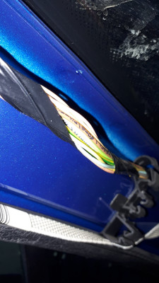

Ok guys, i have installed RD45 and display v72. I activated all functions in diagbox and music streaming works. The last thing i need is the microphone. As i mentioned in my first post in this topic; i have bought and already installed genuine mic in the roof lamp.
But i cannot locate where the harness cable is end-up. I disassembled the plastic of the A-pillar and this is what i see:
May i please the schema of harness electricity on peugeot 207? Some screenshots like these:
I need to know where this harness is ending in my car, because i had it factory fitted (without micro itself) Help!
