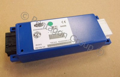

Re: Flashing mileage with no Bluetooth
Hi Marc
Do you know, does the part in question look like the attached?
Thanks
Mark
Thanks
Mark
- GiveMeABreak
- Posts: 37333
- Location: West Wales
C5 MK I 2.0 HDi SX Wicked Red
C15 Romahome White
XM 2.0 SX Polar White
CX 20 Polar White
GS 1220 Geranium Red
GS 1000 Cedreat Yellow - x 5722
The telephone interface module does look similar to that - but it must be the correct part number to be compatible (hardware / software) and may need configuring with a suitable diagnostic tool (like Diagbox with an S1279 interface) if you are thinking of replacing it yourself - but I can't confirm this.
