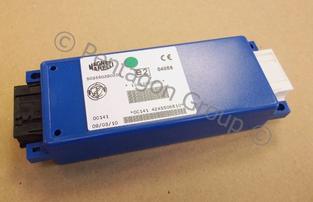

Hi Marc
Do you know, does the part in question look like the attached?
Thanks
Mark
Thanks
Mark
- x 6960
Re: Flashing mileage with no Bluetooth
The telephone interface module does look similar to that - but it must be the correct part number to be compatible (hardware / software) and may need configuring with a suitable diagnostic tool (like Diagbox with an S1279 interface) if you are thinking of replacing it yourself - but I can't confirm this.
