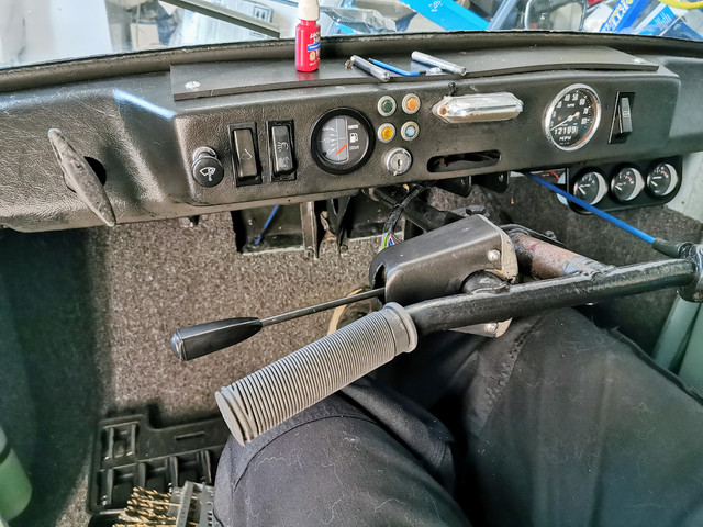

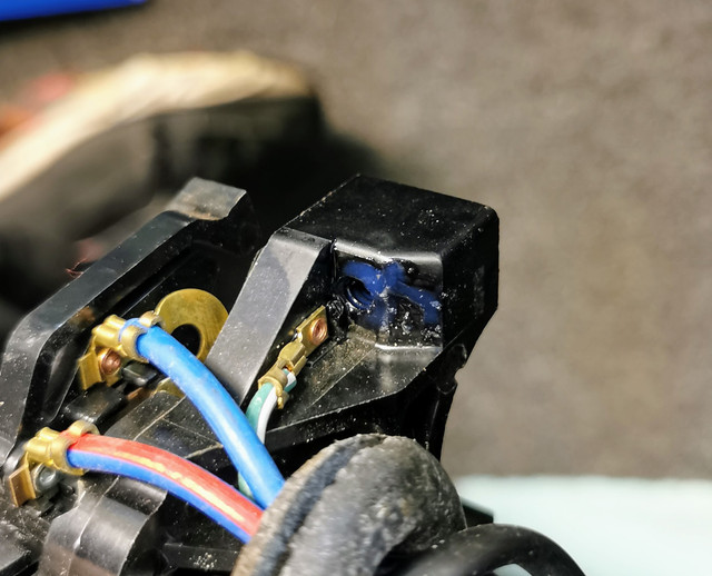

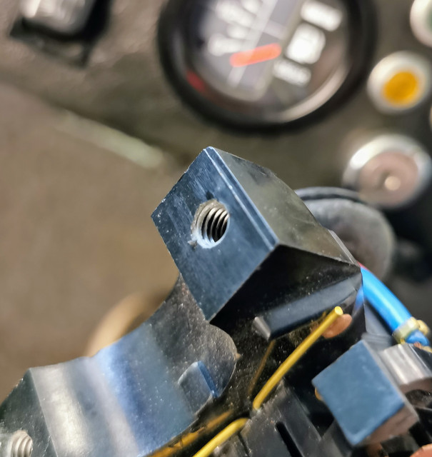

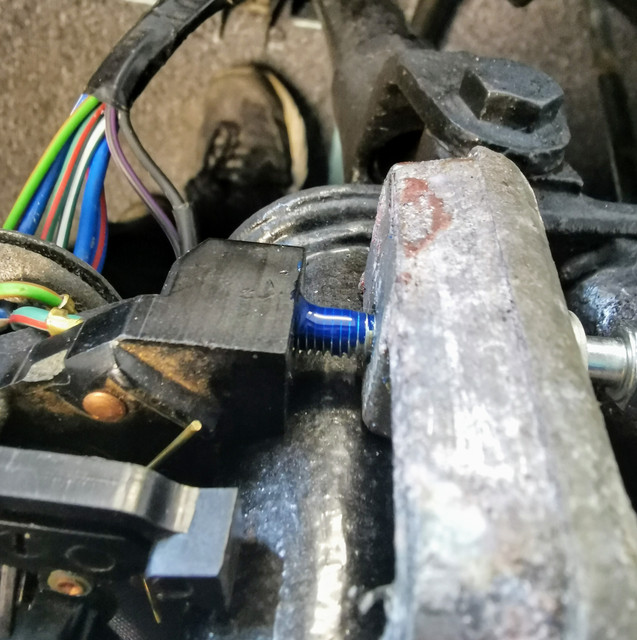

The run out yesterday went largely to plan but was marred slightly by the indicator stalk making a bid for freedom shortly before I got home. The stock mounting arrangement for this is at best "flimsy" thanks to it relying on two self tapping screws fastened into the plastic of the stalk assembly (bakelite?).
Using a nut and bolt isn't really an option due to the proximity of the terminals for the indicator switched circuits to the hole in the body where the fastener lives.
If you find a bolt with a really shallow head you might just about be able to get away with it, just. Nothing I have in stock is small enough though.

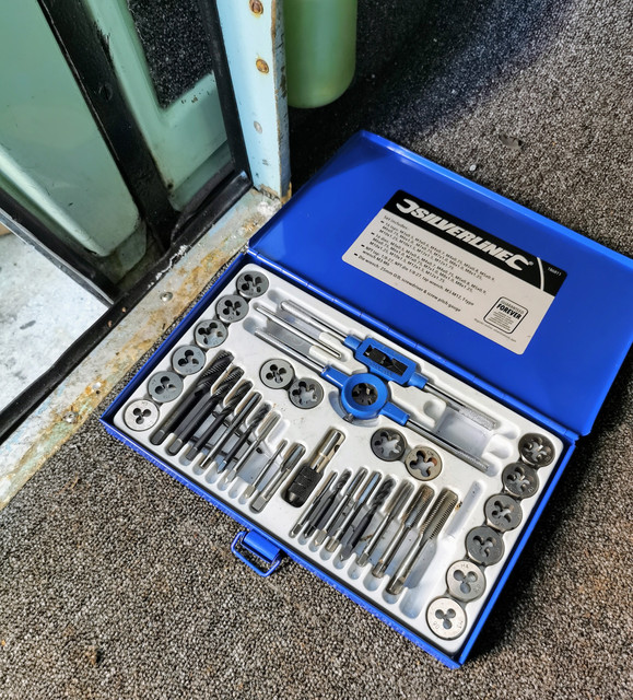

I've a couple of ideas in mind, but the first one I wanted to try was tried today...Drill the holes out, tap them properly and stick a bolt of a carefully measured length in.
Step one...drill out and tap the holes.
Result was a nice clean thread.
I went with a standard M6 thread as I had fasteners that size in stock, and it seemed a decent step up but without risking taking too much meat out of the assembly I was trying to secure. Also was the biggest I could get away without having to also drill out the holes in the metal back plate.
A healthy dose of thread lock was added before bolting things together.

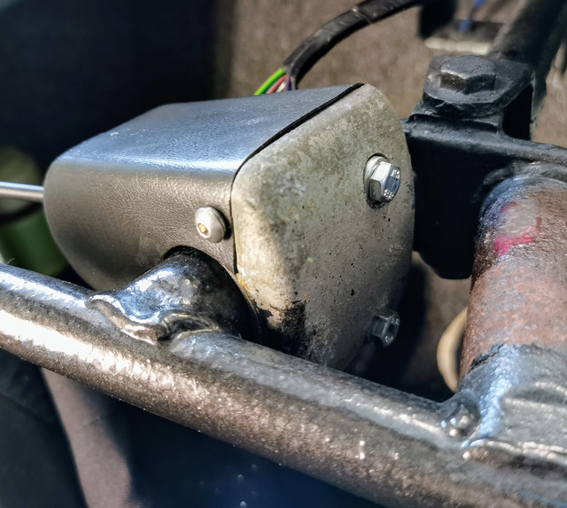

I took the opportunity to tap out the holes in the backing plate that the plastic cover attaches too so I could get that securely fixed and get rid of two rusty fasteners.
Much better.
Washers were fitted there to both keep the end of the bolt where I wanted it (precisely level with the end of the threaded hole) and to allow me to actually tighten things up without the bolts disappearing into the recessed hole in the backplate.
Really need to get some paint and touch in the space where this switch used to live.
Likewise I need to get a bit more loom tape in and extend the covering on the loom to the stalk the last few inches to the back of the switch.
Nice to be rid of a couple more of the list of rusty fasteners in the cabin too.
Historically the baseplate always wobbled around a bit when the switch was used. Reckon this is why it was able to work loose over time. It now seems to be rather more solid from the looks of things.
Hopefully this will stay put this time. If not I've got a few more ideas up my sleeve...but they're rather more of a bodge. whereas I feel that this is more just an improvement on the original setup. I need to pick up more dog food tomorrow so will probably take her out to carry out that trip unless the weather is horrible so we can see if it works then.

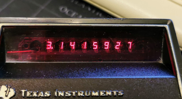

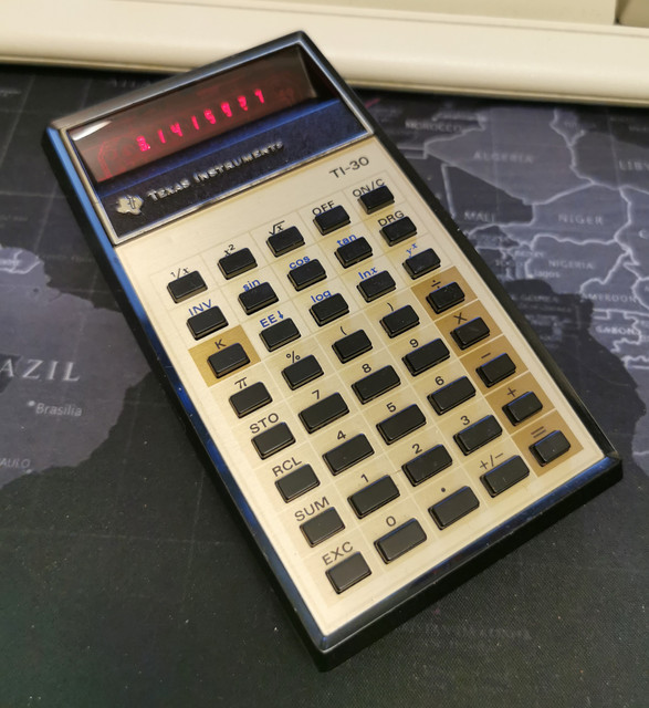

The appearance of the TI-30 calculator a while ago sparked a bit of discussion in a few places. This one...
Got to love a classic LED display.
Just a shame the camera can't capture the colour properly.
I used to collect a few things like this years ago, but it's been a good 15 years since I really looked at things like this, and I gave quite a lot of them away a while ago...however following the conversation I got thinking about it again...and ended up rummaging around eBay. This arrived this morning.
This cost me a whopping...£0.99 and £5 postage. There was another mid 90s Casio one in the package too but that's a pretty generic example. If anyone's interested I'll snap a couple of photos. However it was this one that caught my eye. I've not been able to find a date on it anywhere, but from the styling, weight and fact that it's a full 15mm thick makes me think very late 80s. Oh...and the ZX-80/81 style membrane keyboard too.
Yes, it is *precisely* as awful to try to type on as the aforementioned Sinclair products!

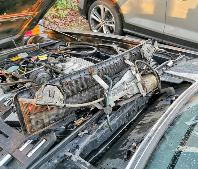

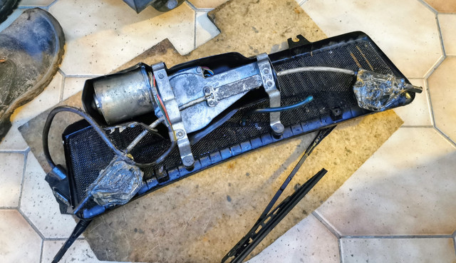

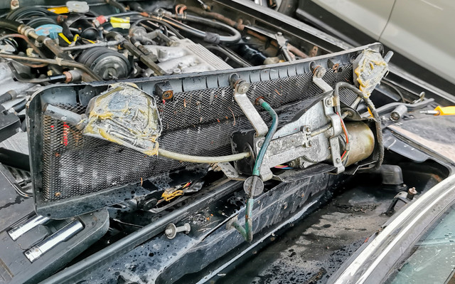

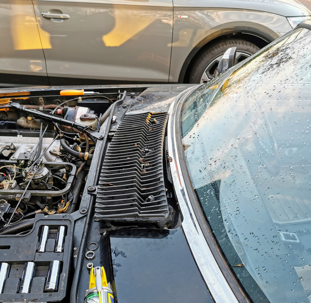

The windscreen wipers on the Jag have been becoming increasingly glitchy of late. Normally a sharp thump on the scuttle would get them working again - until last time I needed to go out in a hurry when they decided to play dead entirely. The behaviour seemed to suggest the motor wasn't making it quite all the way to the fully parked position (which is slightly further over the screen than the normal wiping range).
Given I knew the drains had been clogged for goodness knows how long the motor had most likely spent some time under water so I was hoping it was going to be a simple case of dirty contacts or dried up grease in the linkage.
Figured it was worth pulling the grill over it off and seeing if I could see anything obviously amiss. Looked like it would be a simple case of pulling the wiper arms, undoing a couple of bolts and lifting it off...right?
Of course not, because Jaguar. Having unfastened everything I could see it still wasn't interested in budging more than a few millimetres.
Peering under the edge it became obvious there was a load of hardware attached to the underside, with no obvious way to detach it. Attempting to get a wrench into the bolt only resulted in me dropping it into the void under the grill.
Eventually I figured out that the whole wiper assembly remains attached to the cover and you just have to sort of wrestle it out through the not-quite-wide-enough gap.
Those spindle gear boxes look suspiciously like the same ones used in the Invacar...given the amount of BMC parts bin hardware in there it wouldn't surprise me.
Nothing hugely obvious amiss, though the whole drive assembly and spindles were really dry. So everything was drowned in penetrating oil and I then splodged as much grease as I could be hand into the spindle boxes (pretty easy as they're not sealed) without pulling things to bits any further as I was being mindful of having to go out pretty soon to collect groceries.
I'm under no illusions that I won't be back in here, most likely I'll need to dismantle the motor gearbox itself to give it a thorough clean and re-grease as the original lubrication has probably long since turned to plastic. As it is though the wipers now move at about twice the original speed and appear to be playing ball...the issue has been intermittent though so only time will tell.

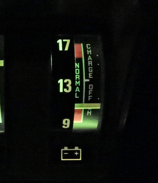

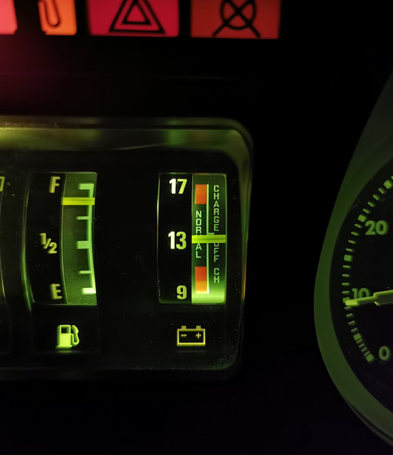

Stopping at the first junction after that I noticed the dash lighting seemed really dim.
Um...yeah, that would do it.
The alternator appears to have lost interest in charging. I legged it home and switched cars. Further investigation revealed no working ignition light either...so either bulb has gone or we've got an issue with the brushes most likely.
Of course when I went back to the car half an hour later to park it it behaved perfectly again.
Yep...sticky and/or worn brushes methinks.

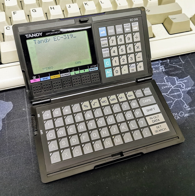

I did finally get a bit of time to start putting the basic text for a website update together (first time since 2017!), got a ways to go but have made a start at least. Decided to use something lacking in distractions to assist in concentrating on what I was actually working on.
Really do like the keyboard on this too. It's definitely physically the same board that Acorn used in the Archimedes range (A3000/3010/3020 at least), which was always my favourite to type on of the machines from that era. Amiga wasn't bad...Atari ST came miles behind with their horrible mushy mess. Funky shaped function keys couldn't even redeem it. No idea when I'll actually get the update finished and uploaded, but at least I've made a start.

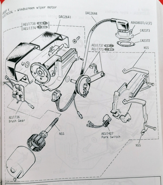

So, have I fixed the issue with the Jag's wipers? Nope...Worked perfectly until I turned the wipers off for the first time, then refused to start again until I thumped it again.
Fine. We'll pull the wiper motor apart, clean and generally service it then. My money is on it just being a dirty or sticky switch/brush. Given that the wipers work absolutely perfectly once they're started without any juddering or lack of torque I reckon it's a simple dodgy contact.
The plus side is that with the removal of four bolts (well, three in my case as one is sheared), removal of one plug and pulling off the washer feed tube the whole assembly just lifts off the car. So I've brought it into the house so I can work on it tomorrow inside when it's forecast to be tipping it down all day.
Parts manual is already coming in handy with a nice diagram showing what to expect when I start stripping it down.
Hopefully shouldn't be a major headache to sort. At least it will give me the opportunity to *properly* clean up and regrease things rather than the slap-dash job I did yesterday.

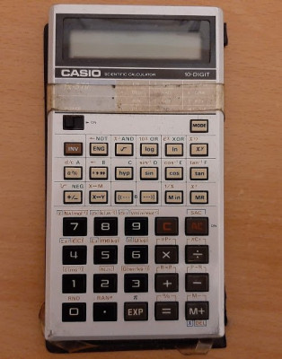

The calculator thing has definitely snowballed again. This little bundle was bought a few days ago and is on the way.
This was mainly for the Sharp one as it's a style I've not seen before. Though the TI-1250 is a nice addition as I've already for a TI-1200 (same thing but sans memory functions), and the Casio LC-828 will be a nice companion for my really battered LC-826.

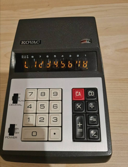

In addition I also just bought this off eBay.
That will be the first one in the collection to use a neon display which will be a nice box to get ticked off.
We do have a fault with the display whereby the top segment in all the digits is missing...Hoping this will just be a duff transistor (given the display will almost certainly be multiplexed that would make sense to me). Based on a little research I believe that this is a Kovac K-80D, dating from 1972 it looks like. Should be an interesting little addition to the collection - and actually a bit nice to have a fault to hunt down. Probably the only reason it went for less than £15, anything with a more exotic display than a VFD tends do be quite pricey.

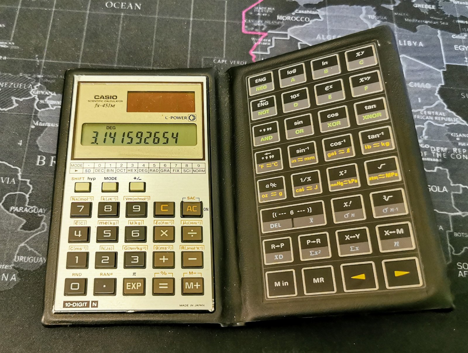

A pretty close relative of my fx-451M I imagine.
Which also has binary, hex and octal modes. Saved my sanity on more than one occasion at college. Earned me dirty looks from several classmates who had newer and shinier calculators which had half the functionality.
