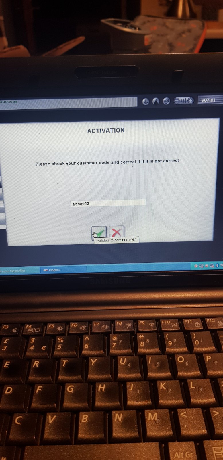

Ive recently picked up a netbook, with windose XP on it.. Im trying to installl Diagbox from Easy Diagnostic .. it unpacks installs then when it comes to Customer name Im told to enter easy123 .. which I do, I then get a screen for activation with PC Identifeir and name info but in the box below it says NO CODE NEEDED.. so I assume I need to install as manual mode..
Has anyone else used Easy Diagnostic, or has anyone another customer name I can use etc..

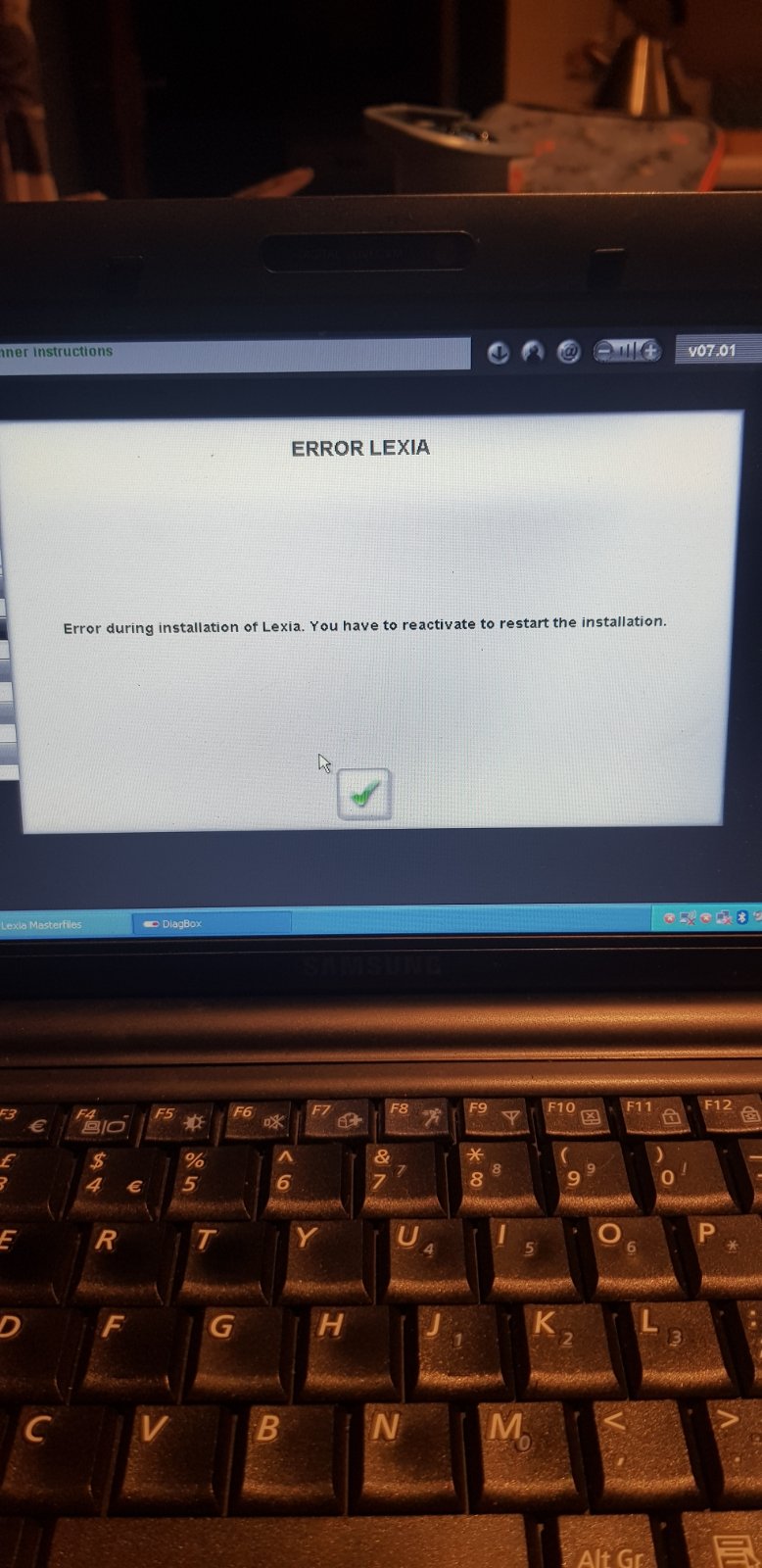

After the Identifier box I then get an error in installation, start again..

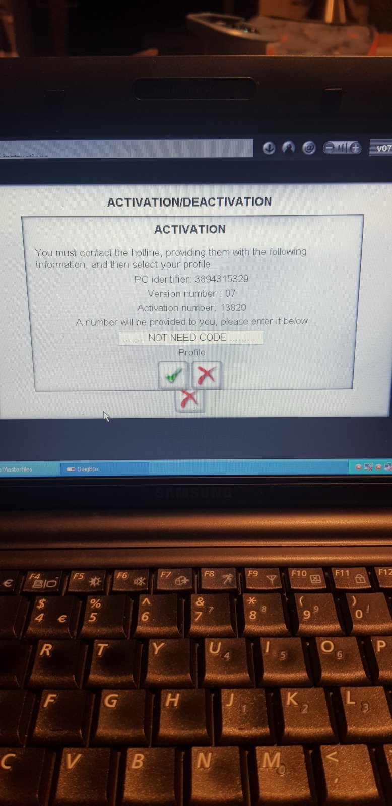

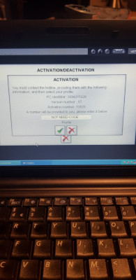

So.. these are the pictures of the sequence I get..
I assume I need to generate an activation code for this.. however the instructions I got dont tell me this..

You are not getting the same screen, so can you confirm that you have 1) Enabled your WiFi / network card and 2) made sure you have NO active internet connection before you started the installation?
So you must activate your network card (have it switched on or not disabled during installation) - but just make sure you have disconnected from any activated WiFi connections so it can't connect to the internet.
It needs your network card to be enabled in order to generate a profile that is based on your laptop hardware and it uses the network card to do this.
Now though, you will have to uninstall the lot and start from scratch AFTER you have used Diagbox cleaner to fully uninstall and clean up all the files - or it will not work if you try and just reinstall it again over the old installation.

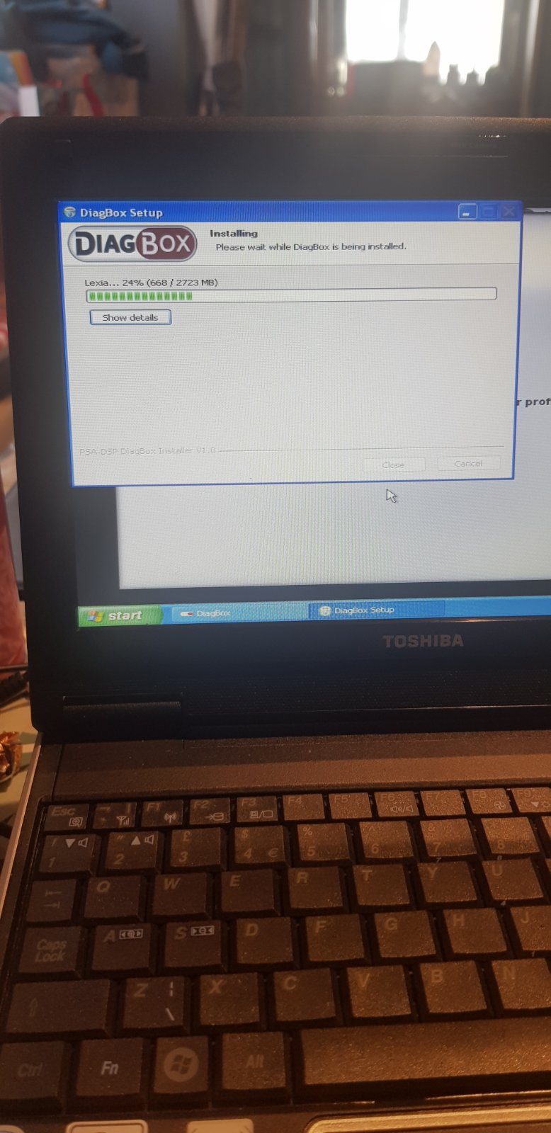

Well ffs ... I'm pleased to say it was the netbook at fault.. using this toshiba and it's now working and installing the full files.
Sorry for the hassles yesterday..
Ill update this again once I know I'm up and running fully but I'm further ahead then I was yesterday..
Its xp.. and dedicated for diagnostic so I'm not too worried about antivirus..
