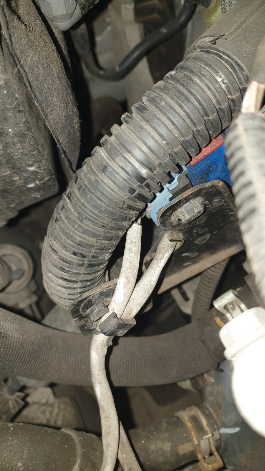

Jack's arriving today. I'm going to get those lambda sensors out today! I was examining the top one last night & found it clipped at multiple places, not sure where the connector ends but will see. A few pics below;

Re: Lambda Sensors on C5
Lambda Sensor won't come out! Not a flinch! Grrrr
. I even tried to disconnect it first but still wouldn't disconnect from the female chassis. I'll try again this weekend.
It is anticlockwise isn't it?

Re: Could I possibly DIY 🤔 all brake pads on my C5?
Try tightening it slightly first. If there is rust on the threads trying to undo the sensor will just cause the rust to act like a wedge and bind. Tightening it first can cause the rust to fall away, so it then does not wedge.

Top sensor done. Bottom one erm
...hopefully today. I'll try the pads this weekend too. Been so busy with work.
