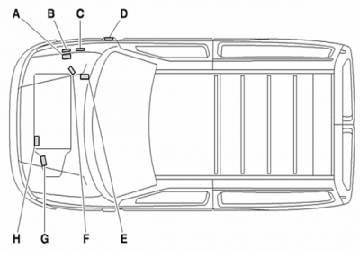

Regarding your VIN, this should help you identify the various plates. (A) should provide the VIN.
(A): Chassis stamp (cold stamp on the bodywork).
(B): Vehicle manufacturer’s plate.
(C): Additional plate.
(D): Rating label.
(E): Paint colour code.
(F): Build code (DAM).
(G): Gearbox reference - production serial number.
(H): Engine legislative type - production serial number.

If D is a sticker on the door pillar, then my one also has the VIN, RPO, and paint code.
Intriguing that your diag does not include a windscreen VIN number - maybe my car isn't alone after all.
