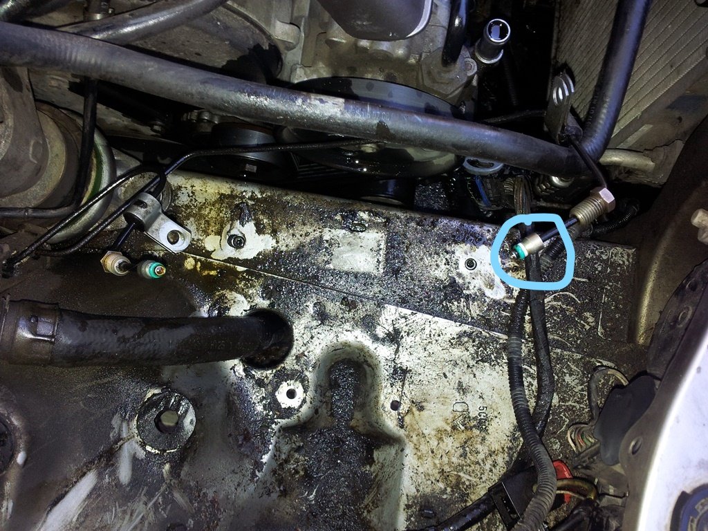

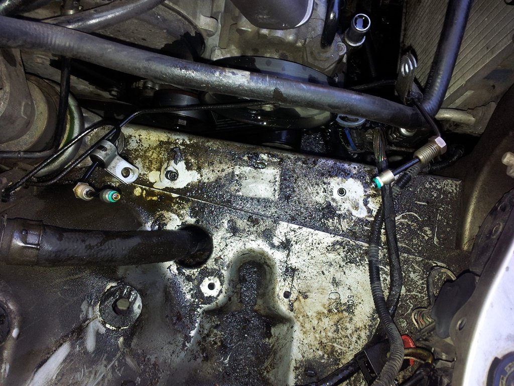

I've found a photo of the HP pump fittings. see below,
Do not think there are available anywhere.
Kenny

Re: Burst suspension pipe at rear
Yeah, I'm not sure what the fittings are on the HP pipes to be honest.
the size of the seals you need should be on Servicebox. I didn't replace mine when I had to remove my pump to recondition it.
Regarding the ruptured pipe, do you think it could be repaired in the same way as a brake line? The 4.8mm you measured seems very close to 3/16" so maybe a kit for brake line repairs would work?
